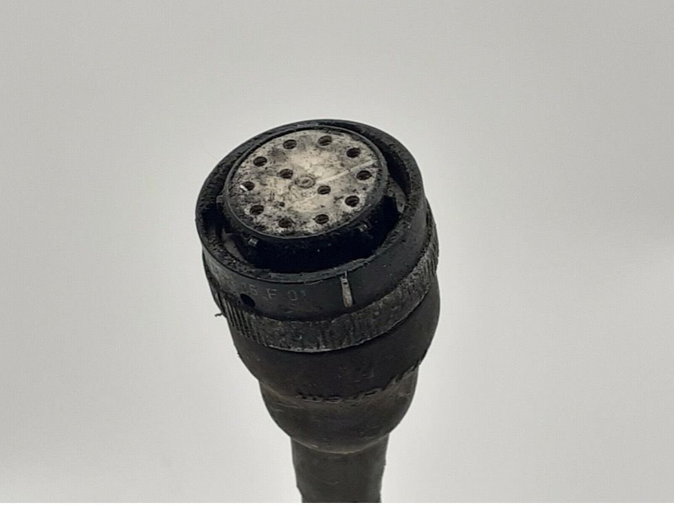

The other transmission used on the normally aspirated model is German ZF brand . It has referred to as a Duetsch ( SP ? ) plug that first must be pushed aft about 1 / 8 inch to unlock and only then turn
You can put tie wraps on the connector barrel to turn as it has little clearance for a set of connector pliers

This pic is from a ZF transmission on the control connector

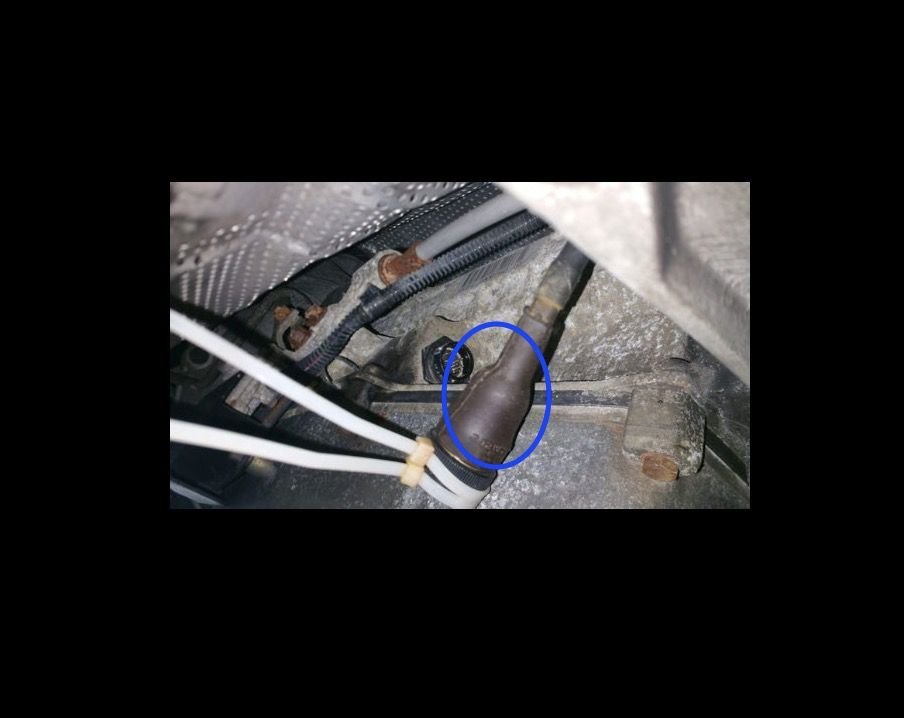

Maybe stupid question but how important is the protective rubber Housing around the plug as mine was cut away but never replaced and or covered again? Made for very easy fault finding though as otherwise would have been hidden .., (pls see picture attached).
Do you maybe know where I could find such an plug if needed?
It seems there is plenty of slack in the wiring harness so not sure why some of the wires looks so frayed?
