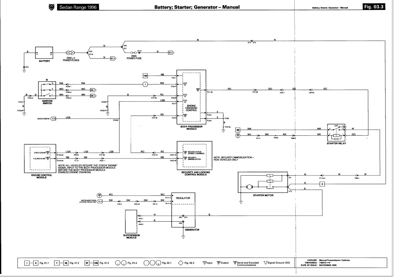

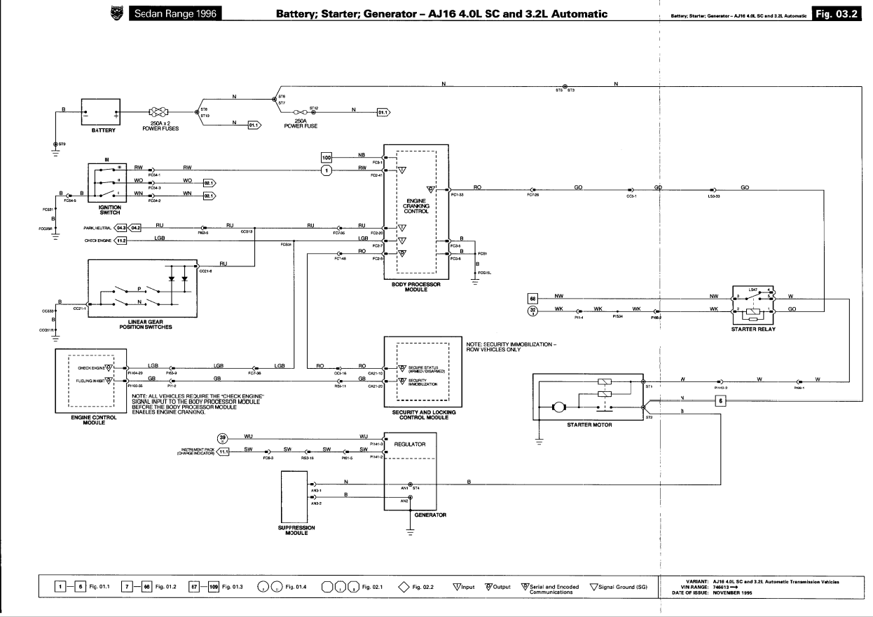

The wires in the J-gate with that tell the transmission which gear it is. Those are the ones that the ECU needs. The ECU only needs to know if the car is in park/neutral. Then it will let you crank her up. Please see the attached wiring diagram. If you look at the automatic wiring diagram, you see where the "linear gear position" bit is? Now compare that with the manual wiring diagram. See how that pin is grounded? So what you have to do is take the park/neutral wires and sort them. And sort out the neutral wiring too. It sounds confusing but they are all located in the same location an once you look at the plug, you will understand what to do
