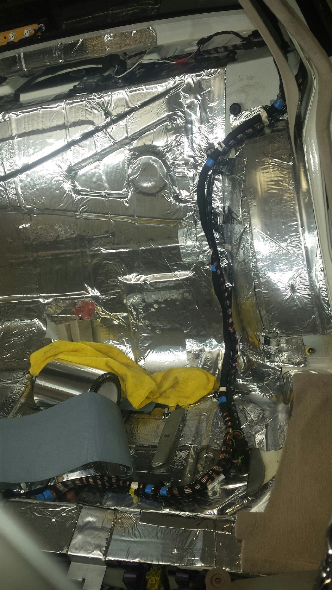

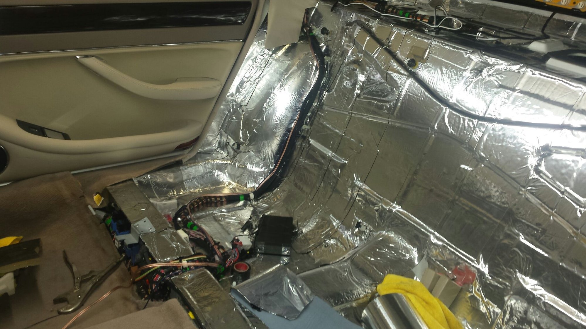

I also put flashing tape down on the metal. This controls temperature changes, reduces NVH (noise vibration harshness) and is still cheap and light. It's not Dynamat dense yet it does make a difference and is worth the time when you have the car take apart already.
