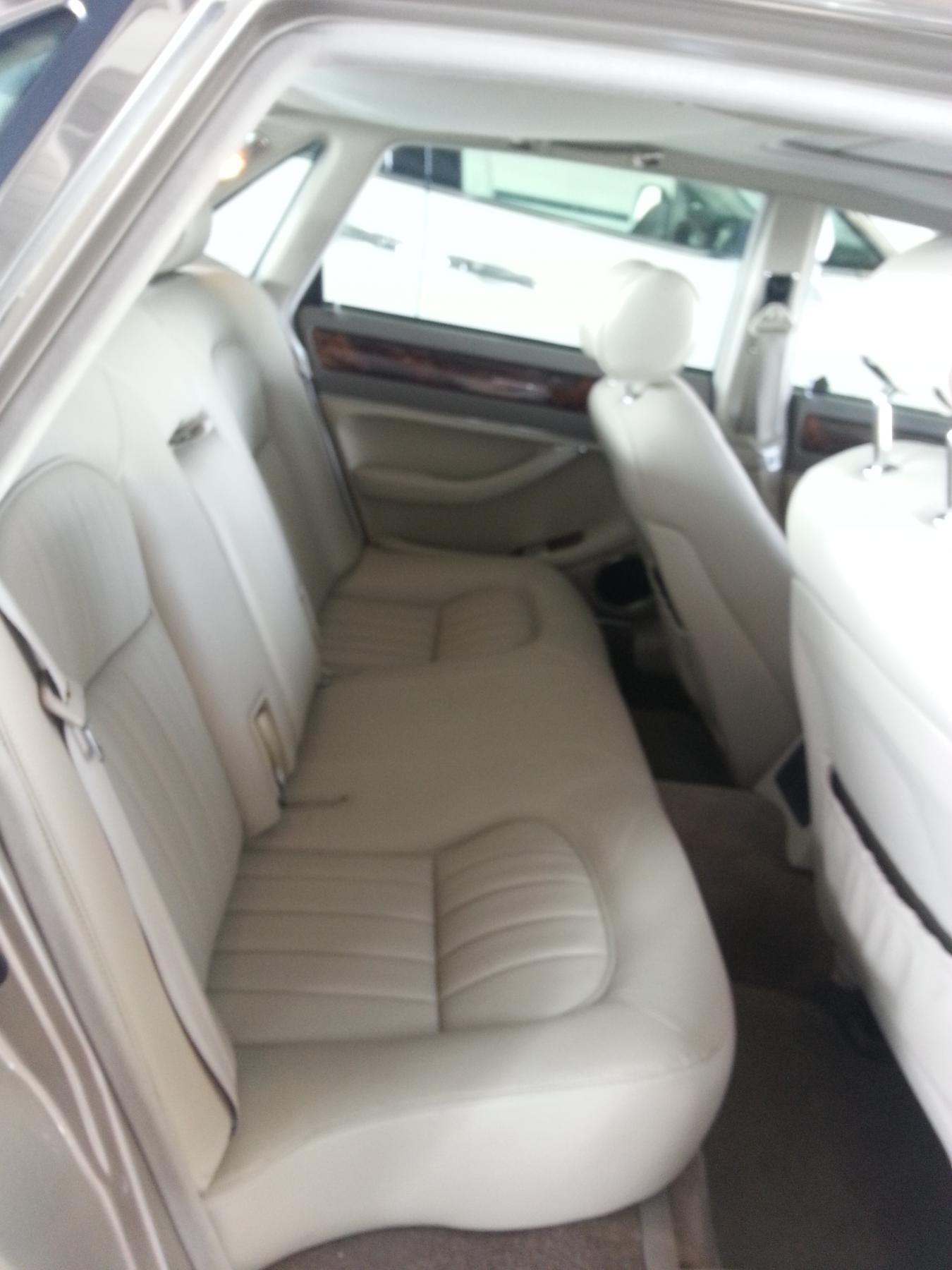

I am new to the Jaguar scene, been a mustang man just about all my life and decided to try something different. Right now, I'm kind of missing my mustang. Hope I didn’t buy a money pit… I've only had it for two weeks now and have been able to drive it for 4 days.
Here is what I bought:
A 96 XJ6, with 37K original miles, in mint condition. For $3000. I am the second owner of the vehicle and the first kept it garaged. The inside and out are immaculate, and it rides like a dream! The first owner was an older lady who hardly used it, realized this, and wanted to get rid of it.

Looks like a great car, fantastic color.
BTW, keep an eye out for a 2003 (actual, or equiv replacement) used cup holder with the updated steel hinges and you can fix your broken one with the plastic pivot points. New improved ones are available too, but they are pricey. Used ones pop up on eBay pretty regularly.
