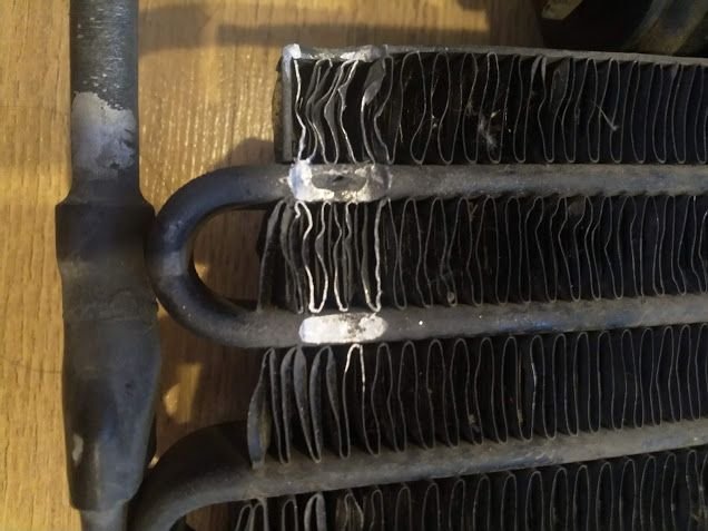

Meh, it sucks big time
3 years after my little accident and I'm still fixing the car. That side got hit, headlight was crashed, horn and grill pushed in. I suppose at least I found my small leak finally, for the past 3 years AC was fine for approx half a year, I suspect it finally gave up here and was impossible to find it without this hole or removing it completely as well hidden behind radiator(which caused this) and top panel.
Apart from this small hole rest of condenser is pretty much in like new condition so I will attempt repair. I'm planning on removing fins around the hole, brazing it and probably jb weld the whole thing. If it holds vacuum then that will do it, if not I'll look for a replacement but really annoyed as this is only ~4 years old and still looks perfect other than this damage.
BTW, re original question, the port size is 1/2"

Katar,
If you can do that yourself, then that's great. A brand new condenser is about $100, so it certainly would not be worth paying someone to do at this point.
