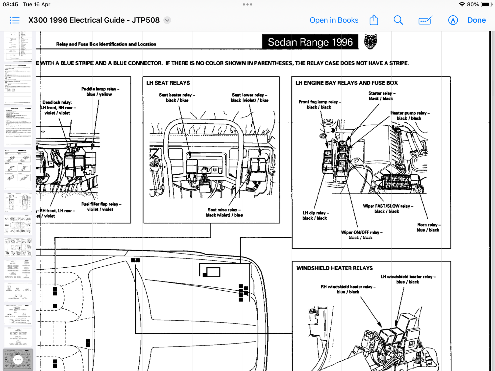

Hi all, yes I’m back with yet another issue with this x300 and slowly loosing my cool with the car. Now a two new faults. First one is both front fog lights have failed. The bulbs are good and the fuse is good and there is voltage going to the fuse. So I’m guessing that means a relay. But which one is the fog light relay?

This is the page from the hand book telling relay position, but sadly not the number.
Found better picture with exact location!
There is also attached a pdf explaining how to test the AC
Hope these help.
