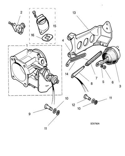

I think we are talking of the same item.
Different markets/countries have different names, and we are apparently the oddest???.
The ICV is on the throttle body, top rear. I have attched a parts drawing that may assist.
Alternator maximum current/power in 96'XJR?-x300r-throttle-body-parts-drawing.jpg
Item #15, Jaguar call it a "stepper motor", we call it an "idle control valve".
