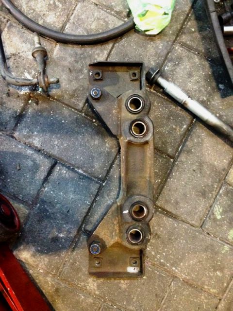

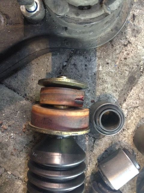

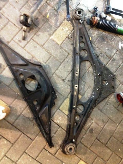

Have moved on despite the set back. Had ordered loads of parts from UK, and found some more locally. Found a workshop taking care of the underside, suspension, and all bushings and linkages. See pictures. It is a massive project....

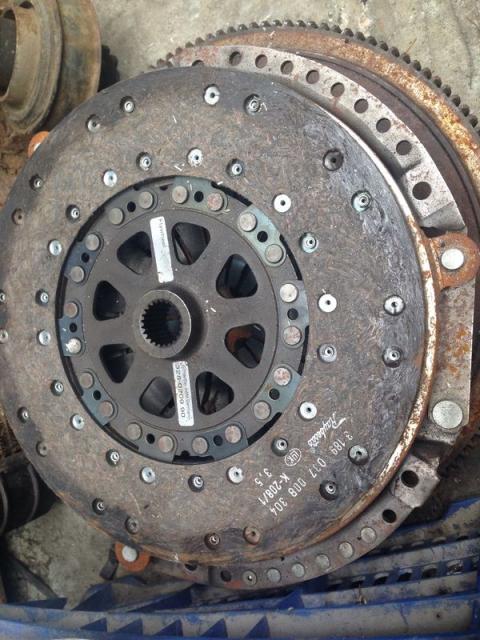

Bought new clutch kit; got adaptor plate from Ray; and ordered remapped manual ECU from Andy. The next phase is tackling the engine mini overhaul (valve cover gasket leak), and the actual transmission transplant. More work to follow: overhauling the aircon; fine-tunning and body work. Pictures pending.
More... After all these early phase work done, I successfully re-licensed the XJR with the original auto transmission. Should have been a straight-forward step but alas, the VIN number next to the car battery in the boot became illegible due to many years of corrosion so the authority took caution to verify that this was not a lego car with head and tail welded together. Searched this site and the handbook to find if there are secondary identification numbers on the car but to no avail. Handbook said there should be two VIN number in the boot, one below and one above the car battery - not true. In the end the car went to the Government Transport Department for a thorough check and they acknowledged that the car is original and one piece. To prevent similar hiccups when the car goes for future annual inspection, the Government assigned a unique number to the car and registered it in my vehicle licence document. It was dumb of Jaguar to stamp a VIN number near the car battery, knowing what acidic moisture around the battery could do to the metal nearby. Wish all pre-project saga were over. Am anxiously looking forward to successful transformation of the XJR. By the way, my XJR is in original rose bronze metallic, a unique colour only available in the 1995 lot, I heard.

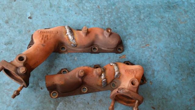

Thanks Ray for the heads up. The parts numbers are on the exhaust manifold so mine read NBC2902AA/CA and NBC2903AA/CA. The air injection and non air injection are for different markets, depending on emission control; so is the EGR (Exhaust Gas Recirculation). Hong Kong has pollution control, largely in step with what is prevailing in Europe.
Am looking for a good valve cover, and I have welded the exhaust manifolds as a temporary fix.
Would find a metal shop to custom-make a stainless steel set later.

I saw an eBay offer of a pair of new manifolds for GBP190 each, but would be hesitant to buy for fear that they may crack as what doc testified in earlier threads in this forum. I believe stainless steel would be the way to go, and the cost would justify the investment given how notorious the factory originals are. Someone said it before, why no one found an affordable and permanent solution before. Maybe used ones are still abundantly available at the time, but not any more. So this is the real testing time.
Having welded the exhaust manifolds you may wish to consider having the sealing face machined flat. They may have become distorted though 170,00km of thermal cycling or through the welding operation. If they are not currently flat then they won't seal well, and bolting them out the flat side of the cylinder head will introduce stresses that may cause further cracking.
I could design and have made sets of fabricated stainless steel replacement exhaust manifolds, but I would have to make several sets in one batch in order to be competitive with the price of the std cast parts. If someone wants to start a separate thread to create a consortium of interested owners who want to buy fabricated exhaust manifolds, we could see if there is sufficient demand for a one-time batch of new fabricated parts. I already offer 8mm thick 308 grade stainless steel flanges to people who want to make their own manifolds. I also offer just the computer files that are used to programme the water jet or laser profiling machines that cut these flanges out of plate.
