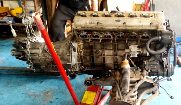

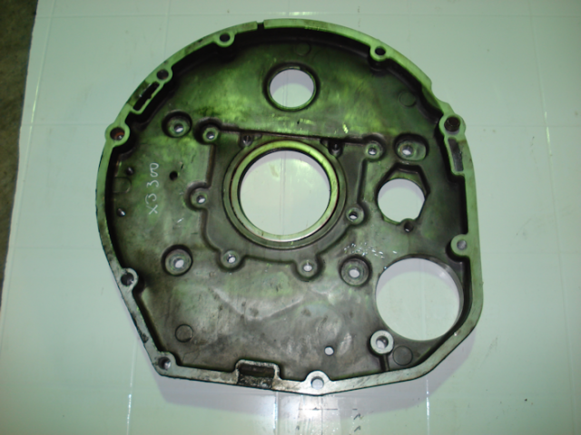

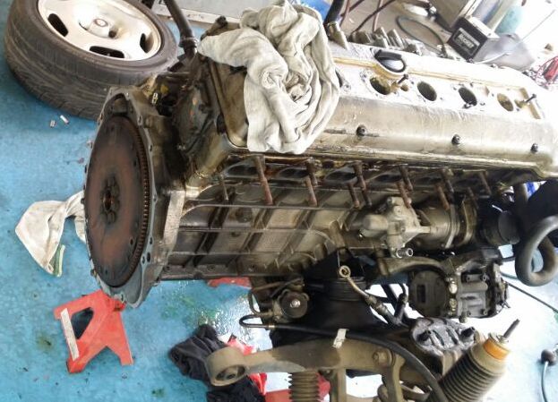

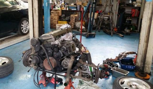

Here are some pictures of the project:
First the Adaptor Plates, sourced from New Zealand, which is needed as a go-between before fitting in the gearbox to the bell housing
New clutch kit sourced from eBay UK
Did you know the XJR has Dual Mass Flywheel (DMF)?
Engine removed from car
Exhaust manifolds removed for welding, but there is still air leak after welding
Manual Gearbox, Adaptor Plates Flywheel etc. fitted in place
Notice the badly corroded Valve Cover, and the piping that goes under the exhaust manifold heat shield (the air injection inlets and EGR valve lining, aircon hose etc. which may obstruct the fitment of after-market exhaust manifolds
Would need a pair of exhaust manifolds in stainless steel to replace the toasted originals. Going for non-standard manifolds may require altering the many lines and pipes below the heat shield; not an easy task, and certainly not for amateur or DIY.
I agree I should look for exhaust manifolds made by professional shops; unfortunately none really at that level in Hong Kong. I shall see if I should go it alone or wait till others come along, but the group buy idea seems rather remote at this stage.

It is not clear from the one photo showing the exhaust manifold whether an EGR system is fitted. I would expect to see a large black electrical valve (about the size of a coke can, bolted onto the back of the exhaust manifold.
