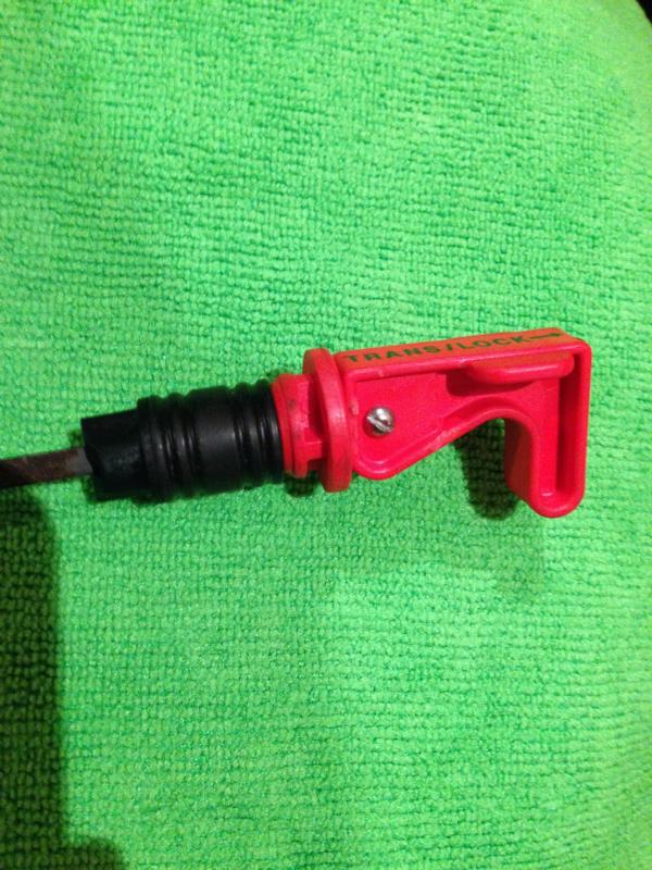

1. The auto trans dipstick won't lock. I push the dipstick all the way in, and it springs back about 1 inch. If I hold it down and flip the lever down, nothing happens and it pops up again. Inserting the dipstick isn't smooth; I notice a couple of resistance points as it's going in. Is this a broken locking mechanism on the dipstick itself, or a problem in the filler tube, pan, etc? Where can I get a new dipstick if that's the problem?

So, here's a follow-up to my dipstick issue.
The new dipstick arrived at the dealer in less than a week, $23 and change CDN. Luckily I brought my old one with me: the new one is about 4 inches too short! I had a sneaking suspision this was too good to be true. I went back to the parts counter and the gent looking into it further. There were 3 changes that didn't show up initially, with the final result being that Jaguar says the new short dipstick is the correct one but I have to change the dipstick tube to a matching item. They had one tube in their whole system: in Brisbane! No thanks.
So upon further reflection and examination the new dipstick had the identical locking head. The problem with the old one was the plastic "barrel" had hardened and didn't widen when compressed preventing the dipstick from holding in place. So, I drilled out the rivet from both levers and swapped the old for the new. It fit beautifully, except where was I going to get a 0.5 inch long pop rivet? Off to an industrial supplier I go.
They didn't have a long enough rivet either, but they did have the correct diameter bolt and nut. I used this to mount the new locking mechanism to the old dipstick, and used Loctite Blue to cement the nut to the bolt, but I can still remove it if need be. It works! So all in all it was a lot more fiddly than just getting a new dipstick, but I was able to salvage things and get the car fixed for little cash outlay. I'm going to drive it for a while and if the dipstick stays locked I'll cut off the protruding bolt. For now I'll leave it be in case I need to redo things.
The punch is pointing to the stiff "barrel" that caused the problem.
