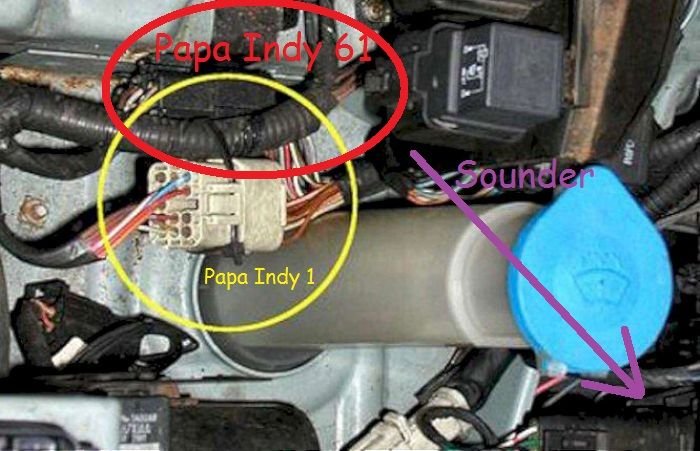

another thing is the Papa Indy 1 and 61 connectors under the hood behind the right front headlights , these connectors contain some engine regulation wires
05.1-14 (jagrepair.com)
