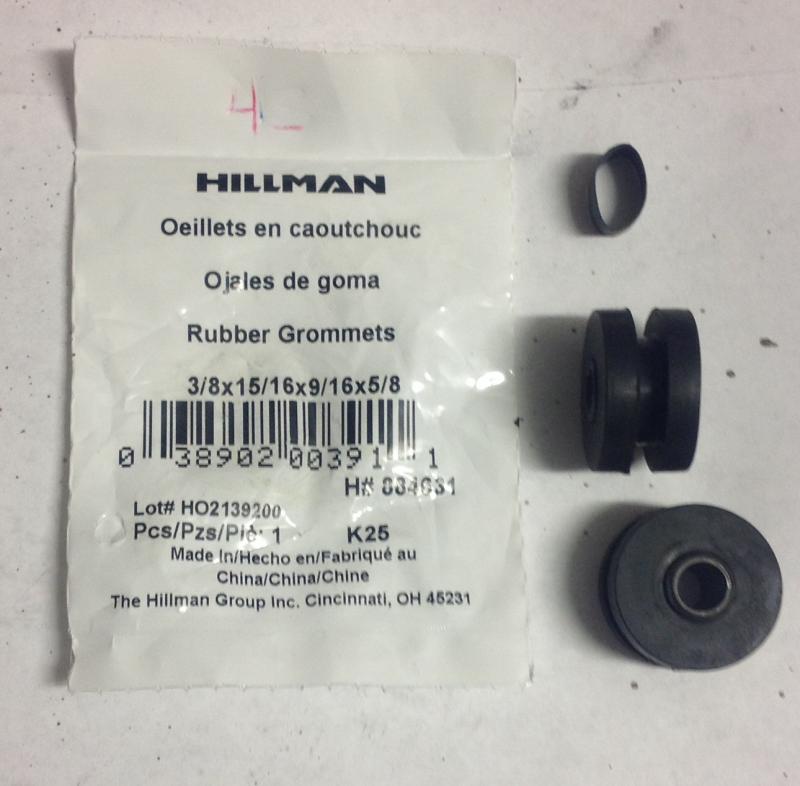

Default Remounting Power Steering Reservoir
Hey Guys,
Found the power steering reservoir flopping all over the place as the grommets that hold it in place were all disintegrated. Quick run to my local Lowe's with what remained of one of the grommets helped me to find a couple of replacements. They only had two of these so I had to makeshift the third or top one using other grommets I had in the shop.
The spacers are a wee bit smaller than the opening in the grommet that allows some play so I took some heatshrink and used that to enlarge the spacer to get a snug fit. Putting it back in today and hopefully, they last.
Picture to show you what I picked up including the bag for PN reference.
Total cost was $3.00
Bernie

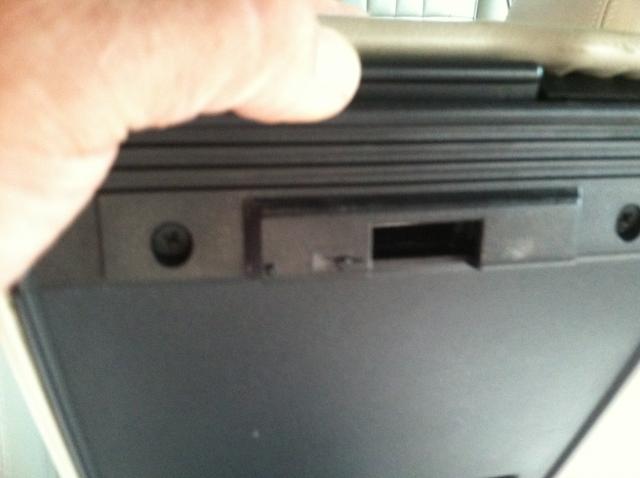

  #72
razorboy's Avatar
Joined: Oct 2013
Posts: 735
Likes: 286
From: Las Vegas, NV, USA
Default What the heck?
Guys I feel like a moron but,
How the heck do you open the center console?
I have the version with the flip out beverage holder but for the life of me, I can't find a release button and it feels like I am about to break it when I try to pull up on it. I saw a version that has a magnetic lid but that seriously can't be what mine has.
Since I don't have an owners manual yet, any help would be appreciated.
Bernie

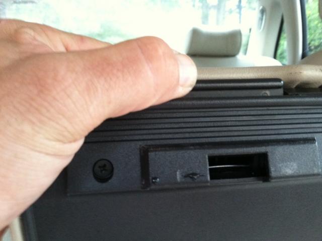

Old Nov 4, 2013 | 02:03 PM
  #80
JTsmks's Avatar
Joined: Nov 2012
Posts: 1,758
Likes: 723
From: Fleming Island, FL
Bernie, heres two pix, one thumbing the latch open and catch bar out of view ie, open and the other latch released catch bar in view ie, closed. On the first pic I'm pushing up on the tab and on the second I'm letting it loose. Hope this helps
Attached Thumbnails The Birthday Jag!-latch1_zpse9983ab9.jpg   The Birthday Jag!-latch2_zpscd12579a.jpg
