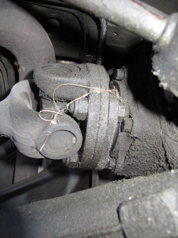

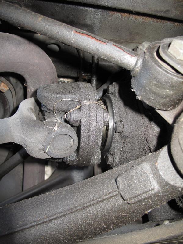

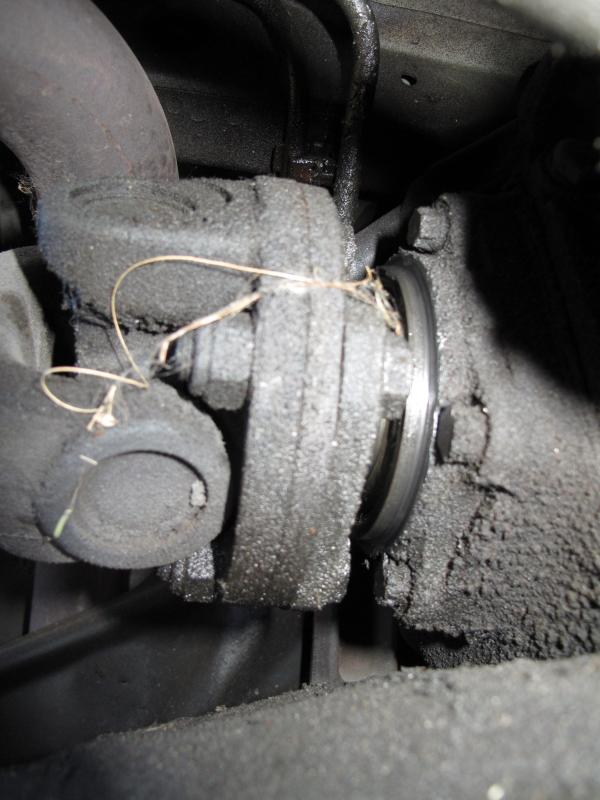

Hey Guys,
Found a larger issue with the Jag today on the differential.
The drive axle on the driverside has some major play in it and the passenger side just a little. Guess this is where all of the rear end noise was coming from
So I am looking for advice here on this repair. Is it the axle that needs to be replaced, something between or something inside the differential that is letting go? Not familiar at all with these diffs so don't really know what component is having the issue. The shaft itself pulls in and out of the diff when I lift the hub up and down.
Anyone done this type of job before?

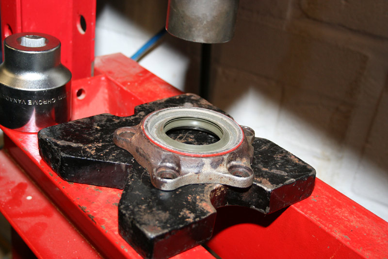

Don't panic just yet. The movement is in the Diff Output bearing which is replaceable with the diff in situ. However I've not seen one that has that much play before (maybe others have?). So either the bearing has completely collapsed or the locating collar has come off.
The repair is a fairly common thing and I'm sure there are lots of posts that cover it, but attached are a couple of pictures to give you an idea of what you are dealing with.
First picture shows the bearing and the splined shaft that sits inside the diff. In the picture, the flange just below the bearing is the flange that you see in your pictures with the spline headed bolts. This is showing the bearing collar being drilled before splitting with a chisel. This is the recommended way of removing the collar.
Second picture shows a new bearing seal fitted. This is in the same flange on the other side.
You can do this job without any special tools. A press is ideal but you can manage without it.
