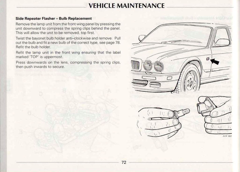

How do I change my fender blinker bulb. I'm changing all of my bulbs to led's. I was going to
to see if it had a catch like the front blinker fixtures but stopped before I scratched or broke any thing. Can someone help me. I know it's gonna be something single

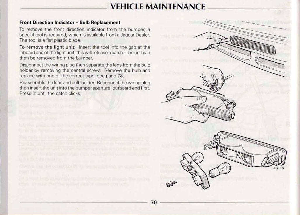

From the Vehicle Care Handbook:
Side Repeater Bulb
Front Indicator Bulb
The 'special tool' is just a piece of plastic to avoid scratching the paint. I wrap insulating tape (electrician's tape) around the end of a flat bladed screwdriver instead.
