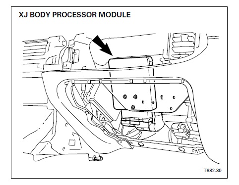

Does any one know where I can find the bpm on a jag xj6 1995
Like, right here!
I should add that this is the location, but your module will look a bit different than this one; this is a pic of a 1998 sedan part.
Cheers,
Attached Thumbnails Body Processor Module Interchangeability?-x300-bpm-location.jpg

the pic is a great help thanks is that around the glove box area ?
Yes, forward of the glove box, off center to the left side. On the engine side, I believe there is a spring loaded pin [sort of like a small knob] to pull out. That will release it so it can slide down and out of its mounting.
Good luck!
