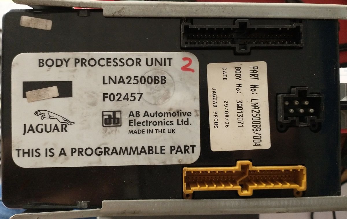

Is the module with ID
LNA2500BB/010
replaceable by the module with ID
LNA2500BB/004?
So my car's got the /010 BPM, can I try with the /004 that I got from a donor car?
My car's BPM:
010 => A whole list of countries, almost all of them outside Europe.
Original BPM
Donor car BPM:
004 => Belgium / The Netherlands
Donor BPM
Old Jul 24, 2021 | 06:35 PM
xalty's Avatar
Joined: Dec 2019
Posts: 3,695
Likes: 1,223
yes try it
