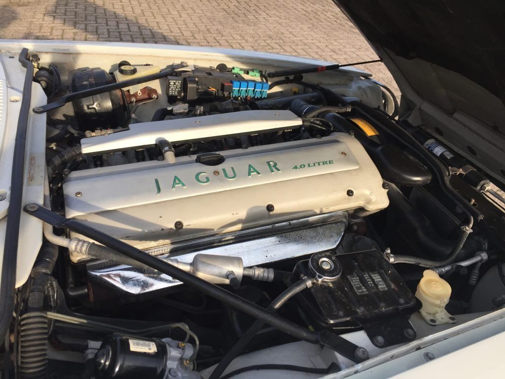

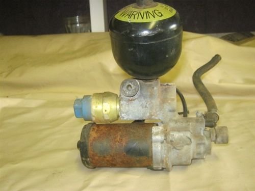

if this is a LHD car look for a black sphere with a big danger sign on the right side of the car close to the firewall. this is the original teves electro-hydraulic pump booster master cylinder combo
this is what an AJ16 XJS should look like, big black drum in the top left corner
