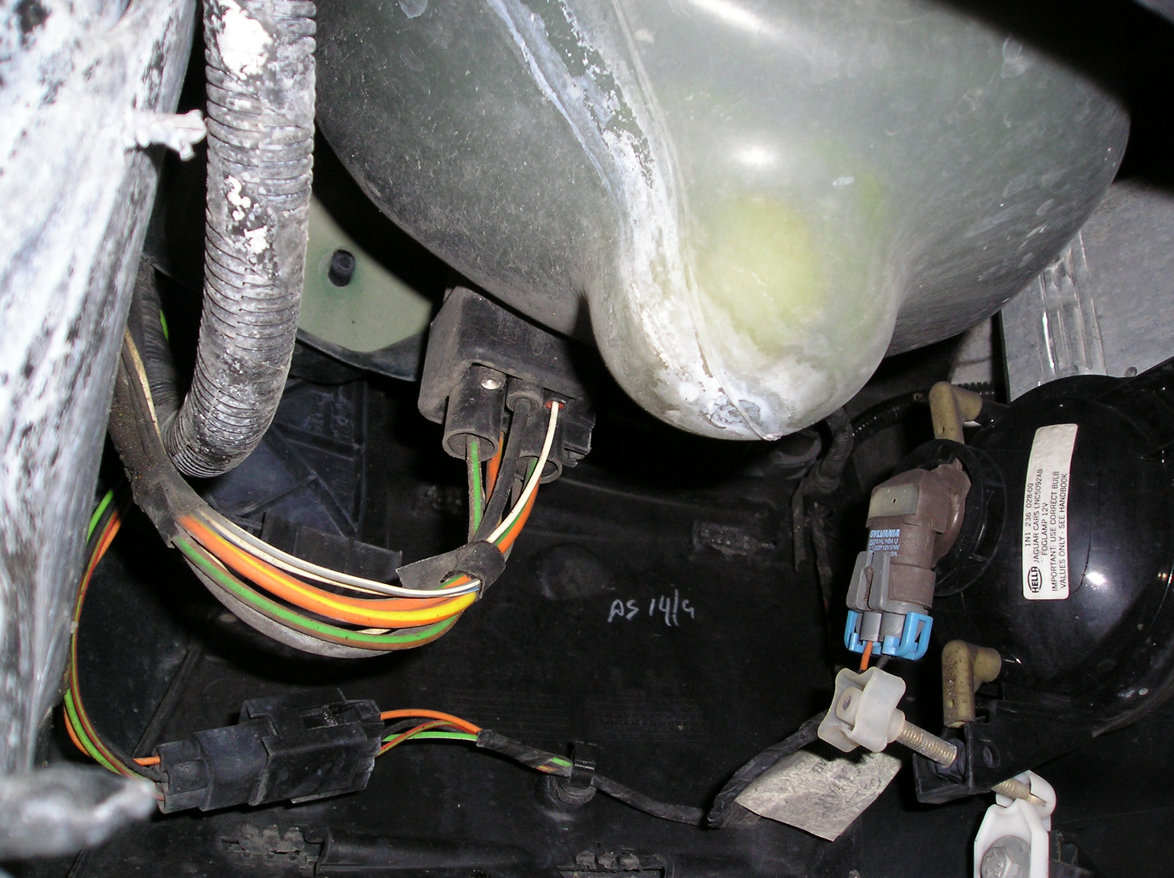

The fan control module is clipped to the underside of the body, below the LH headlamps. Rather large, white cover, accessible from below. If it get loose it hangs upside down by the harness and fills with water and crud. Result, no fan. Check that first.

Um... I can't seem to find it.
Below the LH headlamps, the driver's side? Like where the windshield fluid reservoir is, but on the driver's side? I haven't got anything over there, and no extra unconnected wires hanging about either.
edit: FOUND IT! It was still connected fine, took it off, was plenty clean, just a bit of dust/dirt on the outside. Inside the prongs were nice and shiny. So, relays or pressure switch next?

Yep! LH side [driver side in US], right beside the brake cooling duct. Here is a pic of the same part in the X308. That's the wiring and connector to look for. The X300 does not have the atmospheric tank you see here. Also the location as shown in the wiring guide.
Good luck!
