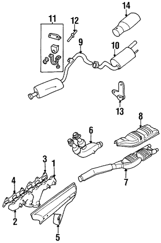

The catalysts are shown as items 6 and 7 in the drawing.
Hope this helps.
Hope this helps.

Sorry NBCat, but I'm confused...
Doesn't the USA X300 have four total cats? Two on the downpipes and two underfloor? That's what I've always thought! The 2 cylindrical items on the downpipes, plus the 2 boxy items underfloor after the split.

Yes the x300 has 4 cats as stated by Richard and clearly shown in the diagram, 1 x 1/2 cat in each down pipe and 1 in each pipe under the floor one slightly in front of the other Item 7
