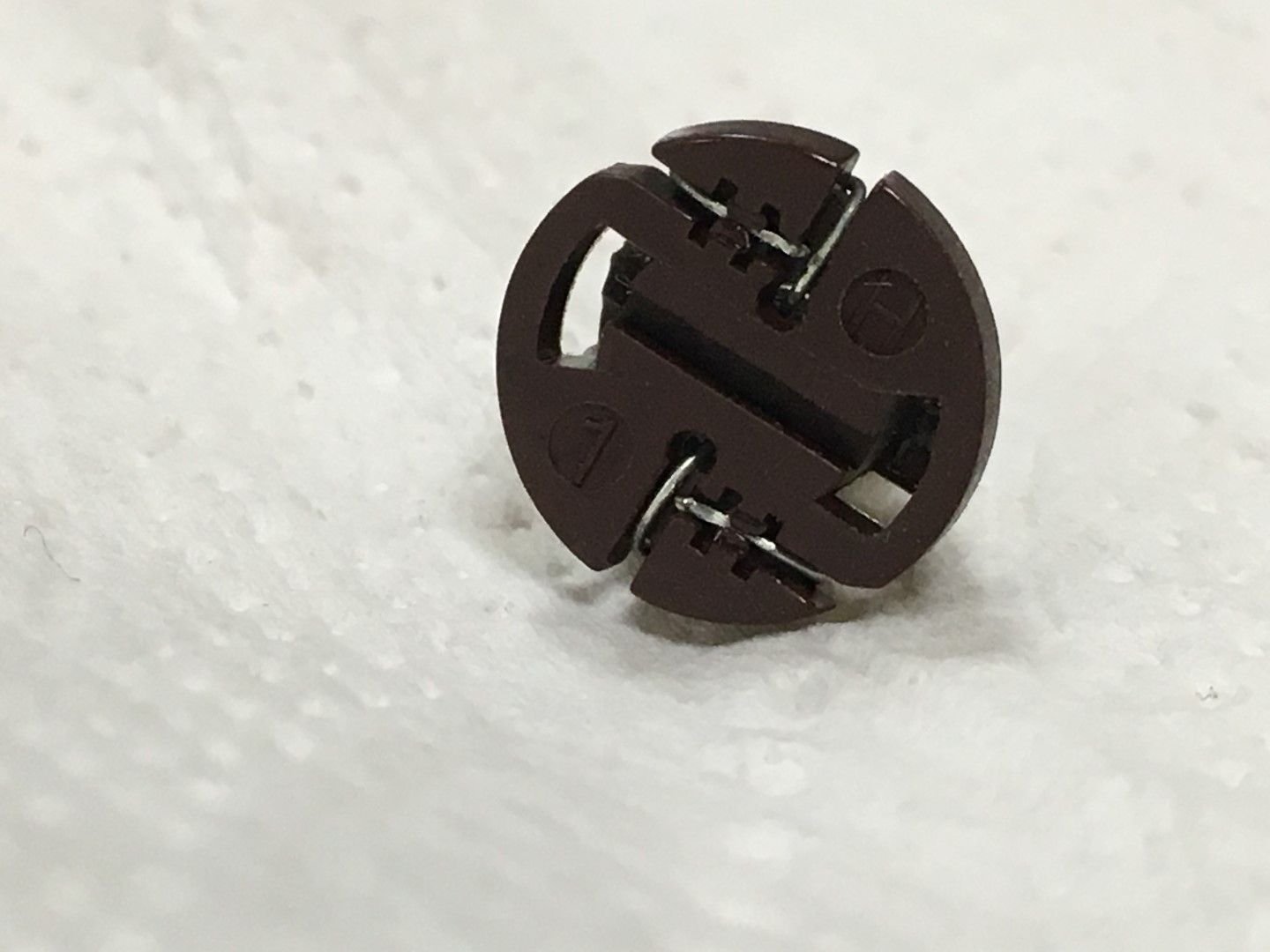

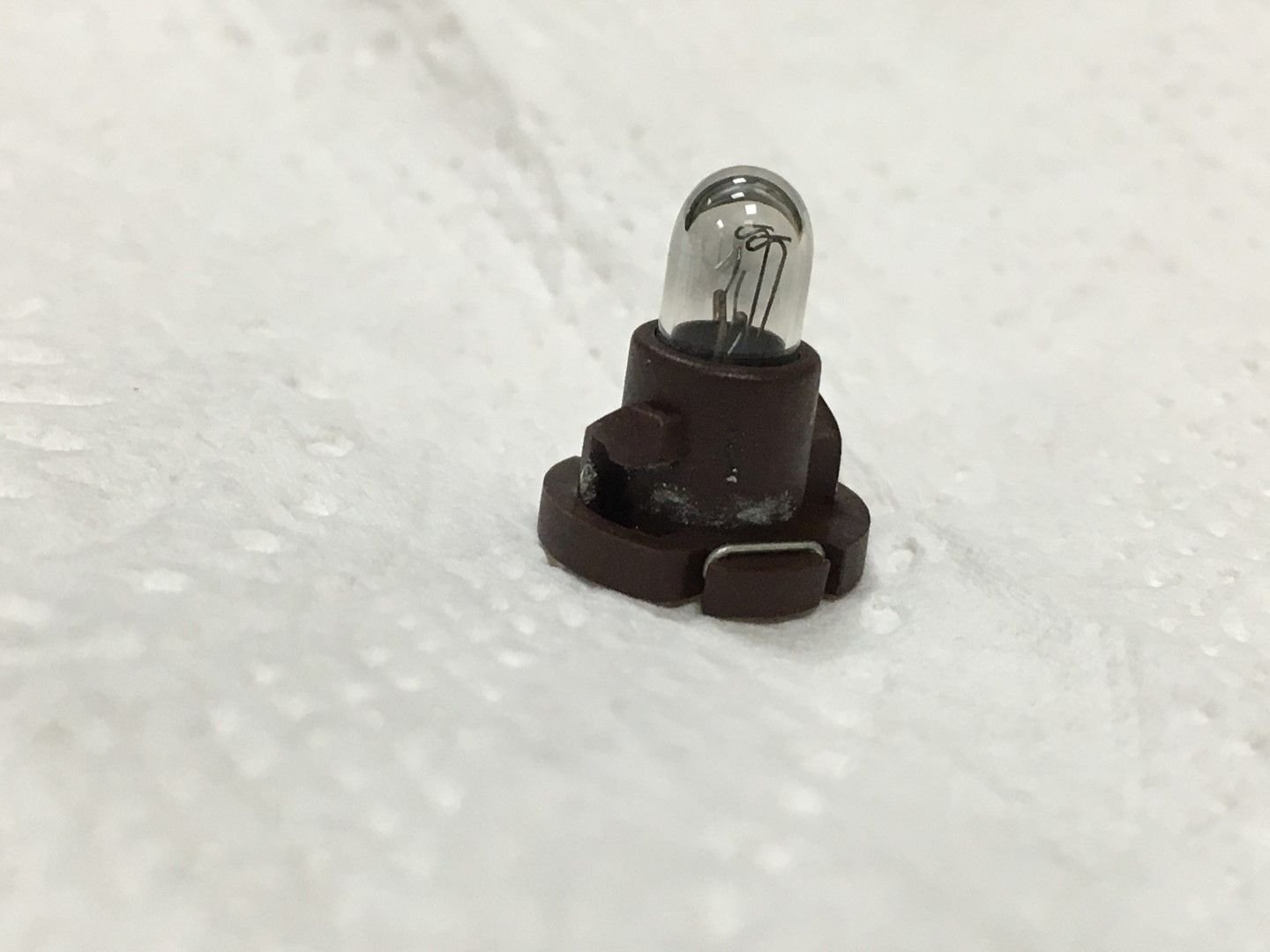

Well, a fellow member of the JEC has donated a load of surplus bulbs to me and now everything works. What a hero.
For reference the brown bodied bulbs are part number JLM11965.
Glen.

Well, Andy a fellow member of the JEC has sent me a load of bulbs that were surplus to his requirements and now everything works. What a hero.
For reference the brown bodies ones are part number JLM11965 and are available from SNG and probably others.
Happy days
Glen.
