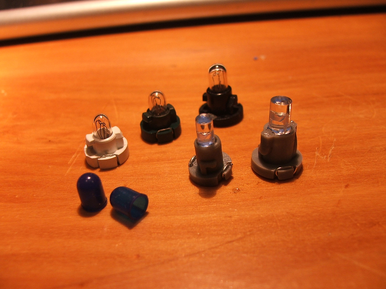

Neo-wedge: Stock incandescent backlights with T3 and T4 LEDs (note the blue silicone caps which are used on the stock lights to give them their greenish glow [blue = green? don't ask...]).

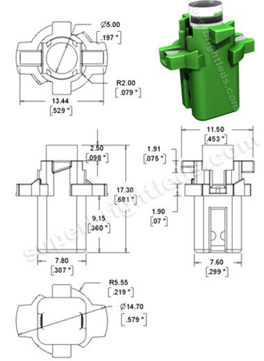

Jaguar's neo-wedge sizing:
There are two different calibres of neo-wedge used in the X300. The larger ones are T4, so the T4 LED replacements fit perfectly. However the smaller ones (abundant in the climate control module) are not T3. They're somewhere between T4 and T3, a size that doesn't seem to be used anymore. T3 units may be installed, but they felt a little loose, and I wouldn't trust them to remain in place in the long term (car vibrations etc.).

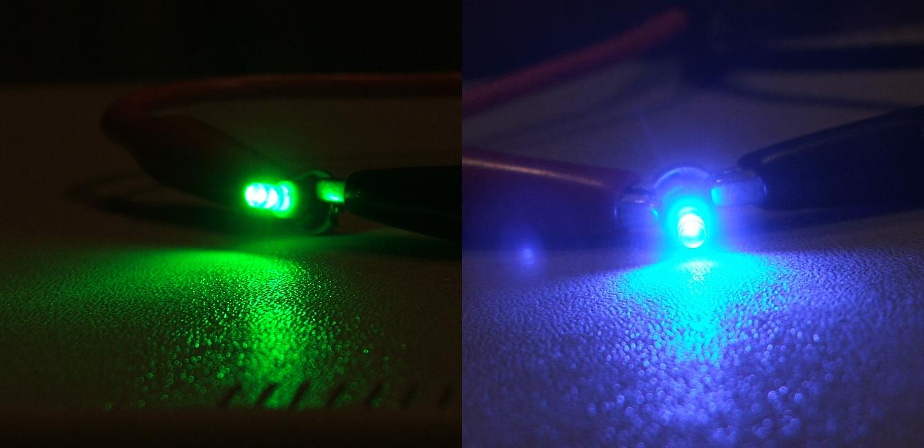

BL LED Optronics stock a range of colours, including white, blue, green, red and amber. I was torn between blue and green, so I bought some of each to trial. To my eyes, the brilliant spark-blue lights were most pleasing.
Testing the LEDs with a power pack.

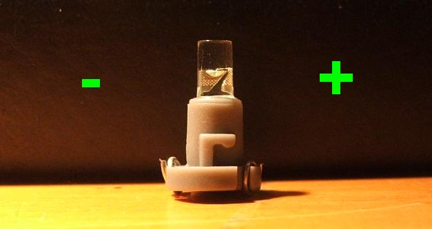

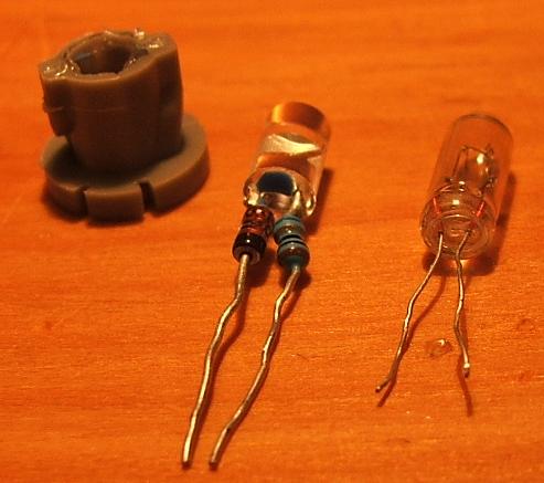

They are actually more than just an LED. Inside the plastic base you will find a resistor, and also a diode to protect the LED should you connect it the wrong way around. Thanks to this reverse polarity protection, you can simply install them one way and then turn them around if they don't work. However, for future convenience you might want to go over the Jaguar sockets with a multimeter, and mark the polarities. (Note: socket polarities are now illustrated further into this post)
You can tell the polarity of an LED bulb by looking at it's structure inside the lens. The cathode is the larger part and is the negative side of the LED. The smaller anode is positive:
Close up neo-wedge LED.
Of course if you're frosting the lenses as I've done below, you wont be able to see this structure, so it's a good idea to mark the positive side of the base with a permanent marker or something before you make any modifications.
When I first installed the LEDs, they were ridiculously bright, but I was expecting this, having been warned by 6cylinderDOHC on the UK Jag forum. Even with the Jag's dimmer switch at minimum, they were bright enough to be highly distracting (and other shops were boasting backlights twice as bright! What's the point?). So I set about finding a good way to tame them.
My first course of action was to 'frost' the lenses in order to dim and diffuse the light (LEDs are far more directional than the stock incandescent backlights, and these ones were not doing a very good job of providing uniform backlighting of the clock/air-con LCD displays). I used sandpaper (220 grit) to rough the lenses so that they were translucent rather than transparent. It took some patience to get an even finish, and when I re-installed the LEDs to test them they were still too bright and too focused, despite a vast improvement.
My next experiment involved coating the lenses in white enamel paint. This process was extremely tedious and I was still not happy with the result (inconsistent light distribution/intensity etc.)

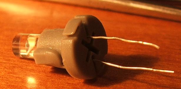

Replacing Resistor - Removal and Re-Installation of LEDs in Neo-Wedge Bases:
A) Unwind the two wires and straighten them with pliers (don't bend them around too much or they will weaken and break):
B) Gently work the LED out of the plastic base. You'll probably have to rock it from side-to-side a couple of times to break the glue. The stock resistor and/or the glass-cased diode might become disconnected in the process:
NOTE: There was some overzealous glueing evident in a few of the neo-wedge LEDs I purchased, which made it impossible to extract the LED and it's components without destroying the base. For this reason, it's important to buy extras.
C) Remove any glue from the plastic base, LED or other components.

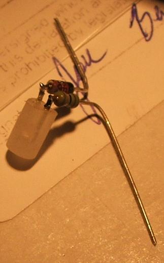

D) De-solder the stock resistor, and cut the new one to match:
I found a pair of locking surgical forceps very useful for holding this still during soldering.
NOTE: Resistors are bipolar, so it doesn't matter which end is connected to the LED.
E) Attach the new resistor, and re-attach the diode if it came off.
NOTE: The resistor needs to be on the positive side of the LED and the diode on the negative, make sure they don't get mixed up.
F) 'Frost' the entire LED by sanding it with a fine sandpaper until it becomes translucent.
G) Re-install the LED into it's Plastic base.

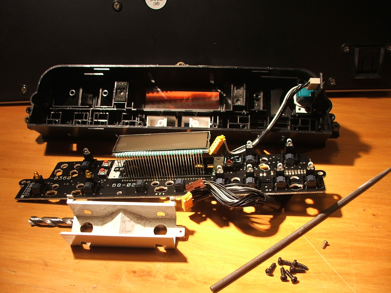

Better LCD Backlighting - 90° Mounting
I had two X300 clocks repaired by ModuleMaster recently, and their repair includes LED backlighting for the LCD screen. Of course, I wanted to mange my own backlighting for my car, so I told them to exclude the procedure from my clock. I let them modify the other clock though, and I'm glad I did because their strategy might be the best so far! They simply mounted their LEDs at 90 degrees so they weren't pointing directly at the screen (why didn't I think of that?). The result is an incredibly even distribution of light across the screen, and I've been able to re-create this in my clock and air-con screens.
There are some downsides:
- The colour of the light is whitened because all of it is refracting through, or reflecting off the white plastic structure behind the screen.
- A 'drop in' solution is virtually impossible. You have to solder the LEDs directly to the PCB.
I think it's worth it though.

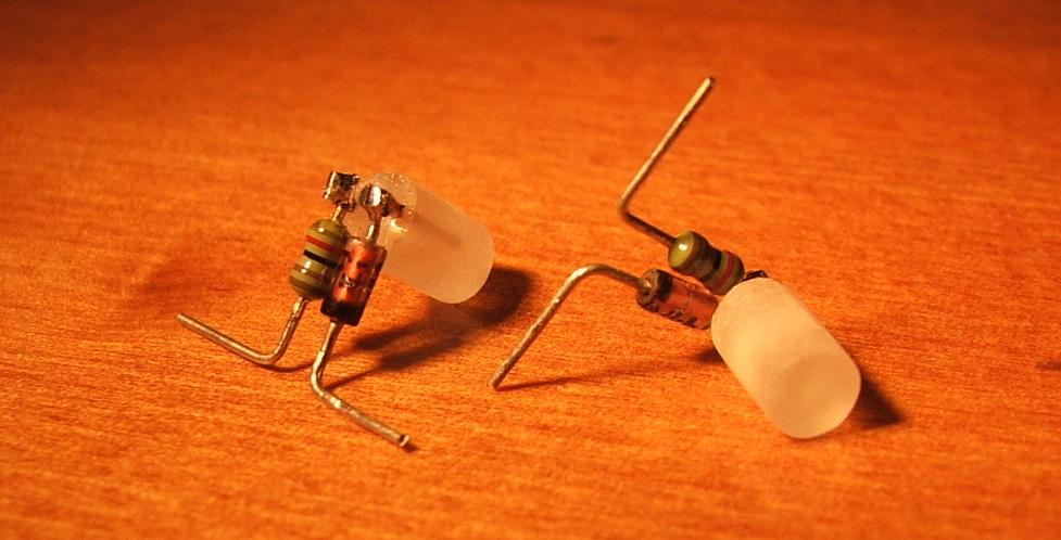

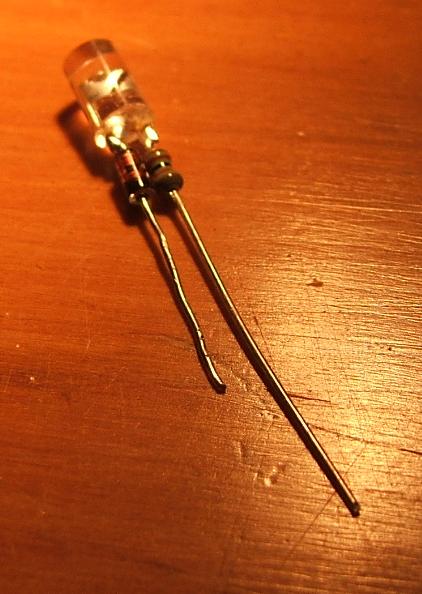

You need to solder the resistor and diode to the LED at 90 degrees, and then bend the legs so that they'll sit on the contact solder pads around the neo-wedge sockets, paying attention to polarity:
Positioning of legs for air-con screen.
Positioning of legs for clock screen.
Then solder them in place, both facing inward:
Once they are soldered in you can gently reposition them to make sure they are parallel with the screen:

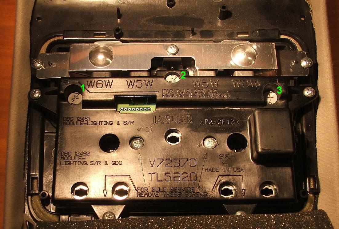

Ceiling Backlight Notes:
To access these, you simply remove the rachet fastener hidden behind the sunglasses compartment door. Use a coin (or whatever) to turn it 90°, and the ceiling console will loosen. Pull the unit down and towards the rear of the vehicle to remove, uncliping the wire harness.
I was also worried about these backlights, as they had no rubber cap on them (the colour filter is actually inside the buttons, and I thought that this might make the characters glow a different clour from my ski-slope lights) but luckily, the spark blue of the LEDs seemed to overpower the stock green filter without being altered at all:
X300s featuring a sunroof will have more than three neo-wedge lights to replace.

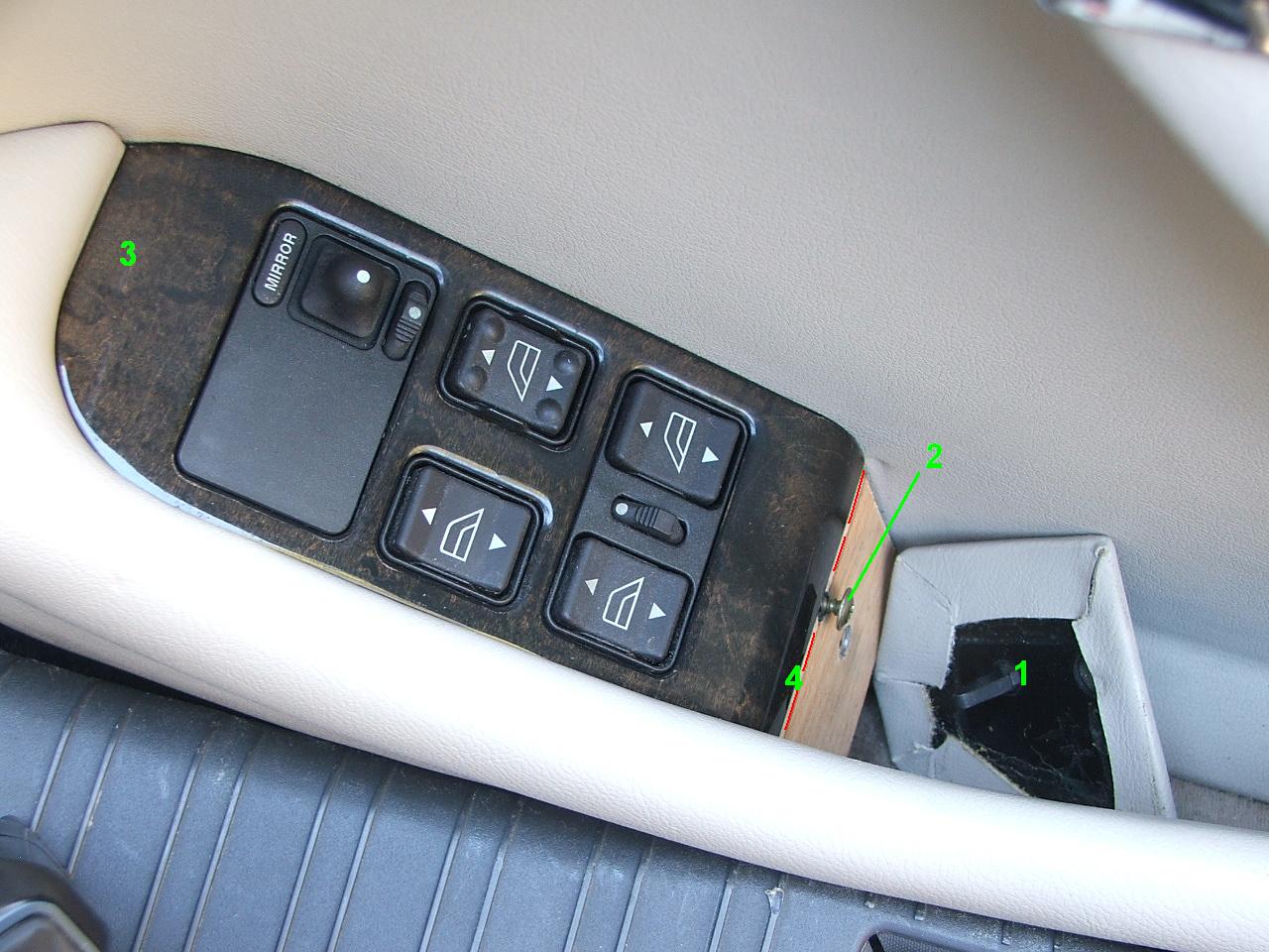

To access the backlights:
The little leather-clad plastic cover (1) just pulls away using fingernails or something blunt (so as not to damage the leather). Now remove the exposed screw (2).
On the underside of this wood trim, towards the front end, there is a metal tab (3) which hooks under part of the plastic switch box. So to remove the wood trim you need to gently lift it up (there is just enough of a lip (4) here to grasp), and slide it back. It might be jammed rather tightly between the leather on one side, and plastic on the other side, so be careful not to flex it too much and crack the veneer.

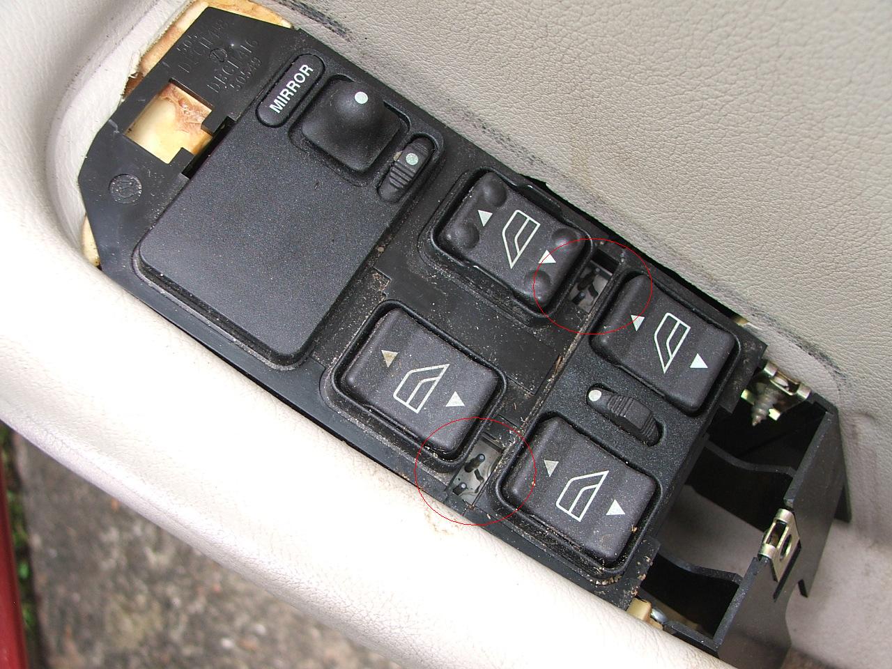

Now the top of the plastic switch box will be exposed, and next to some of the switches there will be tiny translucent blue panels. These are actually the cartriges containing the backlight bulbs. Gently work these cartriges up and out of the swich box. Depending on the car, there will be 2-3 cartriges. The drivers door is the only door with multiple backlight bulbs. The other three use just one, accessed the same way.

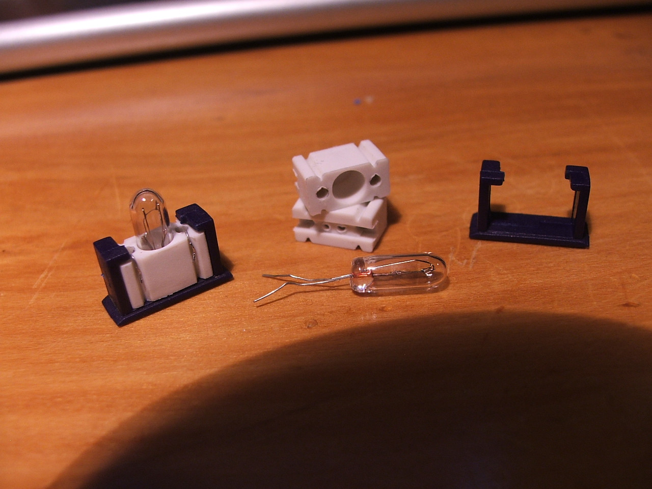

The cartriges consist of a blue plastic casing which clips around a white rubber brick. The bulb fits into the rubber brick, and it's wires are fed up through holes on either side. When installed, the holes press down on to metal prongs in the socket.
Stock door backlights - these ones also use coloured silicone caps.
Now I wanted to find a way to use LEDs in the doors. I removed one of my T4 LED's from it's neo-wedge base:
Including the components on either leg, they're about the size of one of the stock incandescent lights, so they fit into the rubber mounts just fine.
I must confess that installing the ex-neo-wedge LEDs in these tiny cartriges is no fun at all. Firstly, the legs of the LEDs are much thicker than those of the original incandescents, so I't a nightmare feeding them up through the holes. Secondly, the solder joints where the components join the led's were always breaking, so I had to take them out, re-solder the joints, and start again. A fools errand, to be sure!

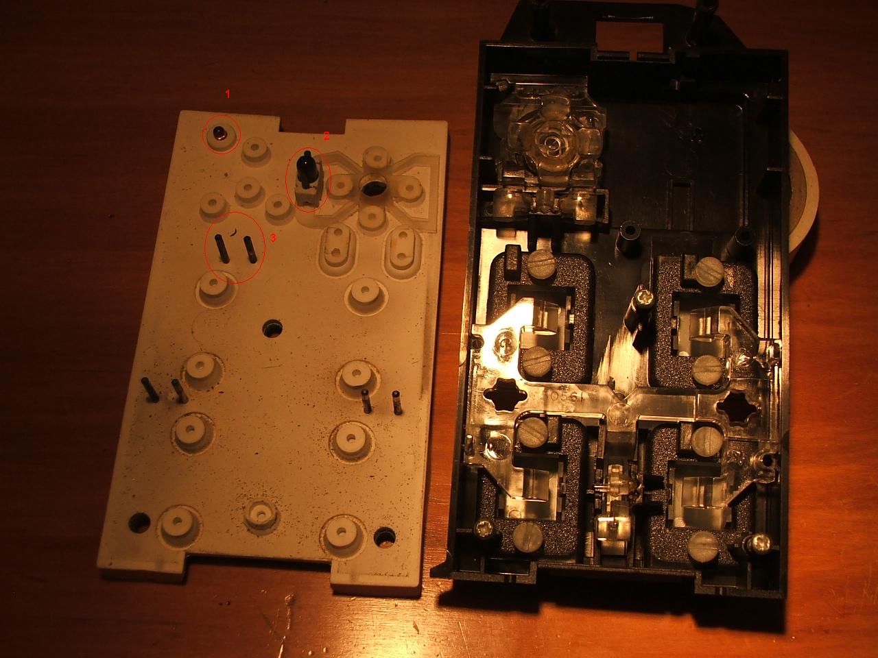

Door Backlights Continued - The Hidden Mirror Switch Backlight:

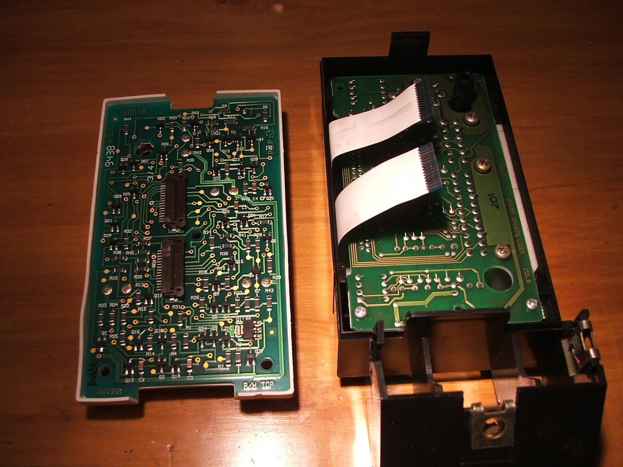

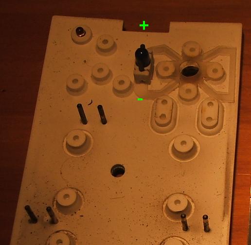

I had all the visible backlight cartriges removed, when I noticed a problem: the mirror controls in the drivers door were still backlit. Unfortunately, there is no way to access that particular bulb without dismantling the entire door (a very stupid move on Jaguar's part). If you're keen to waste a lot of time and effort for one miserable backlight, here are some guidelines:
You'll need to remove the interior trim panel from the door (a drama in itself), then disassemble the trim panel to acces the switch box.
1) Once you have removed the black switch box from the door, turn it over and there should be a single screw right in the centre (it might be concealed by a sticker). Remove the screw.
2) The casing will still be held together by a plastic clip at either end, so gently lift them to open it.
3) Unclip the two ribbon cables by lifting the socket clamp out and up.
4) The PCB that the ribbon cables were connected to is held down by two screws at one end. Remove them.
5) Now you should be able to lift out the PCB with it's rubber cladding. Do this carefully as there are lots of tiny plastic parts beneith.
The mirror backlight will now be accessible.
If you're installing an LED, remember it can only work one way around. Polarity is as pictured below, although It would be wise to connect the switchbox to the car and double check prior to reassembling the door:
More photos of the switch box internals:
2 = The mystery mirror control backlight (why didn't they make it accessable like the other two/three)
3 = Contacts for backlighting whatever extra controls are included in high spec cars. This has an access hole included in such cars (mine just has the depression where the hole would be)
1 = I wonder what this thing is??? it certainly isn't an active backlight...
reverse:
What a lot of circuitry!

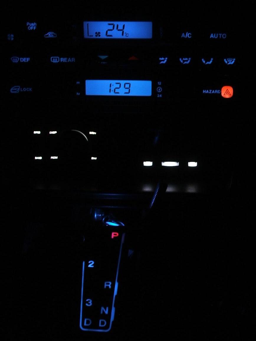

I would like to see a night shot of your interior

Me too! I have been think about fitting LED's for a while but figured they would be too bright.

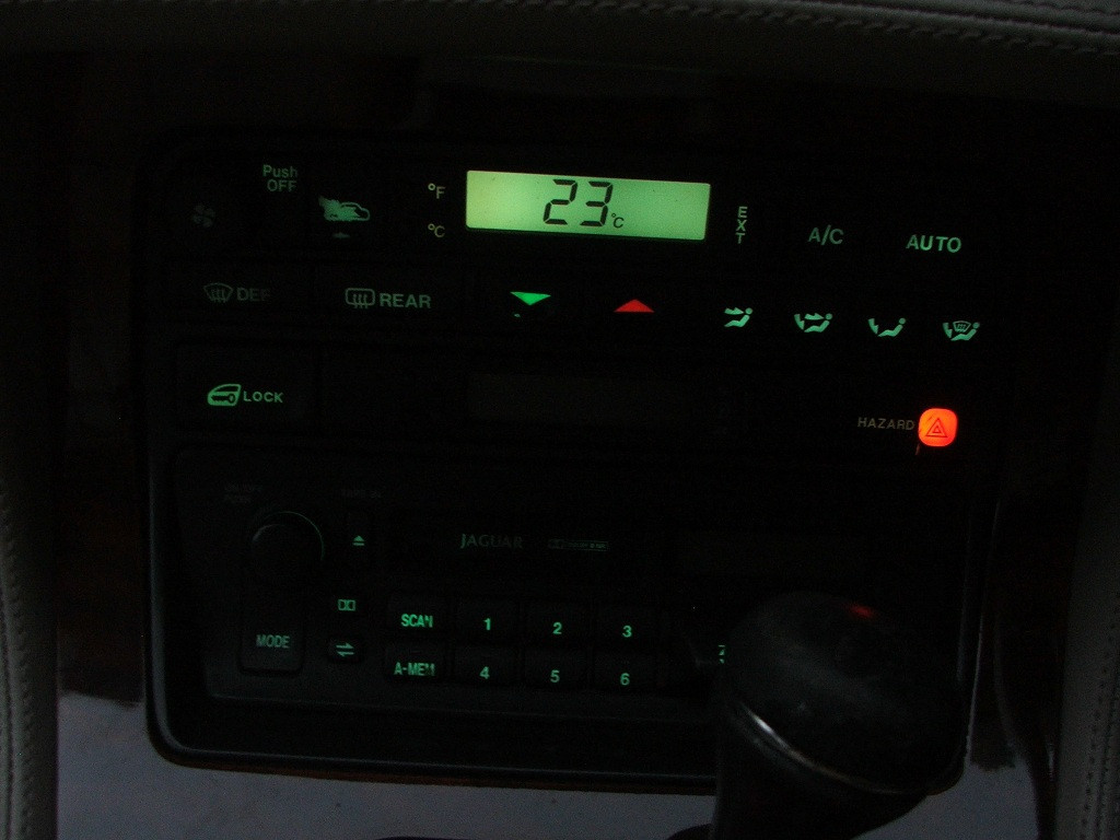

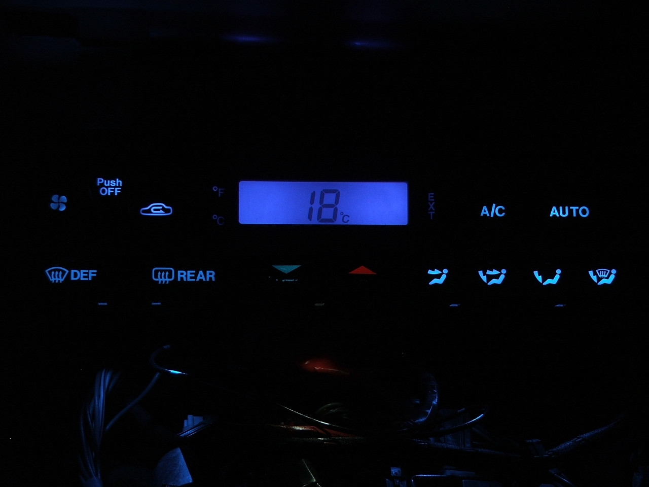

These results are with the LEDs that came out of the neo-wedge bases again. The light is pale, buy uniformity is excellent (much better to the naked eye), and this is just using the stock resisor that came with the neo-wedges. I will try some other resistances, and see which is best.

Clock Module:
1) T4 Neo-Wedge (must be White)
2) T4 Neo-Wedge
3) N/A
4) T4 Neo-Wedge
5) T4 Neo-Wedge
6) N/A
7) T4 Neo-Wedge
Air Con Module:
1) T3 Neo-Wedge
2) T3 Neo-Wedge
3) T3 Neo-Wedge
4) T4 Neo-Wedge
5) T3 Neo-Wedge (must be White)
6) T4 Neo-Wedge
7) T3 Neo-Wedge
8) T3 Neo-Wedge
9) T3 Neo-Wedge
10) T3 Neo-Wedge
The stock incandescents have blue rubber caps over them, resulting in a greenish light. I chose to go with spark blue LED replacements, but there were green, red, amber etc. available.
There are basically two sizes of twist lock neo-wedge socket used in the car:
For the larger neo-wedge lights, the X300 uses standard T4 fittings (base diameter 10mm). The smaller neo-wedge fittings are close to T3 (base diameter 8mm), but actually measure 8.70mm. T3 fittings can still be used though.
The neo-wedge fittings used in the centre roof console are somewhere in between. There is no fitting available between T3 and T4, so I used T4. They were very tight, so I used a drill bit to widen the sockets in the PCB just a fraction, now they fit very well. It is important to note that these lights need to be quite short, so that they don't hit the insides of the buttons. I just sanded a mm or so off the lenses of my T4 LEDs.
Attachment 1
Back row from left: neo-wedge from roof console, small neo-wedge from aircon, large neowedge from aircon and clock.
Front row from left: Rubber colour caps from stock bulbs, T3 neowedge LED, T4 neowedge led.
The backlights for the window etc. buttons in the doors are mounted in a little rubber brick. The bulb fits into the centre of the brick, then the wires are fed up through holes on either side and folded over. The brick fits into a blue plastic clip, and the lot is mounted in a socket located under the wood trim. The socket has two contacts poking up, and they go into the holes in the rubber brick, touching the bulb wires (hope that makes sense):
Attachment 1
I wasn't sure what to do about these, but then I removed one of the T4 LEDs from it's neo-wedge base, and look:
Attachment 1
Including the components on either leg, it's about the size of one of the stock incandescent lights, so it fits into the rubber mount just fine.
The problem is that the door backlights actually take their light from the sides of the bulb, and refract it throught some translucent plastic. This is OK when using incandescents, because the basically illuminate 360 degrees. LEDs, on the other hand, fire straight out the end of the lens, so most of the light would just be shining down at nothing, rather than being carried through and illuminating the figures in the buttons. Fortunately, the light from the LED can be diffused by frosting the lens (I used 220 grit sandpaper). This ensures that some light finds it's way out the side of the LED.
The only issue I have now is that I can't find a way to access the backlight for the mirror controls in my drivers door. I've got the two for the window buttons, but one remains...

Frosted T4 LED in door mount. Tomorrow I'll compare this to the T3s I've already installed, and see which one works better.
Attachment 1
The door lights are the only ones I'll just frost - all the rest will have to be painted. Earlier today I tried putting frosted LEDs behind the air con LCD, and putting the dimmer knob to it's lowest possible setting, but the bulbs were still to bright for decent screen uniformity. The screen backlighting seems to have only two levels; very high, when the knob is clicked into it's home position, and high, when the knob is in any other position. Turning it down doesn't affect the LCD screen backlights, just the buttons.
Those lights fit into the sockets circled below:
Attachment 1

I had initially dipped all my centre console neo-wedges in the enamel paint because I thought the results would be more uniform, but I've since discovered that brushing it on is more successful.
The T4 neowedge LEDs are not only physically larger, but they also use a brighter diode than the T3s, so I apply one coat to the T3s, and one full coat plus a second to just the end of the T4s. Will post photos tonight.
EDIT: These pictures are atrocious. I don't know why the lights look so uneven on camera.
Painted LEDs

See above. Added a photo of stock lighting for reference - I guess my LEDs aren't too bad, because the stock lights look even more uneven. (note: green lights appear much dimmer because they were taken with more ambient light)
I've sent my clock to modulemaster for repair (once and for all, hopefully), which is why it didn't feature in my photo.
Found the little bugger. Yes, you have to take apart the whole goddamn door to get to it:
Attachment 1
reverse:
Attachment 1

When I finish with all this lighting, I might try to re-arrange this thread into more of a chronological guide...
For now here is some more detail on that mirror light.
If you want to go to the effort of replacing the hidden mirror backlight, you'll need to remove the interior trim panel from the door (a drama in itself), then disassemble the trim panel to acces the switch box.
By the way, you can tell the polarity of an LED bulb by looking at it's structure inside the lens. The cathode is the larger part and is the negative side of the LED. The smaller anode is positive:
Of course if you're coating the lenses with paint or anything, you wont be able to see this structure, so it's a good idea to mark the positive side of the base with vivid or something before you make any modifications.

Are the X300 and XJ40 gauge cluster lights the same? If so, these LED ones are looking pretty promising:
Source: Super Bright LEDs (they even have a 3D view feature)
XJ40 stock gauge cluster lights:
Source: XJ40.com
