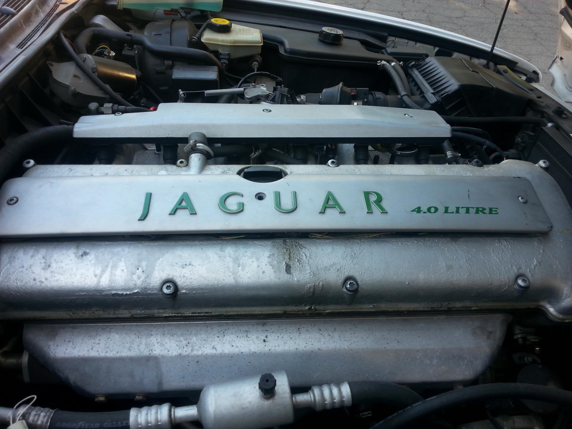

Default 2000-2006 Lincoln LS coils in my 1996 Vanen Plas
The LS coils can be bought on EBAY as cheap as $51.00 for 8 coils. I paid $8.50 for each coil. Just break off the mounting tabs like I did. It's very easy. I didn't like the way the electrical connectors fit. Even though you can make them fit by turning them upside down. There was too much cracking and crunching for my taste.
I went to the local "Pick A Part" scrap yard and cut the connectors off a 1999 Lincoln Continental. You can find them on so many Ford and Lincoln Vehicles from 1999 to present. Pretty much any of them with coil packs. Just cut your connectors off and splice them in. Don't be afraid to cut and splice. It's not rocket science. There was no charge for the connectors at the "Pick A Part" scrap yard.
I am extremely lucky that I read about bad coils before I spent money on other things like fuel filters and pumps,ECU issues,TPS and transmission diagnosis. I put these cheap coils in my Jag and she has been purring along ever since.
Before I replaced my bad coil packs my car was acting absolutely crazy. Idling high,low shutting off at any given moment,dash lights flashing like a Christmas tree, transmission limp mode light coming and going. The new coils solved all those issues. My car has been running perfect for 23,000 miles. If it acts up again I'm going to just replace all the coils before I do anything else.
The 2000-2006 Lincoln LS Coils are the ones from the V8 engine. Not the V6 engine.
I LOVE MY LITTLE KITTEN AGAIN. I MIGHT PROPOSE.

Glad to hear you have found a solution that works for you..... but I don't think I would go this route.
I see a few issues:
1) It appears that nothing other than friction and gravity is holding your coils in place. I would be concerned about wear/tear from vibration, and also continuity/connectivity reliability to the plug and harness.
2) Although you are correct that modifying the coil connectors isn't complicated, a lot of owners would be hesitant to cut off the OEM connectors from the factory harness. Citing decades of splicing wires in auto harnesses, I can attest that even the best DIY crimped or soldered connections are prone to failure from mechanical stresses (esp vibration) or inconsistent impedance, etc. For something as critical as the coil connections, I'd personally avoid cutting the wiring if necessary. Instead I'd recommend at worst a pro-built connector converter/lead (built by a pro or at least use professional AMP all weather connectors with the correct crimpers, etc). Water is your enemy with high voltage.
3) And on that note, since these coils are too high for the cover to seal (to be fair even factory it isn't water tight, but... ), the spark plug wells are more likely to fill with water. The valve covers have a nasty reputation encouraging arcing and corrosion already when the boots go bad, oil leaks, etc. So adding more water is probably less than ideal.
Apologies if that all sounds less than positive, but I'm not sure that this solution will be right for everyone. I agree it might be a good cheap temp fix in the event of an original coil failure though.
I also agree that there might be a cheaper solution out there on another make/model car that will work 100% and it would be great to find one.
.... or better yet, if we find a long term reliable, affordable and consistently available OEM style coil Seems like we can find 2 out of 3 at a given time.
