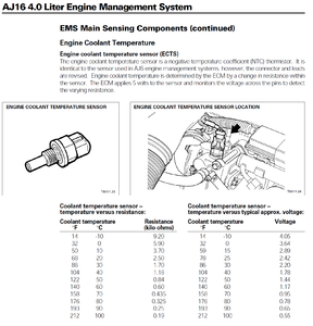

You can calibrate it against ice water and boiling water to see if part is bad .
