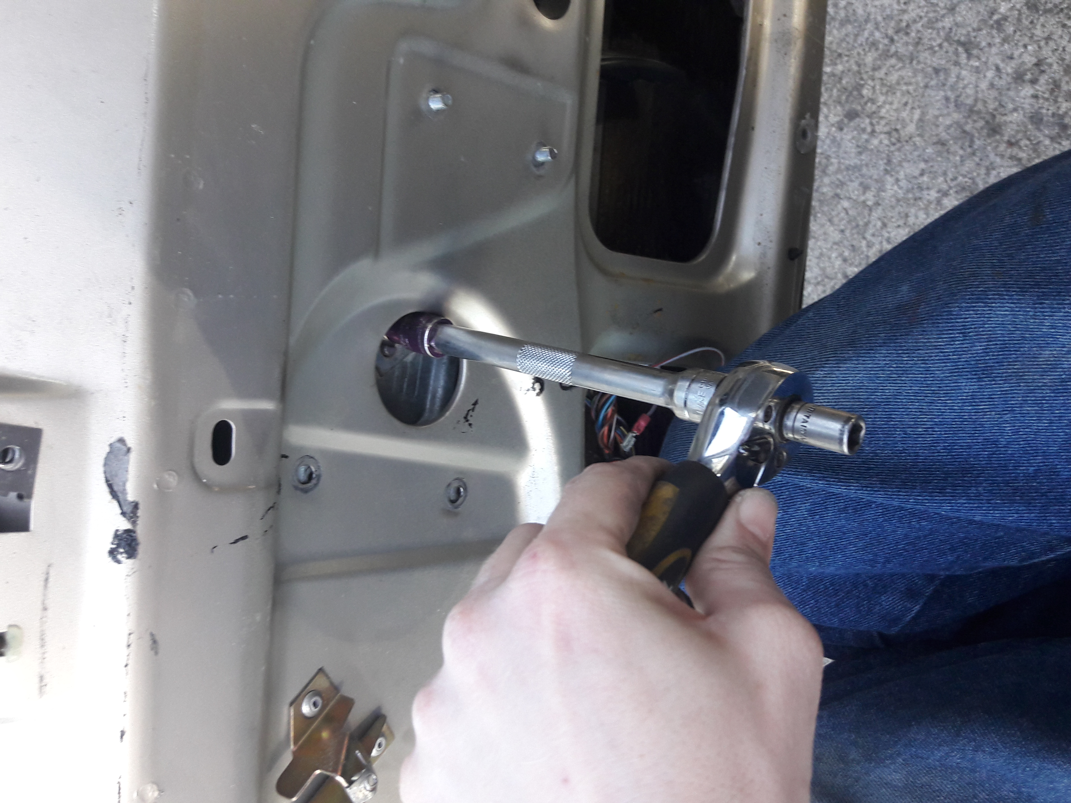

Remove the two 10mm nuts holding the window regulator on

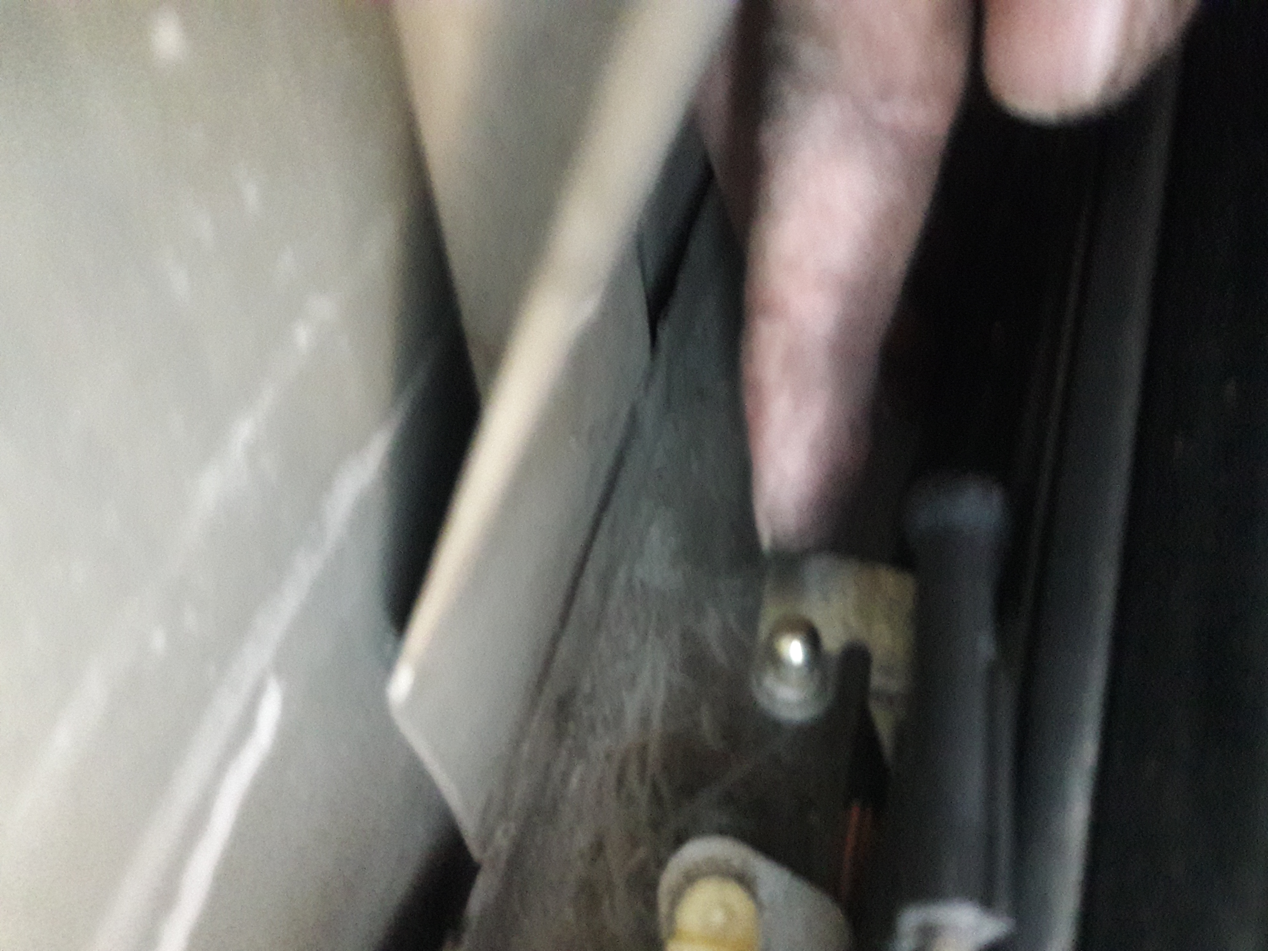

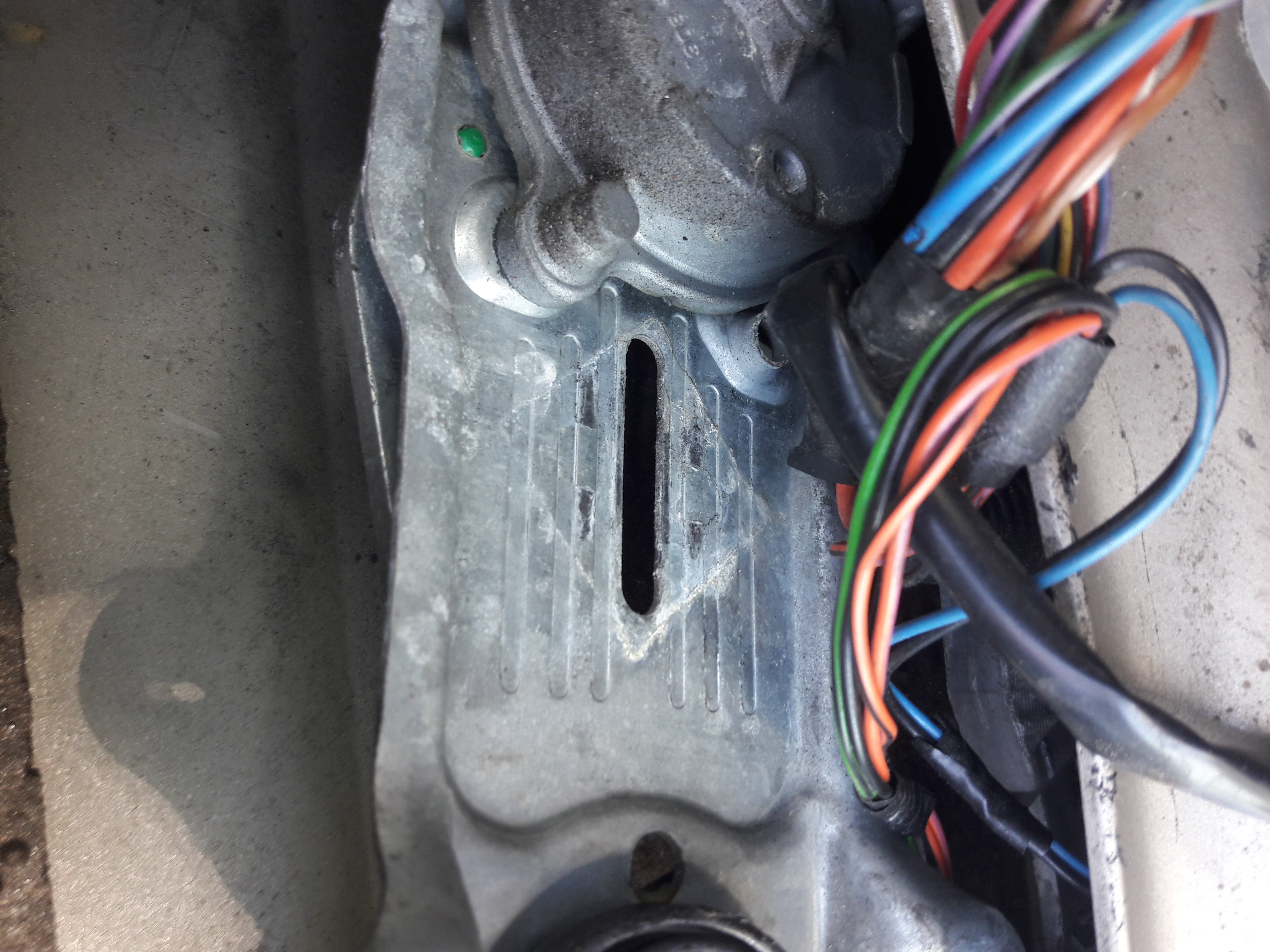

WARNING WARNING WARNING
I had removed this bolt to get mine apart ( i forgot to roll the window down before removal)
When re installing i could not get it to connect back in there? im completely stumped on wtf i even removed it from
I will post this because it is what i did and i had success ( so far)
Remove this bolt at your own risk
2nd pic is where the square peace sits that the bolt was clamping down

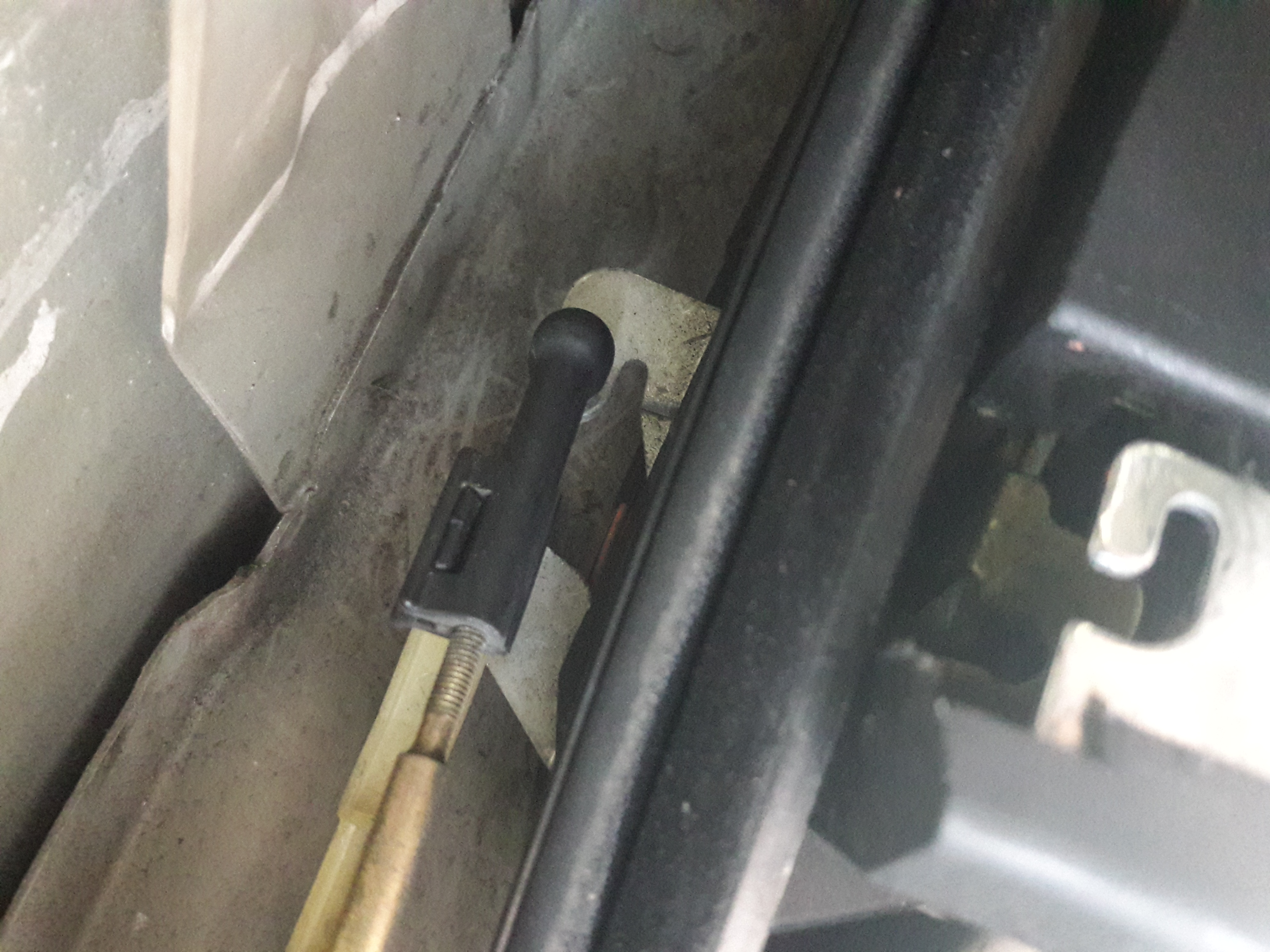

May 6, 2017 | 12:12 AM

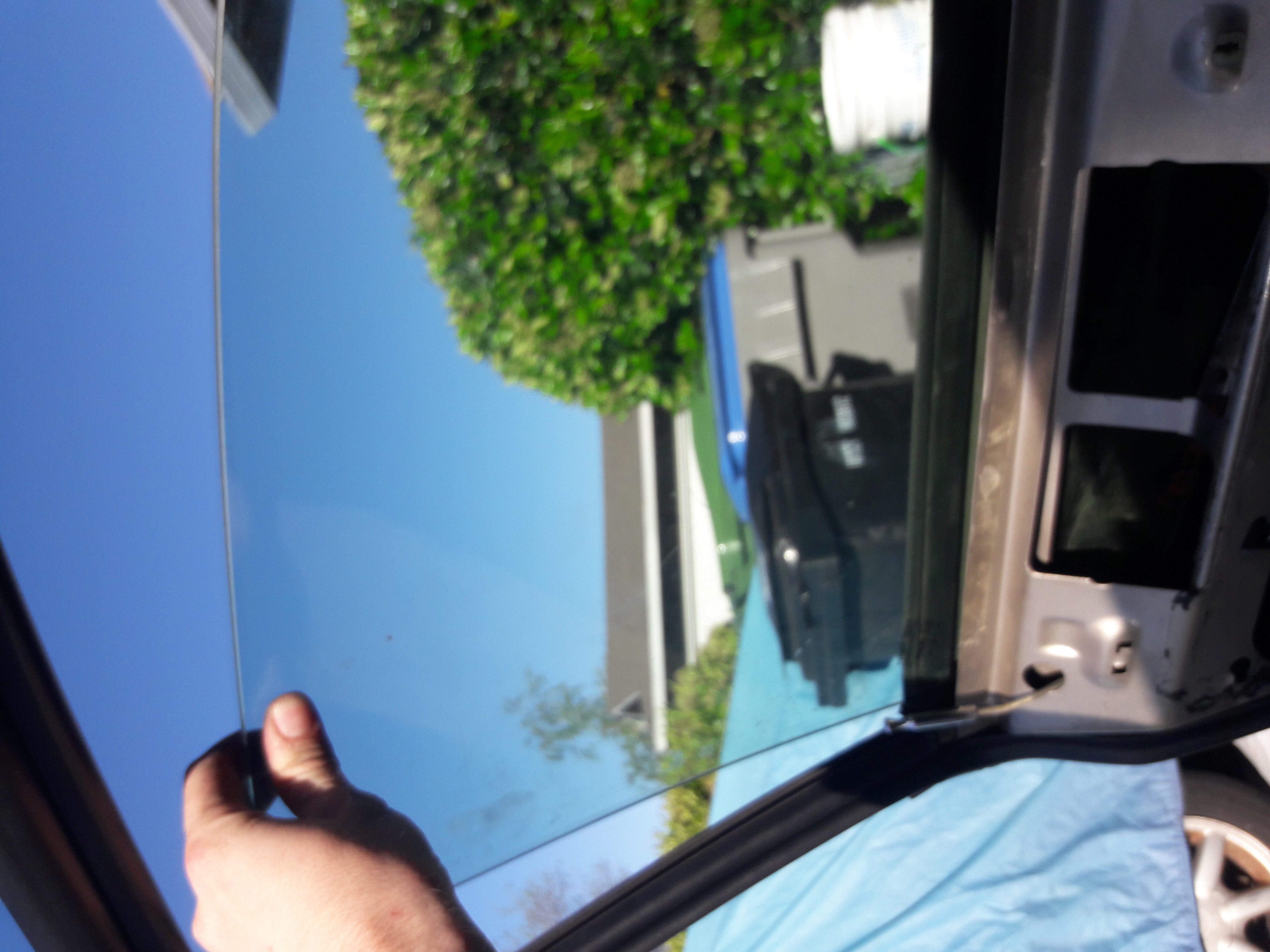

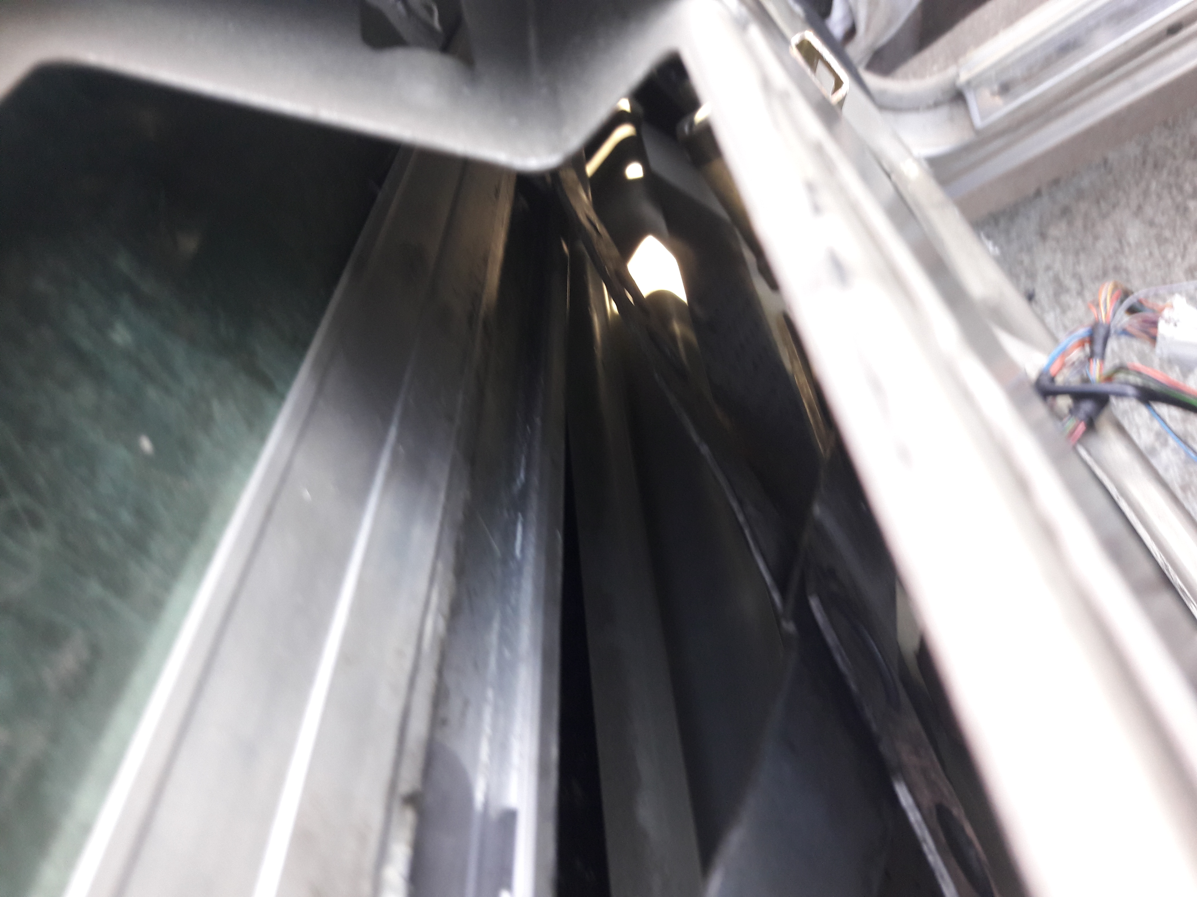

Now the trick is to wiggle the window regulator so that the slides that go into the window track come out.

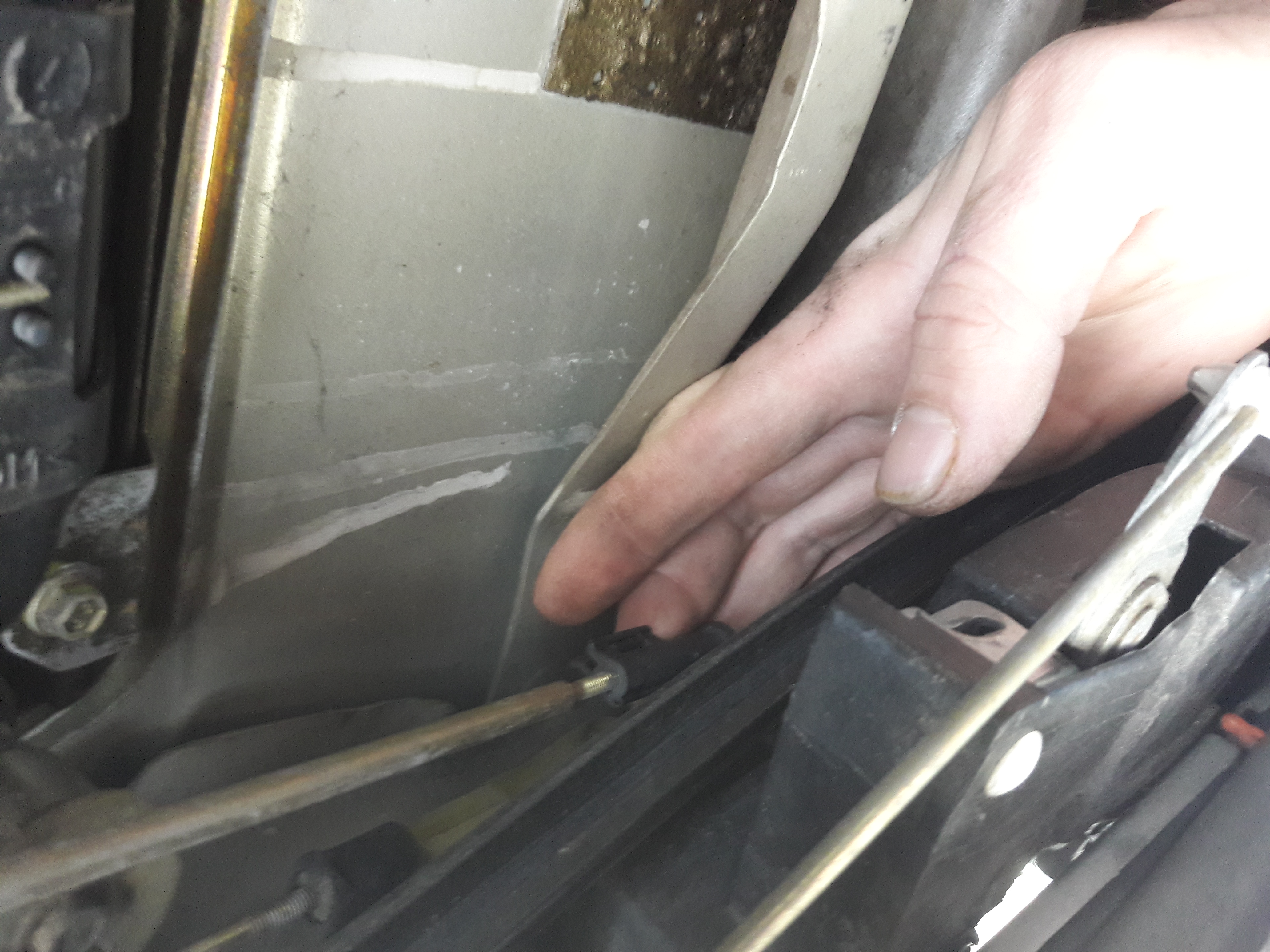

Time to remove the left side window guide ( bottom bolt only)
this will give room to remove the micro switch
its a t 30

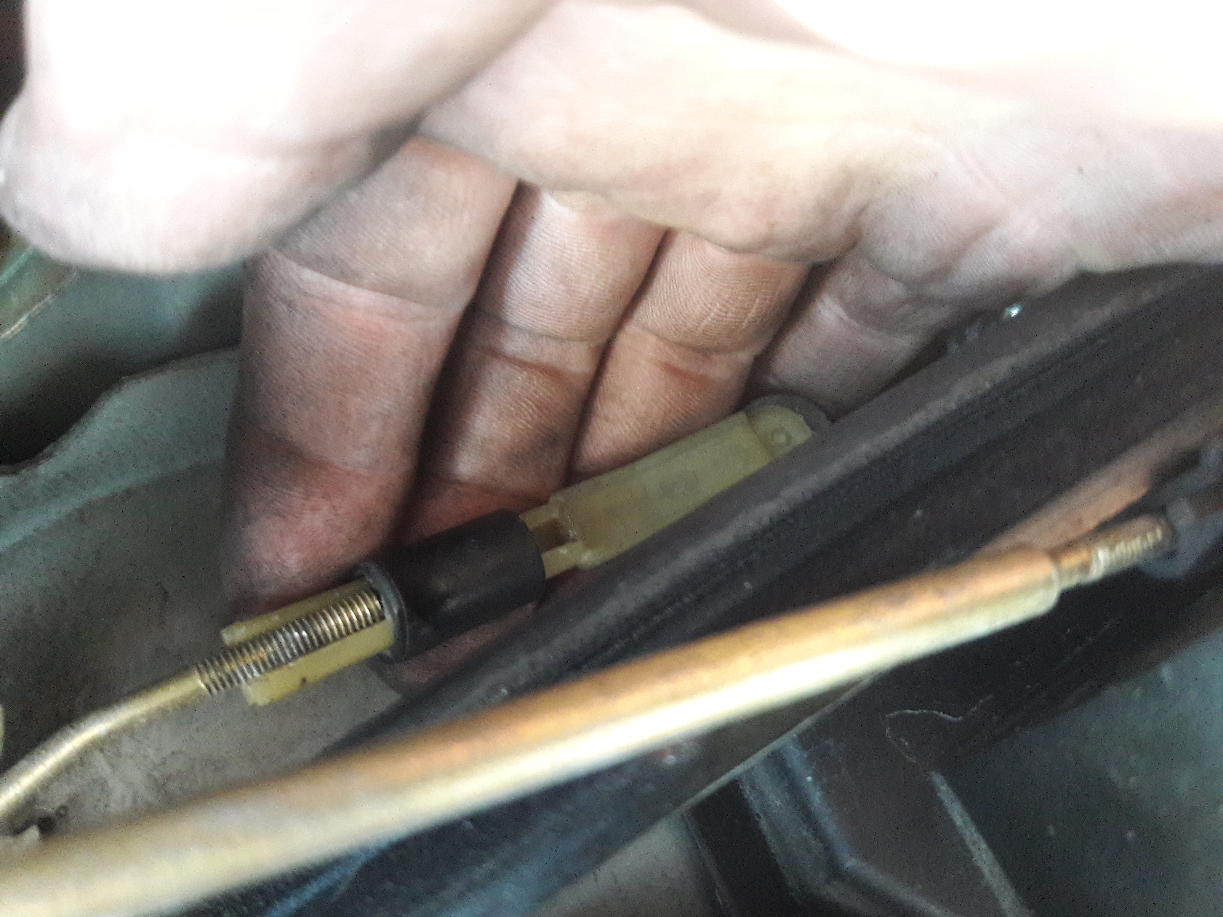

May 6, 2017 | 12:20 AM
Time to remove the
Micro switch and all the connections
Start with this connection. it just clips on and off. Pull towards yourself and it will come off.

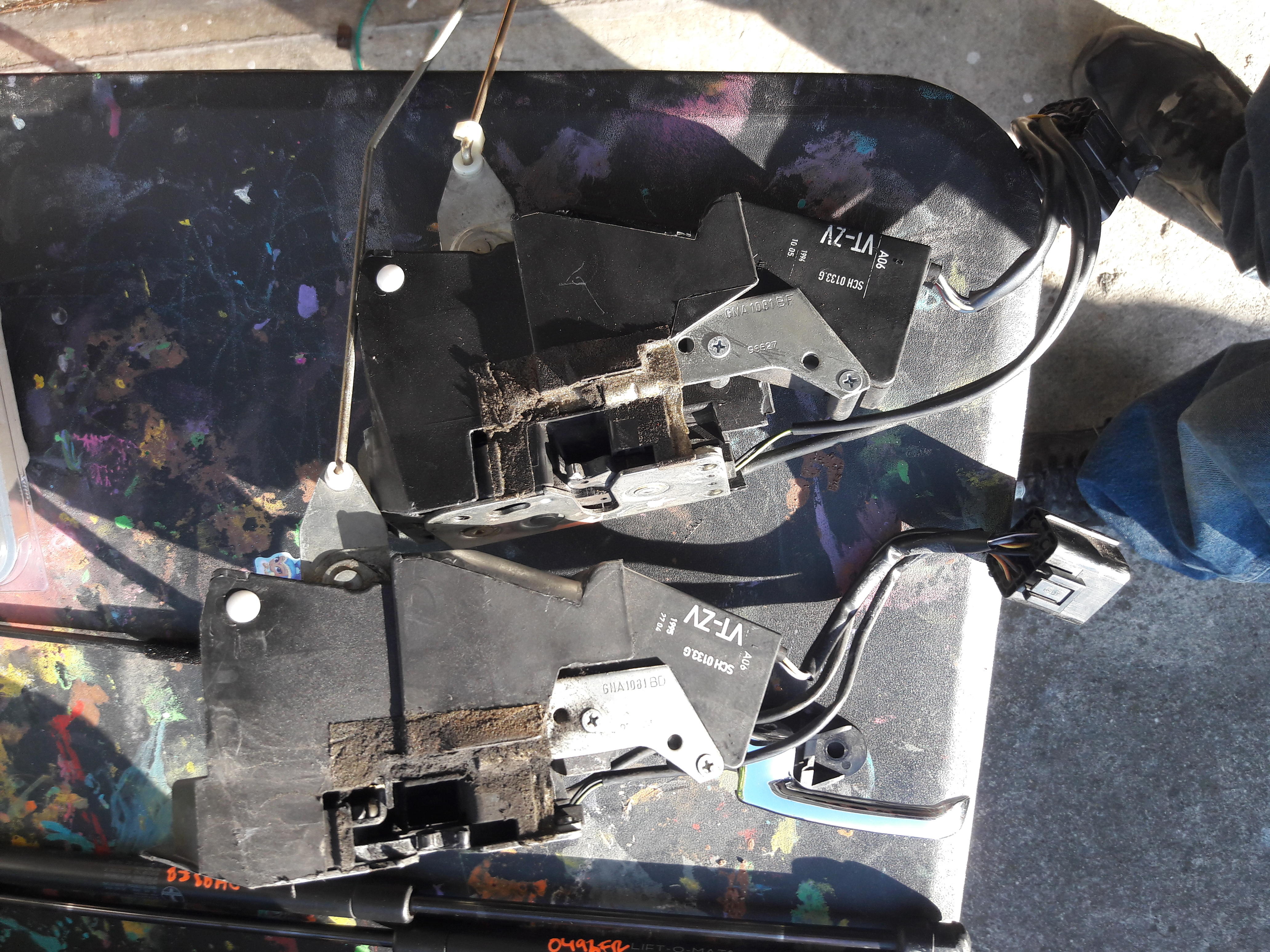

compare your old micro switch to the replacement
D.I.Y Front Driver Door Micro Switch And Door Cable Repair!-20170428_182220.jpg   D.I.Y Front Driver Door Micro Switch And Door Cable Repair!-20170428_182233.jpg   D.I.Y Front Driver Door Micro Switch And Door Cable Repair!-20170428_182306.jpg   D.I.Y Front Driver Door Micro Switch And Door Cable Repair!-20170428_182332.jpg
Reply 0
May 6, 2017 | 12:37 AM
  #30
Install is Reverse
Tips For Install
A) If the Replacement micro switch is in the closed position the door will not shut
To fix this simply install everything! From outside the car hold the door handle open and shut the car while holding the handle up! it will force the micro switch to unlock and let your car door shut

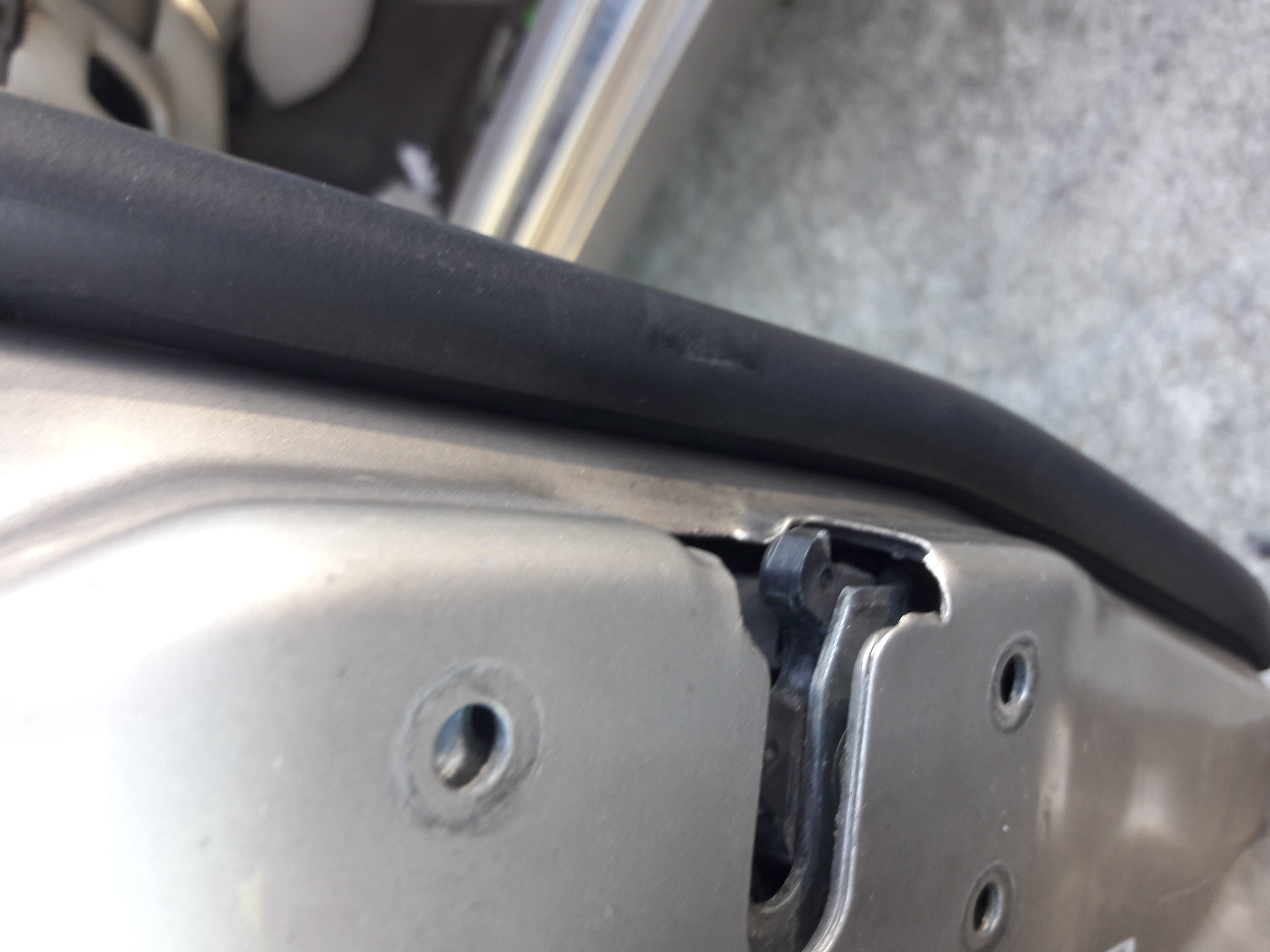

fixing door lock cable with a splice
I expected to have to take apart the entire door, but I found my cable break right next to the door handle.
I was able to hack the cable together to the L handle-end with a cable splicing sleeve and crimping tool.
Works for now... curious to see how long it lasts but it only took 1 screw to access (and removing handle wood trim).
