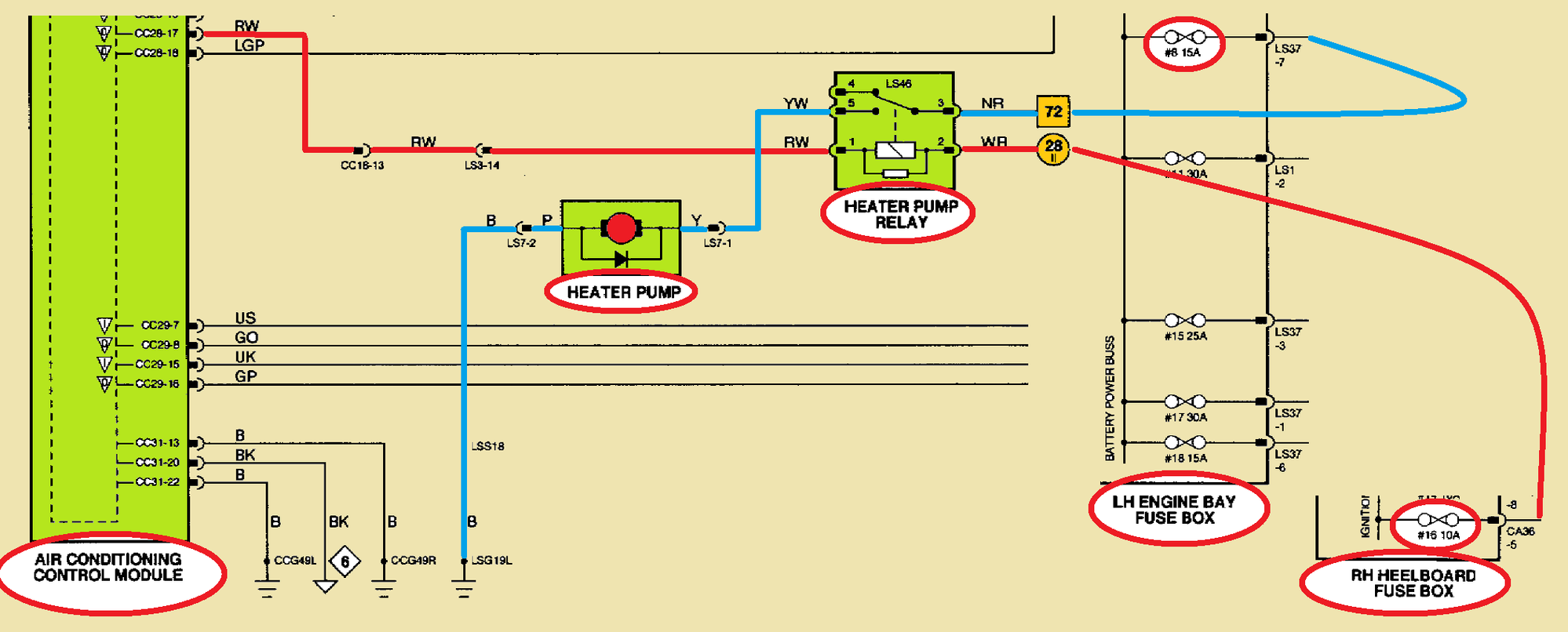

On my car, the auxiliary coolant pump was out, due to worn brushes. I pulled it off, found some R.C. toy brushes at the hobby shop, and replaced them. Heater worked fine after that.
Old Dec 13, 2022 | 06:54 PM
Parker 7's Avatar
Joined: Aug 2021
Posts: 4,641
Likes: 1,314
From: Kansas City
15" x .15" x .35" BRUSH 33A (eurtonelectric.com)
Odds are this , so might as well get them on the way to you
There are some relays and fuses involved
There is a climate control bite test in this video someone made , but it doesn't see everything but it does cover the bases
The writen steps are on page 110 of the Jaguar 703 Doc
www.jagrepair.com/images/Training Guides/703_SG.pdf
Codes are here
14-10 (jagrepair.com)
You can tap on the electric heater pump lightly ( rubber mountings ) and the brushes may come free to make contact but is a sign the brushes need to be replaced
