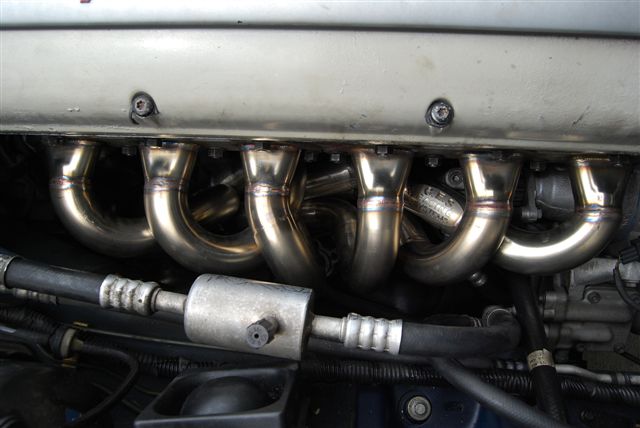

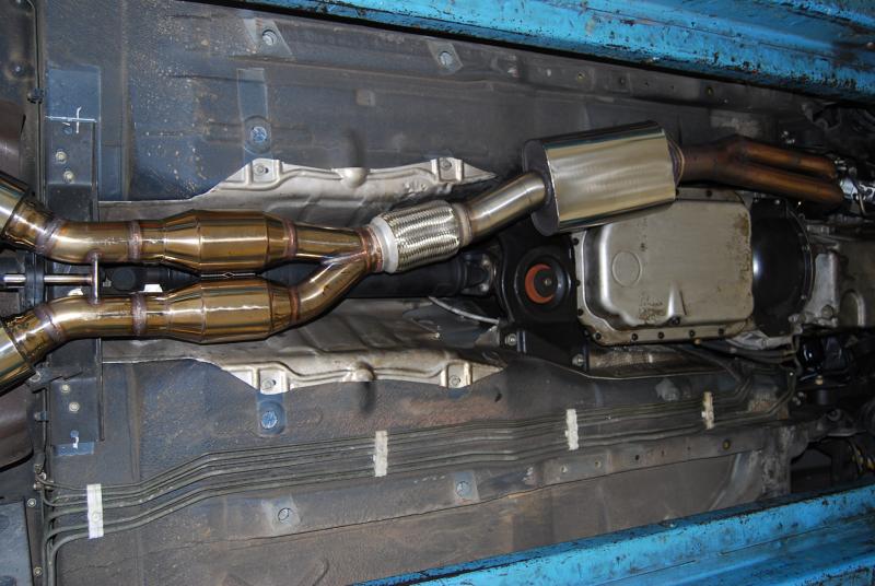

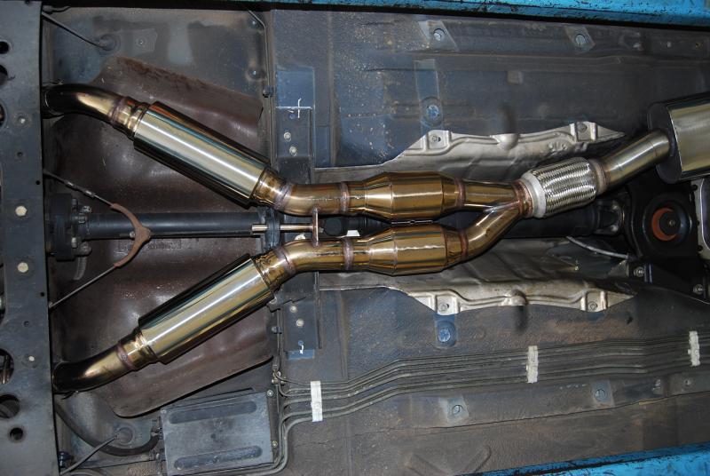

Default decats
I have removed the front cats and have a new pair under the floor where the old underfloor one where throws no codes
Attached Thumbnails Decat - potential issues-dsc_0033.jpg   Decat - potential issues-dsc_0098.jpg   Decat - potential issues-dsc_0099.jpg

You guys can get away with this because you have "two oxygen sensor cars". Those of us with "four oxygen sensor cars" ....North American market and perhaps a few others....would be looking at a check engine light :-)
