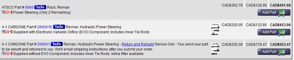

I'm about to order a steering rack from RockAuto, but it asks me to choose one of:
Now, I am not sure whether my jaguar comes with EVO or not - I asked mechanic to take a look, and he says it doesn't have one.
Can anyone confirm?

As far as I know ALL X300s have electronic power steering. I'll check my manuals toight if nobody comes along sooner to confirm.
(Not sure if the Jaguar system is "EVO" ---Electronic Variable Orifice----but there is some form of electronic sensing and calibration to provide variable assist)

Actually, in reading the catalog listing, I don't think they're asking you if the car does/doesn't have EVO. Instead, I think they offer the rack with or without the EVO control valve....which they're calling a "component"....and asking you to choose one way or another.
<shrug>

So you think it wouldn't hurt ordering the one with the EVO - and then if anything leaving it out?
