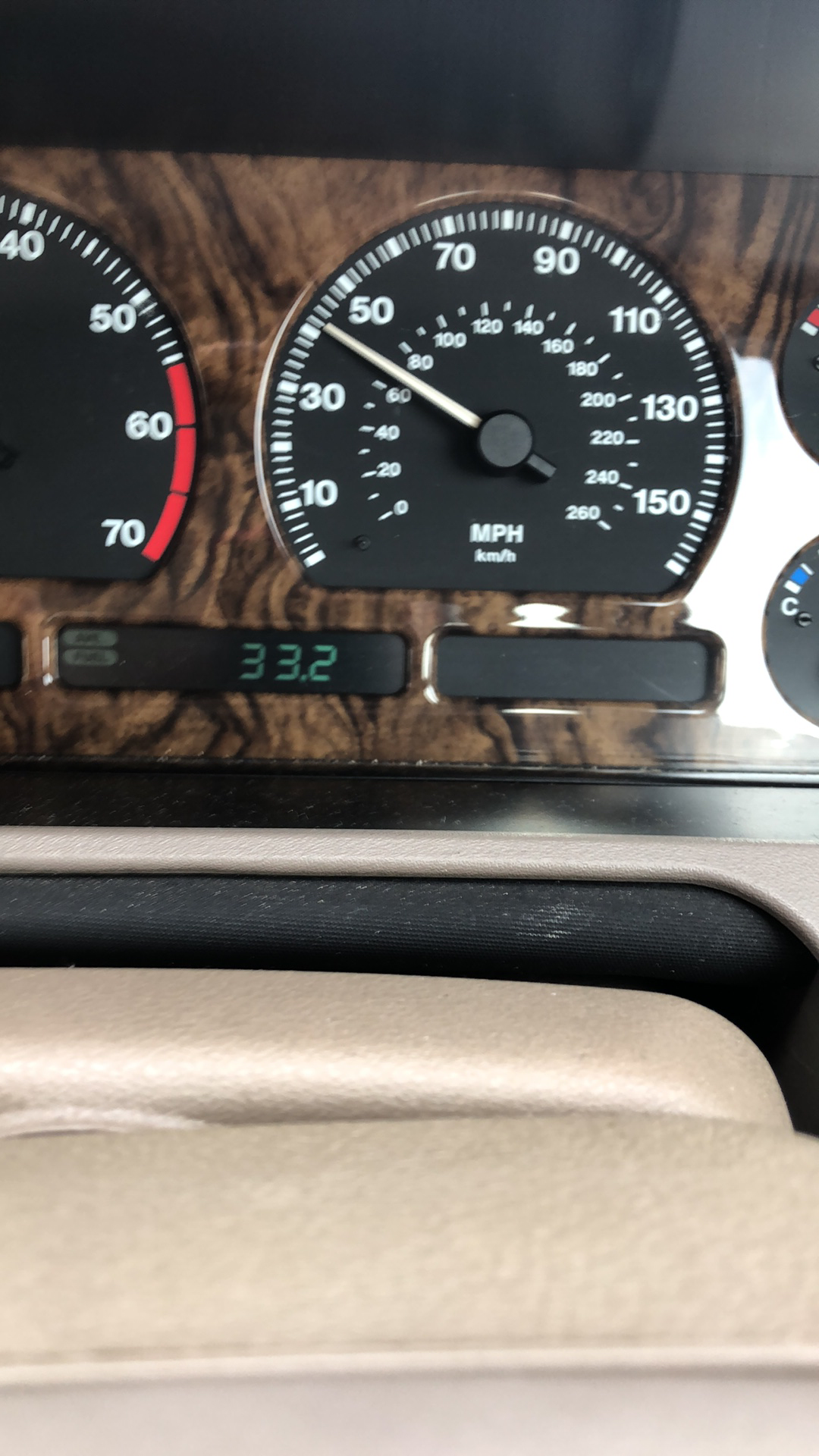

I’d been chasing the same issue for the last seven months and finally fitted a new o2 sensor on the near side as the mot had ten times the emissions it should have had !
after changing the sensor I now get over 30mpg on a good run and mod twenties round town !
and no more stalling now thank god but I do still get an occasional idle wobble when cold that I haven’t found
I suspect that it’s a vacuum leak or air leak to exhaust above the lamda sensors that seals up once the car is fully warm ,as after getting hot it doesn’t wobble at all at idle and is like a new engine

Now that is an impressive MPG and exactly what I need!
