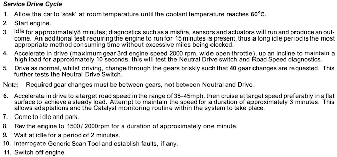

I went in for an emission test with the new XJ6, let it warm up for 15 minutes, and took it down, and I got a failure saying it was not ready. I did not drive it that far, but it was warmed up. The guy was saying that I needed to check what the drive cycle is. Does anyone have an idea what that is?

From AJ16 Electrical Diagnostic Manual:

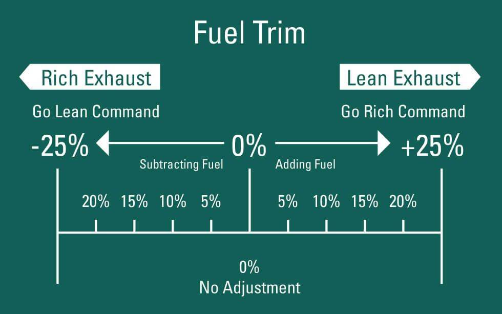

Before going back for a emissions test you can check short term fuel trim ( target 0.0 % ) that the O2 sensors are regulating , ELM - 327 device
The 0.0 % is ideal but not achieved in practice from reading others results , so + or - 3..0 % is not bad
This would ensure the fuel mixture is honed in or in tune which has a relationship with your final exhaust gasses with the condition of your cats as a variable
One of the things they look for is unburnt hydrocarbons ( too rich ) , and nitrates , a function of the cats if feed the proper gas concentrations to convert and the cats efficiency
