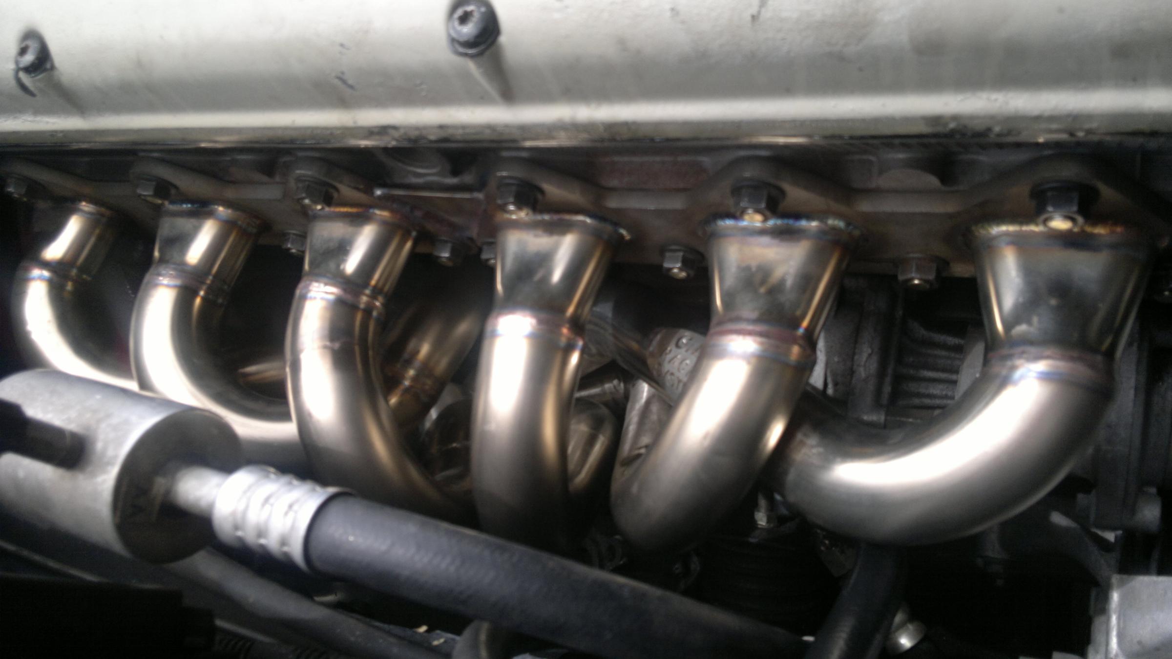

I actually make the headers from a expert design direct fit 304 stainless steel but they are not cheap
I spent close to 10 grand developing and prototyping them
If you would like more info just private message me
I to got sick of repairing the headers I spent 3 grand on repairs and replacements before I made the full system for my car
No problems for 2 years and 40,000 k,s couldn't say that about repaired or replacement ones they lasted an average of 9 moths each time

Headers alone don't make a sound difference they might if they where paper thin but the one,s I make are 304 stainless steel the sound they actually make is quiet no sound at all (LOL)
Its the exhaust that makes the sound my headers are a direct replacement fit to the single underfloor pipe they have the O2 sensor bungs but have no front cats as they are tuned length and having cats at the front will not make them tuned length
I have tried to video the system last time I had the car dynoed but the sound just distorts very badly so is useless
I will do another dyno run just as soon as I figure out why the throttle is sticking
I have attached some pix of my car with its system
A bit of overkill but I don't plan on selling my car ever
I have basically rebuilt it since 2008 so its not worth selling
I am planning to put it into storage as I believe the XJR cars might be collectable one day as they only made the S/C AJ 16 engine for 2 years before going to an 8 cylinder engine
I did learn a lot doing this exercise I.E. I used a 2.1/2 inch pipe split after the single 3 inch out of the headers
I should have gone for twin 2 inch and instead of 2 catalytic converters with 2/1/2 inch diameters I should have used a single 3 inch catalytic converter and instead of twin 2.1/2 inch resonators I should have used a 3 inch inlet to twin 2 inch outlet like this muffler Dynomax® Performance Exhaust | Mufflers | Dynomax VT™ Muffler
My logic was that being supercharged it would need to breathe well twin 2/1/2 inch is to much the drone is unbearable that's why I have 3 mufflers under my car to quieten down the droning
When I did my car no one had done a full system on one of these cars so it was an experiment that's why it cost so much for my system knowing what I know now I would have done it differently single Cat single VT dynomax resonator and twin mufflers at the rear large diameter engine pipe after headers then twin 2 inch pipes for the rear mufflers
I could have used of the shelf products instead of all hand made and designed a significant cost saving
All knowledge I am happy to share
I searched for years for headers before I finally bit the bullet and did my system I was sick of cracked headers and the associated cost of repairing them also when the cast headers crack the car sounds like a piece of crap embarrassing when you are at the lights
Attached Thumbnails Exhaust manifolds - argh-27092011089.jpg   Exhaust manifolds - argh-dsc_0088.jpg   Exhaust manifolds - argh-dsc_0098.jpg
