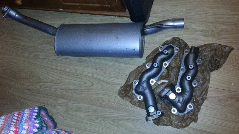

Old Dec 18, 2013 | 04:49 PM
  #35
theJPster's Avatar
Posts: 228
Likes: 64
Decided to buy genuine. Here's hoping they'll never need changing again!
