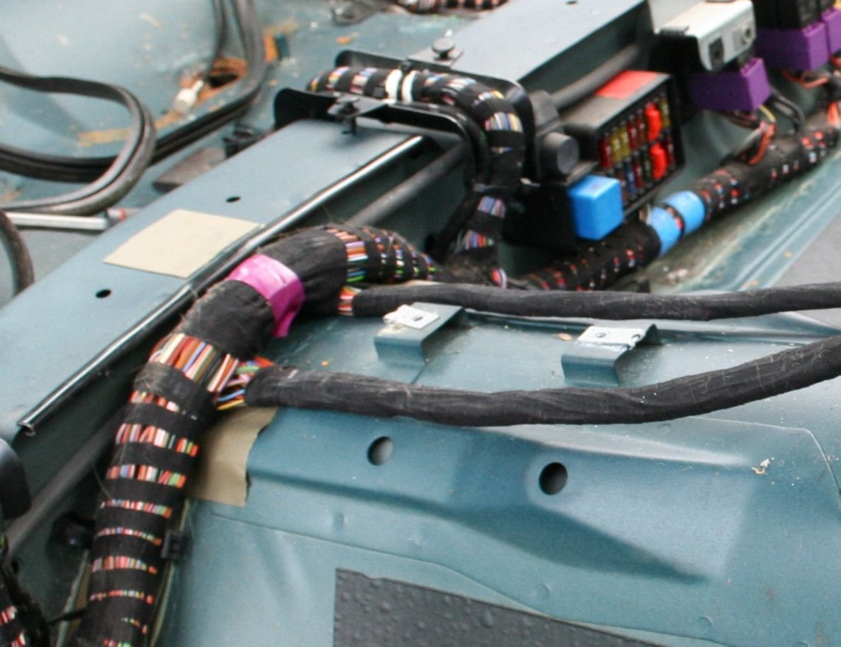

I did this a long time ago so memory is fuzzy. There are 2 screws that hold the extension to the tunnel. You will need to remove the veneer panel and the leather panel to access the screws.
I think the veneer panel is glued to the extension, but was easily removed without damage if treated gently. I thing it has a steel backing.
Here's what the tunnel looks like underneath, showing the spire nuts that the extension is screwed to.

That’s exactly the info I was looking for. Thank you very much for taking the time to educate me and provide a photo. I was too scared to try and pry up the veneer but will give it a careful go.

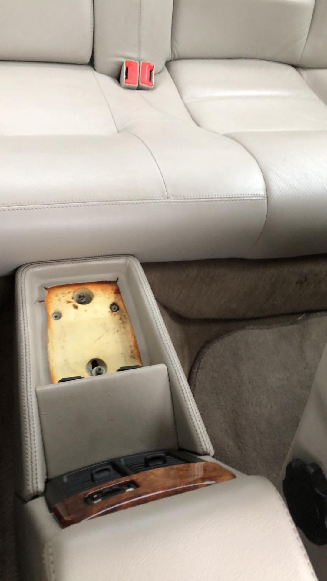

There it sitting loosely

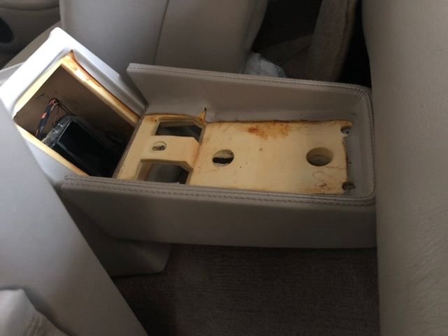

I’m trying my level best to remove the extended console but haven’t had any luck at all. The wood veneer is well below the surrounding edge. When I try to pry the wood piece, the surround is flexing and the finished wood piece isn’t moving. Tired to remove the piece with the heated rear seat switches and it doesn’t want to budge either. I feel I missing something and that if I keep up I’m going to damage the parts I’m trying to preserve. Any more advice on how to get the console out is much appreciated.

It was just matter of finding the right tool and it popped off with almost no effort!
