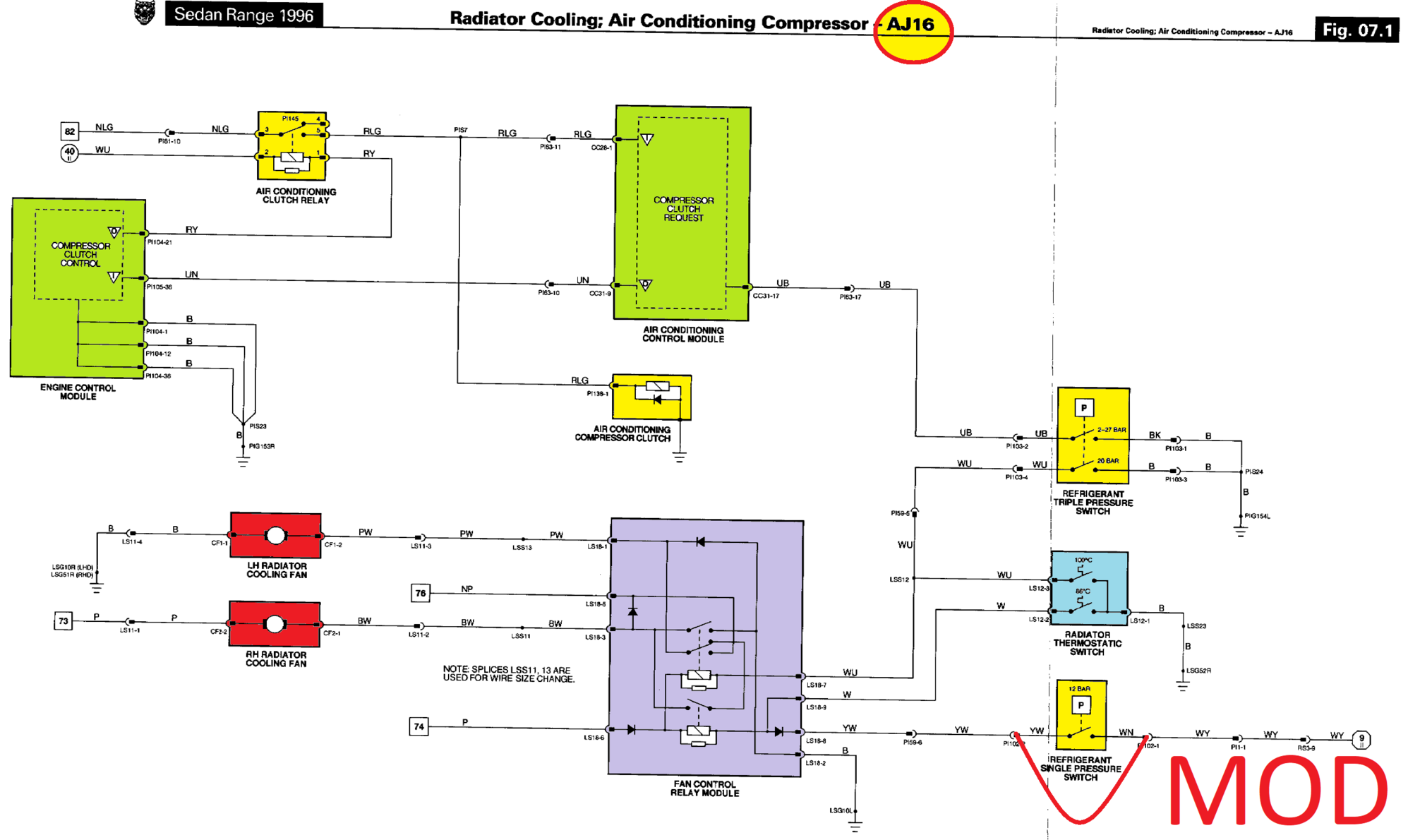

The white coloerd fan control relay for the X300 is not interchangeable with the black one for the V8 X308
To test the relay remove the 3 wire connector on the rear left lower radiator , coolant temp switch and not a sensor like on X308
Jumper with a paper clip one white wire to the black and you will tell the relay to close for one or both fans running modes
remove the paper clip and jumper the other white wire only to the black wire and you will get the other one or both fan running modes
This is a low power control circuit so no high amperage arcing
make sure the relay is not hanging upside down or water can enter the relay ruining it
the relay connector should be facing down
the large fan control relay is under the car forward of the left front tire

OK so now to add another layer on the coolant fan operation
The second way the fans are triggered on other then the coolant temp switch is the A/ C freon pressure switch
Once the 2 wire low ( normal lower operating pressure ) pressure switch sees that you are running the A/ C it will command the fan control relay to run one fan
The other 4 wire Freon pressure switch is a higher Freon operating switch where 1/2 of the switch commands the fan control relay to run both fans
The other 1/2 of the 4 wire switch is a over freon pressure switch which will unload the compressor clutch
There was a Jaguar TSB to modify the cooling fans that may or may not have been done and this would effect when the fans turn on
The mod invollves removing the connector from the 2 wire low pressure switch and installing a jumper wire between the 2 wire connector
If you do not have this I have an extra factory jumper wire that clips into the hanging connector
Sometimes you will find the low pressure switch removed leaving the 4 wire pressure switch but is not necessary as long as the freon line is sealed from leaking with the switch body in place

Thanks, I didn't get chance to test the relay over the weekend due to the usual commitments and the option of another car to get to work, but it has been working normally consistently now running around over the weekend and to work yesterday / today. A useful diagram to have - as the ac has not worked for along time with the clutch not engaging which I have put down to low gas pressure and likely leak given the age of the system. I might see about getting it refilled but not sure if I need it fixing and the there is a long list of higher priority jobs on the car!
Anyway back on topic, if I needed to get the fans running in the event of the switch or relay module failing, could bridging the two wire ac switch do the job?
I realise that the best course of action is probably to replace the switch and relay, which I may well do.

In the end the TSB mod to put a jumper wire on the 2 wire low pressure switch will keep the one fan operation running at all times
But this requires the Fan Control Relay Module to be working properly
To run the one fan directly you can obtain plenty of power from the left engine bay fuse box positive terminal post with a small alligator clamp but a decent sized wire gauge
