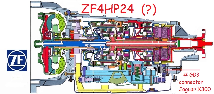

The transmission for the 3.2 L engine is the ZF4HP22 with old school fluid logic shift control and the 4.0 L is the ZF4HP24 with electronic shift control . Both same hardware as long lasting and reliable used in BMW's and others . About the only issue is the electrical connector on the transmission body gets corroded of contaminated . The 4.0 Supercharged and V12 engines use a GM 4L80 - E

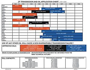

See page 136 of 521 in the below Doc . Too big
See page 4 of 74 in below Doc :
See if there is a superseding Jaguar TSB on the fluids as there are on the engine coolant

Attached Thumbnails Fear of Transmission Fluid Change-jaguar-xmission-untitled.jpg   Fear of Transmission Fluid Change-zf1999chart.jpg

The ZF transmission in your car takes Dexron III. Brand doesn't matter.
Like most automatics, there isn't a drain plug in the torque converter, so you'll only be able to change the oil in the pan, which is about 3-4 litres out of the 8 in the transmission. I usually do a change, drive for a week, and repeat 3 times in total. That gets it to being mostly fresh oil in the transmission.
