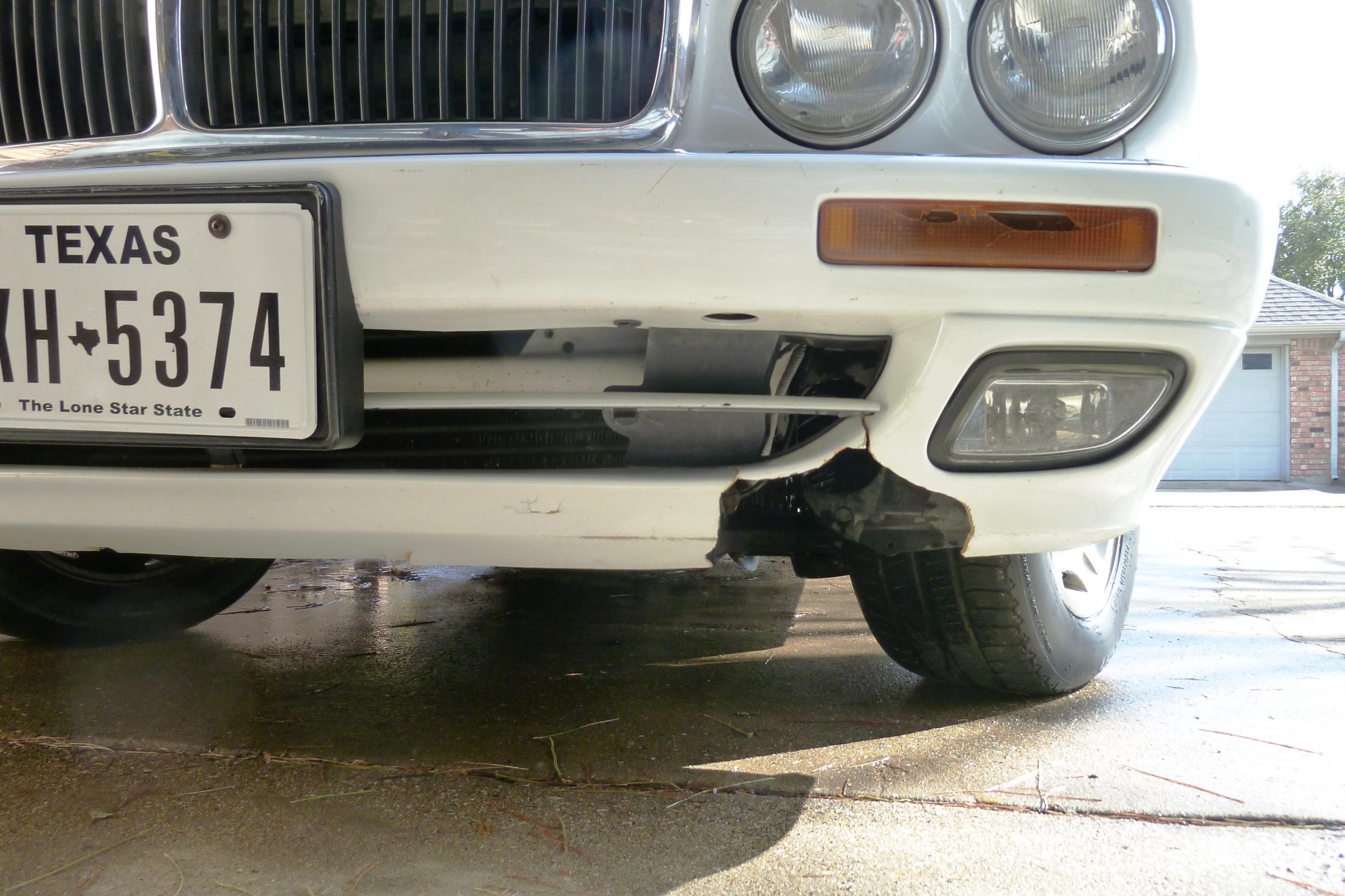

Hi Everyone...
A recent snafu at a "big box parking lot " with a "concrete stop" with and Iron tie rod sticking up too high damaged the front left hand underside of my bumper. So now I'm trying to figure a way to fix it. See attached pic here..
Does anyone out there have any idea how to do this.... ? I can't seem to source a replacement bumper for my 1997 XJ6 (X300)... I have not seen any posted on eBay
Thanks
BigBoss in Dallas TX

Hi
Thanks for the reply.. unfortunately I don't have the missing piece.... So I need to find a way to fill in the missing part.

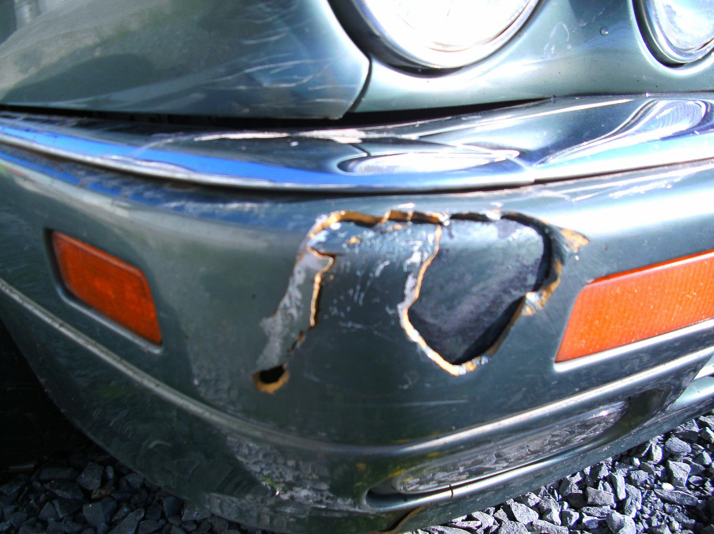

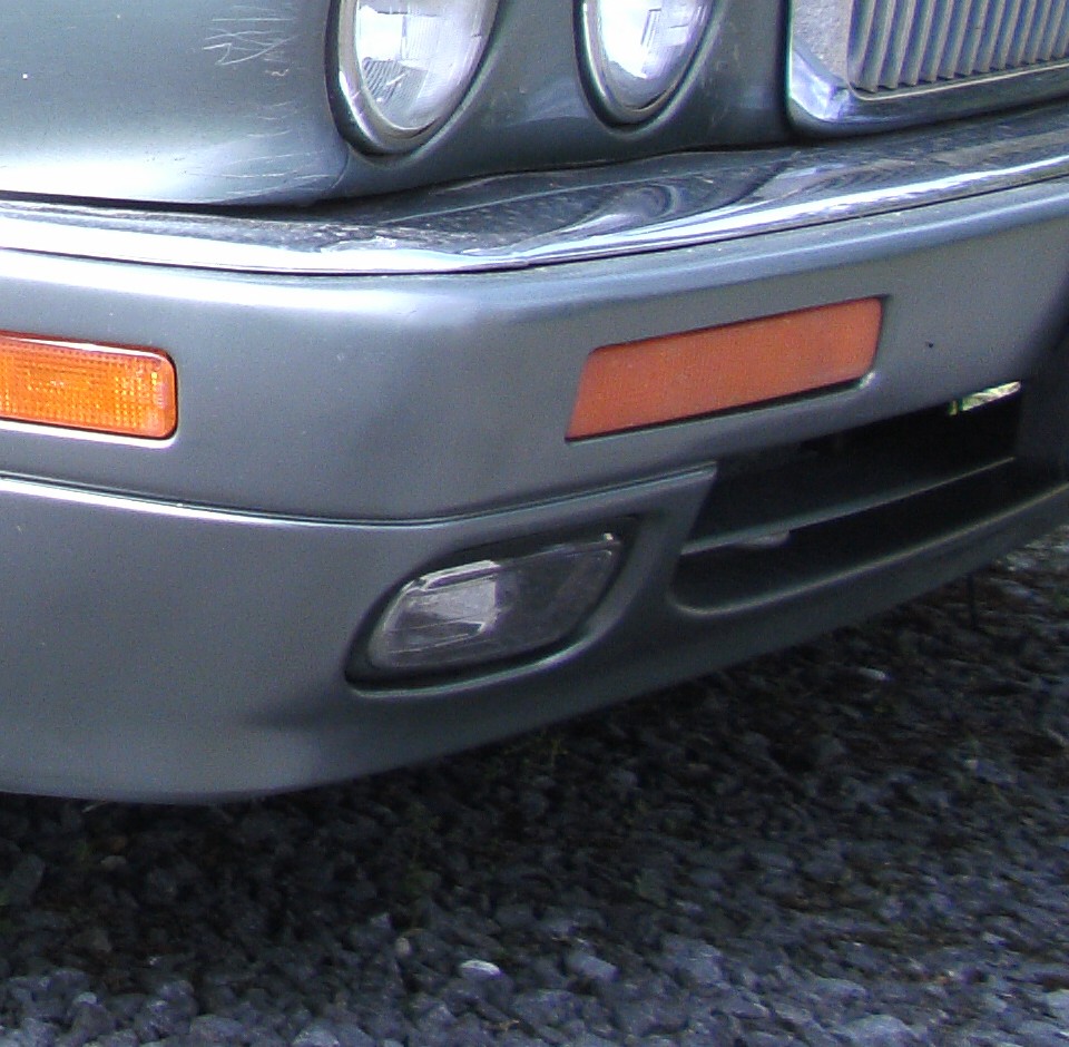

Originally Posted by BigBossRadio
Hi
Thanks for the great advice... I see you are in Ireland... I'm from Waterford many years ago. Can you remember what type of mesh and filler you used you used.
Thanks
BigBossRadio in Dallas, TX
Any good motor parts shop should have repair kits as described. The mesh is a fine aluminium "expanded metal" type of construction and normal body filler will do, but there I also a plastic type filler with more flex available. Usually used in fibreglass boat repairs. When painting, use a plastic primer (sometimes clear ) as opposed to the normal grey primer.
The attached pics just show "before and after", but I had to remove the bumper and then the cover to do the repair, as the damage was inaccessible. In your case, as mentioned elsewhere, leave the bumper in place. Much simpler and less likelihood of flexing and damage when refitting. Hope this helps.
Attached Thumbnails Front Bumper Problem-bumper-1-before.jpg   Front Bumper Problem-bumper-3-after.jpg

Hi Sogood
THanks for the reply, I like the job you did, nice work. I am going to pursue your course of action but I think it will be easier to just take off the bumper and do the work in the garage. Now If I could only figure out to take it off I'd be set.
