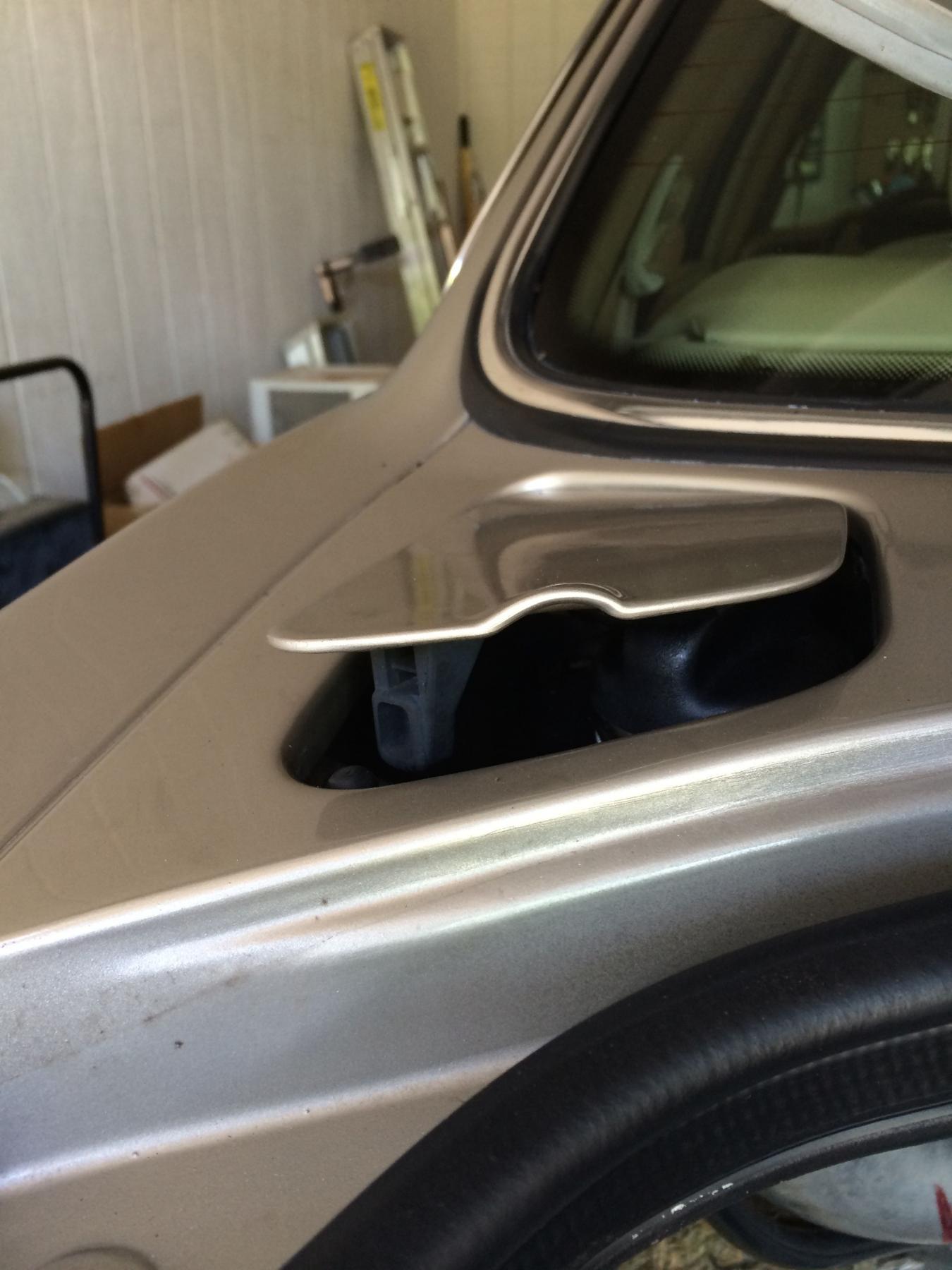

Exact same happened to me today!!! Noticed the fuel flap was sticking up and wouldn't close because the cap was too high. Whipped out the carpets and lo and behold the tank has completely collapsed on itself!!! It was so caved in that the retaining straps were completely loose!! There had been absolutely no drivability/starting issues up to this point
Don't think that it will be easy to re-inflate so I'm on the lookout for a used tank. Will have to check the whole evap system too
Actually it's pretty scary as it looks as though it could rupture at any moment!!
Here are some pics

Allan. if that car was blue I'd swear it was mine.
what I did was stick my air compresser blower hose in the top valve, amd blew it back up.
I had to have somebody hold down the tank cap. 1st try worked ok. but my tank was on empty. what I did which is probbaby really dangerous was fill the tank as much as I could and did the same thing and it blew back up to its original shape.
my problem ended up being that I installed my new Rochester valve backwards.
fixed it all and no problem. then a week later some lady crashed into it while parked and totaled it.

Shawn,
I think I will try your technique first and see. I am a bit concerned about the structural integrity as there are some pretty significant creases but it's worth a shot. The tank is about half full so I'm sort of in no man's land.
