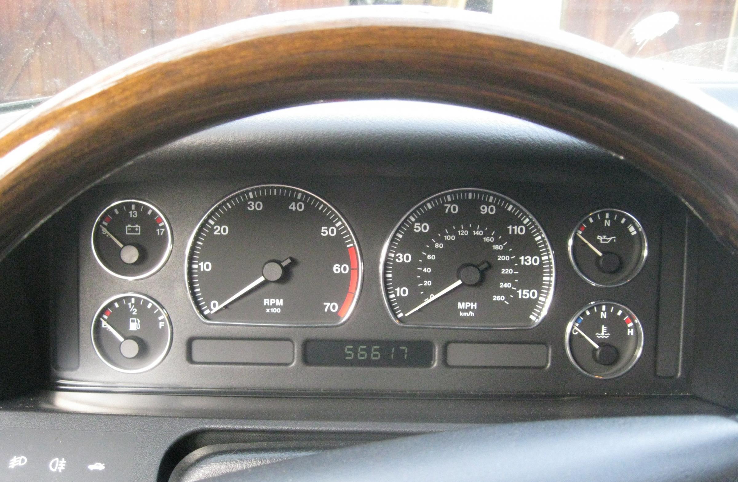

The four accessory gauge rings (battery/charge, coolant temp, oil, fuel) all fit perfectly. Both the speedometer and tachometer rings required some light filing around the perimeter of the gauge fascia speedo/tach openings to fit. Once popped in, and per the instructions "rolled" so the barely protruding rear lip curls and flares into the hole, the rings are securely fitted without glue. They aren't going anywhere once fully installed.

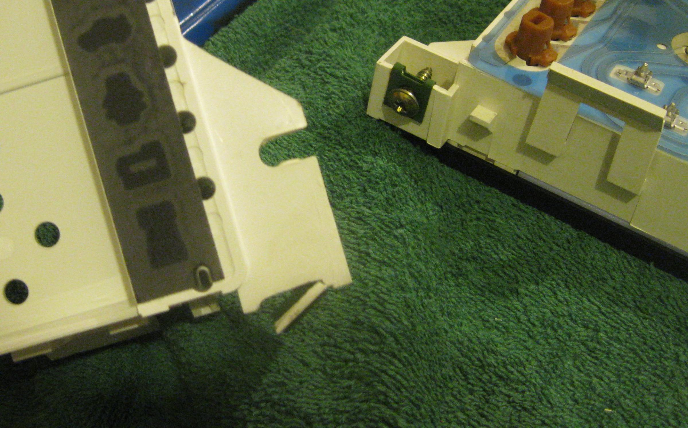

I also had to replace the white "frame" that holds the gauges and lighting as a previous "mechanic" had overtightened the screws sometime in the past and broken the plastic. Good thing I had that salvage cluster, as it was an easy donation and swap to move everything over including the back programmable cover, odometer module and flexible circuit. I then reinforced the donor's mounting area with some JBWeld so it should be a bit sturdier in the future and hopefully not fail like the previous unit.

Here's a photo with the gauges backlit, not night but late afternoon:
