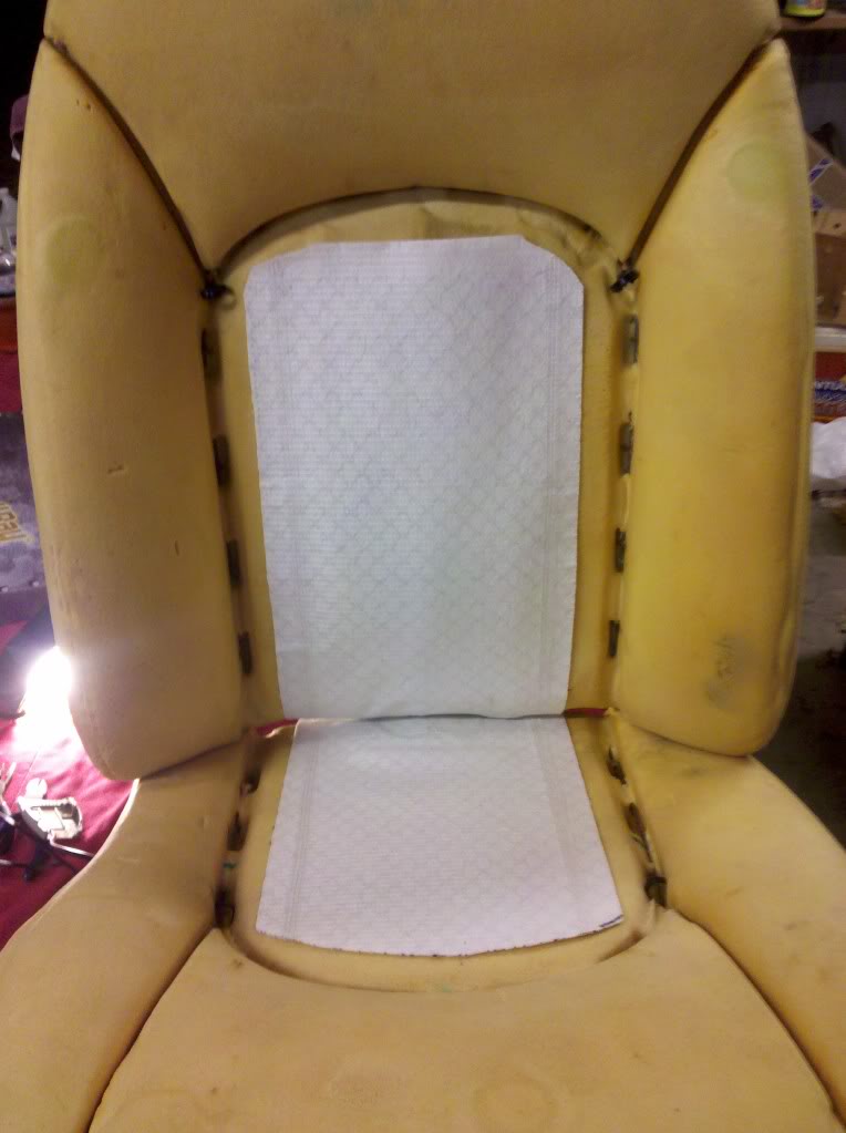

Doug, how did you handle getting past the wire/hog-ring fixing the piping demarcation between the "butt-section" of the cushion to extend the blanket over the thigh section?
I used a "ceramic" kit, I believe it was and just trimmed the bottom cushion blanket around the radius shy of the embedded wire. The OEM has notches cut to allow for the hog-ringing. Based on the limited tech-info available for my aftermarket blanket, I was not persuaded it would remain functional if I tried to notch it...but heat under the thighs would be a welcome addition to that provided to the cheeks.

It was years ago so my memory is foggy. I have pictures posted within someone else's thread that might help.
As I recall, however, the way I got around the issue you mention was to simply not extend the new blanket into the thigh section. I recall being a bit unhappy about having to do this but the offset was better overall heater performance and saving a huge sum of money versus buying Jaguar replacement blankets.
I also recall wishing that I had an assortment of various length/angle hog-ring pliers rather than just one.

OK, similar to what I did:
