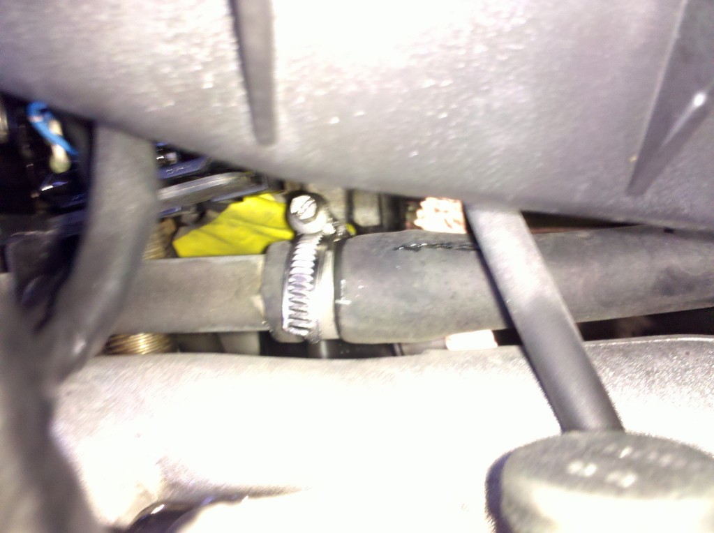

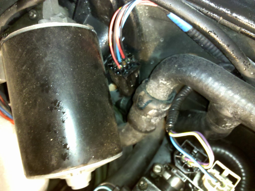

Wed. is my assigned day to fetch the li'l kids home from school. Enroute on US 380 @70 mph, maybe even a bit north of that, I notice a red WCA on the dash that I deduce to be the low coolant light. Temp checks good, no smoke in the mirror ...hmmmm.......already a coupla miles past the divert to home...trying to mentally construct how I could come to low coolant - could be stuck sensor - but would probably have to get low to stick and has been good since last fluid renewal. Got caught at the Devon traffic light and caught a whiff of glycol "Ruh roh! It's real, wonder how bad?" Getting into town, now and I decide I'll keep a sharp eye on the temp guage and proceed to IGA (on the way) shut down there for a look-see, and let her cool a bit while I hoof it over to school for my daughter (son out sick today) I figure I can buy some distilled at IGA and nurse it the 5 miles back home. Li'l bit is quite surprised to see me sans car, but we proceed afoot back to IGA, and pop the bootlid for her backpack "Ewwwwe....it feels oily, daddy" and she's correct, the whole rear end is slathered in glycol. I pop the bonnet for additional cooling, look around, poking and prodding a bit more, and I conclude the leak is toward the back of the engine and centered or just left of center, based on all the water trails. We beat-feet on into IGA and purchase 4 gal distilled (for the car) and 6 gal purified (for coffee) and return to top-up with distilled. As I'm pouring it in the top, I ask my daughter to look underneath and see if it is leaking out. "Yes, it is." Thinking she's just fooled by the puddle under it I probe further, "But it's not dripping, is it?" "Yeah, pretty much" and about that time I spy a little stream sprinting out from the left front tire, making a break for freedom! Crikey, we mayn't make it 5 mi home on this top up then...and buttoned it up after adding about 7 qts of distilled. Got the low coolant light at about 1/4 mi but limped on out to 380 and beyond the traffic light before pulling aside for another top-up. Now we have one gal and a bit left of distilled and I reckon we maybe got one minute, 90 sec max of run time before the re-emergence of the low-coolant light. Still, temp is good, though I'm aware it may also be highly inaccurate with NO coolant, so I run a bit longer to crest the hill, then shift to Neutral and silence the mill. We coast down beyond Cuba road and claim the shoulder prior to the bridge. Top up with the last gallon and bit of distilled..(Lil bit: "That's all the distilled, you think we'll make it this time?" "Yes dear, but we'll employ the purified if need be." and we finally wrestled it home. Found this on closer inspection after things were cool enough to touch:

and the other end hooks up here:
