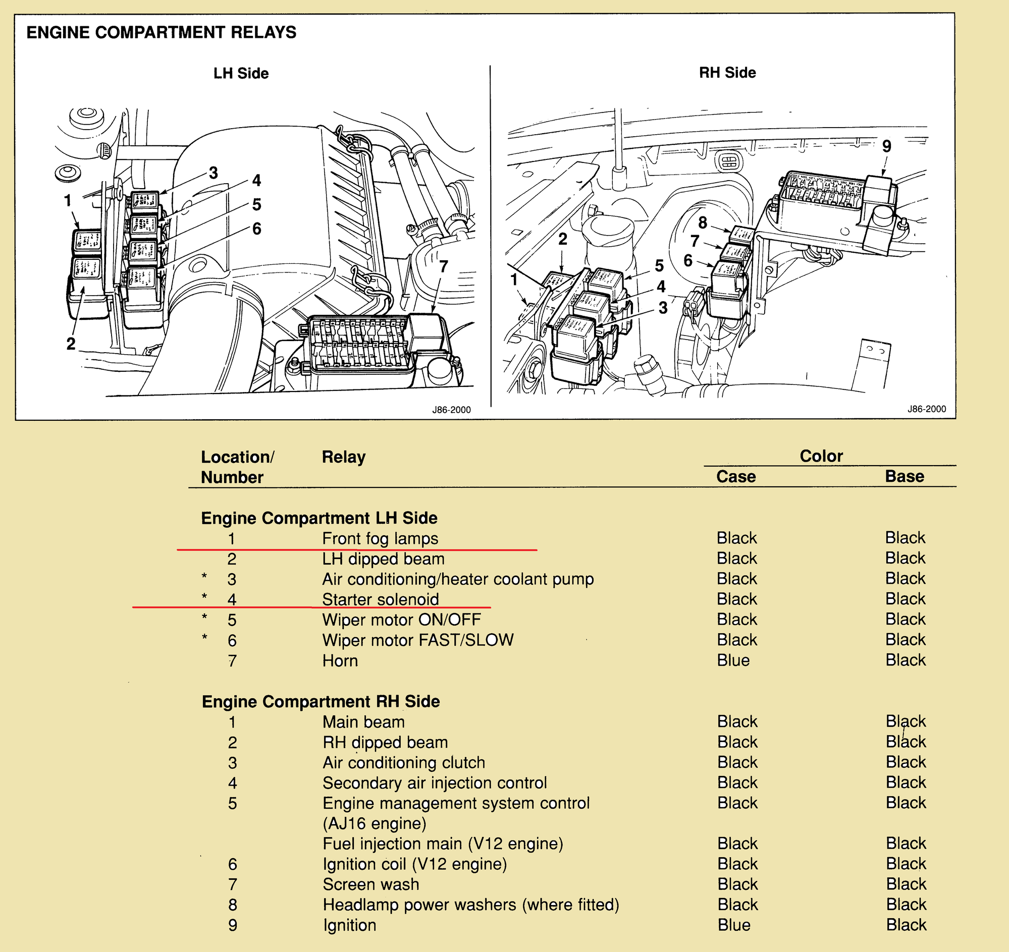

New computer so rolling , old one went boom boom
Be cautious to not install battery in backwards ( positive post fwd ) and not over tighten the battery positive post bolt
Need to know if you have starter rotation , do you see 300 RPM on the instrument cluster on starter rotation ?
Without that a walk through for information to get you going
In the beginning on key rotation to run without starting it will close several relays you can check for yourself as a one person operation
You can remove the relays and they should click in your fingers back to the open position
This confirms you have power to all areas of the car
Right engine bay fuse box ,small relay # 9
Left heelboard fuse box
Right heelboard fuse box
Trunk fuse box
But not the left engine bay fuse box ( controls the car horn only so swapping option )
ECU controlled relay , large # 5 right engine bay ( can be swapped with one of the same part # like a fog light or A / C clutch )
This large relay can be hard to remove as a O ring seals it from water but soaking with penetrate in the seam helps separate it from the socket

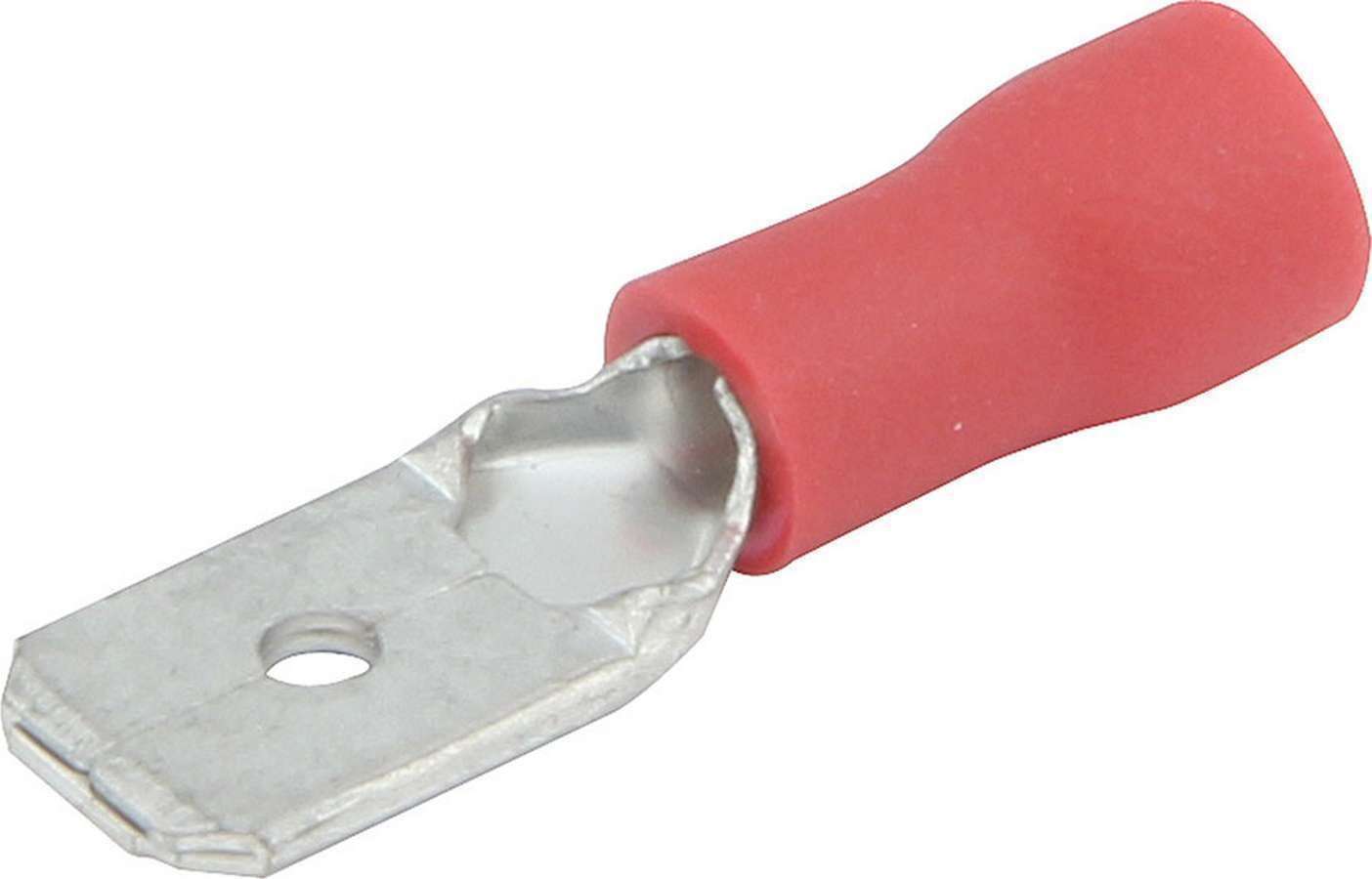

With respect to the fuel pump you can jumper with a medium gauge wire the fuel pump to run at all times between socket 3 and 5 , socket 5 the fwd socket is directly to the pump
This will drain the battery with the keys in your pocket over a period of time so plan accordingly to remove jumper
A auto parts store can help your build the jumper from tools and wire behind the counter in a kit of stuff they have
Suggest use blade type connectors on the jumper wire for better current to run the pump
