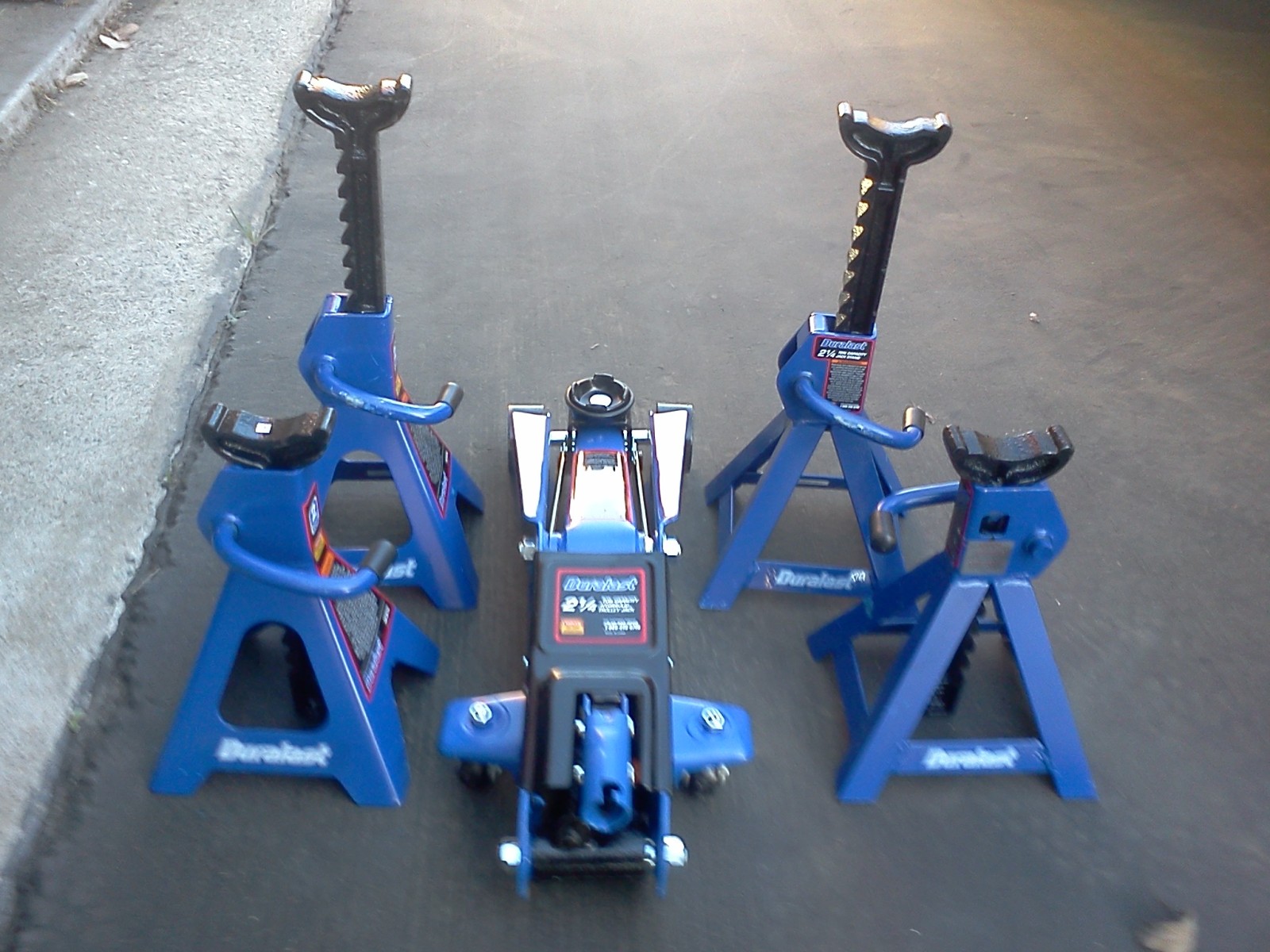

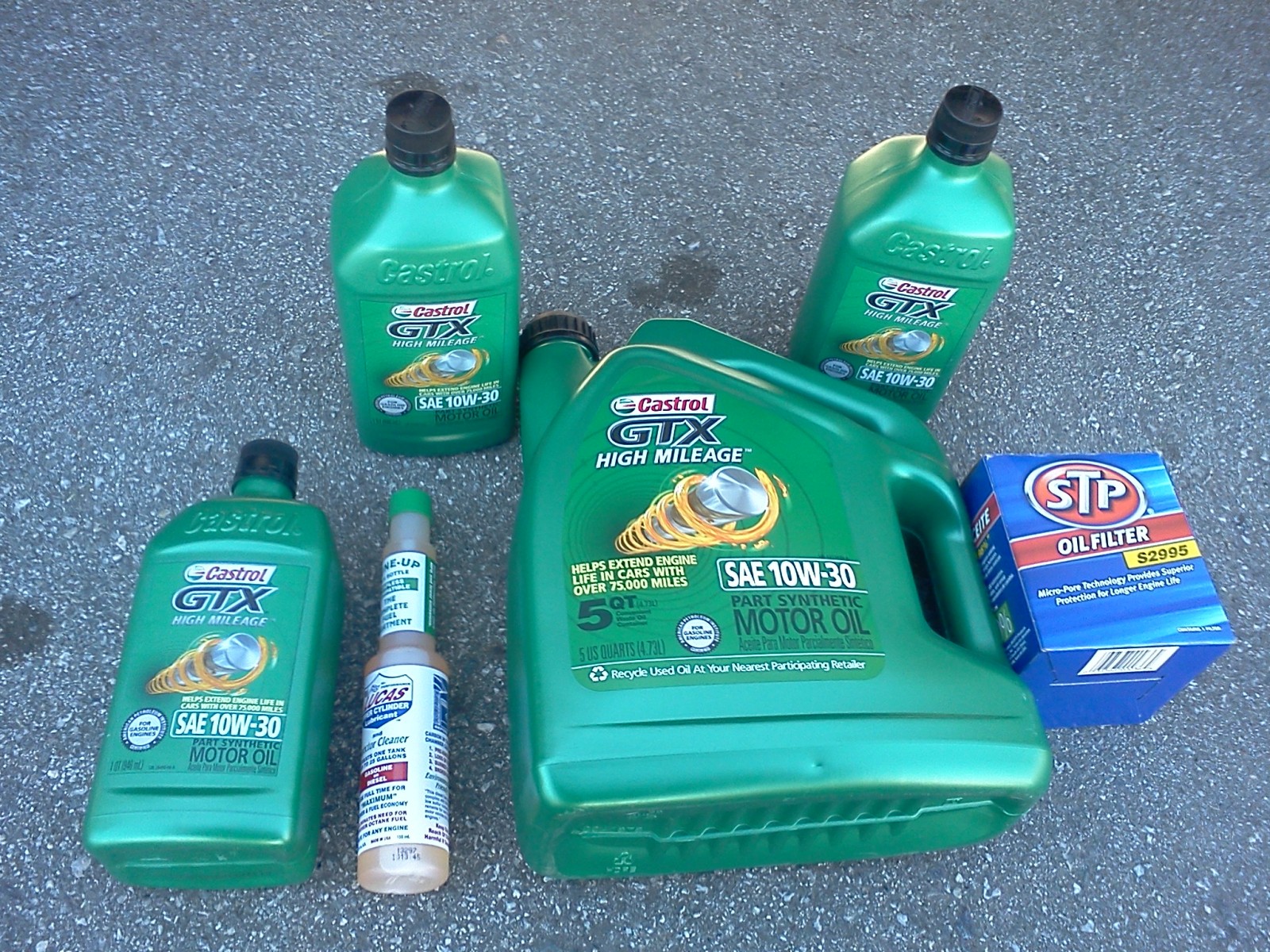

First You Will Need To Buy Oil And Oil Filter!
Consult Your Local AutoZone Or Auto Part Store For Fluid Type And The Parts!
I will Be Using 10-30 Part Synthetic And STP Oil Filter
Be Safe Always Use A Jack And Jack Stands OR A Ramp!
Attached Thumbnails How To Change your oil and filter vanden plas 96-2a7gysh.jpg   How To Change your oil and filter vanden plas 96-209507r.jpg   How To Change your oil and filter vanden plas 96-2urp7j6.jpg

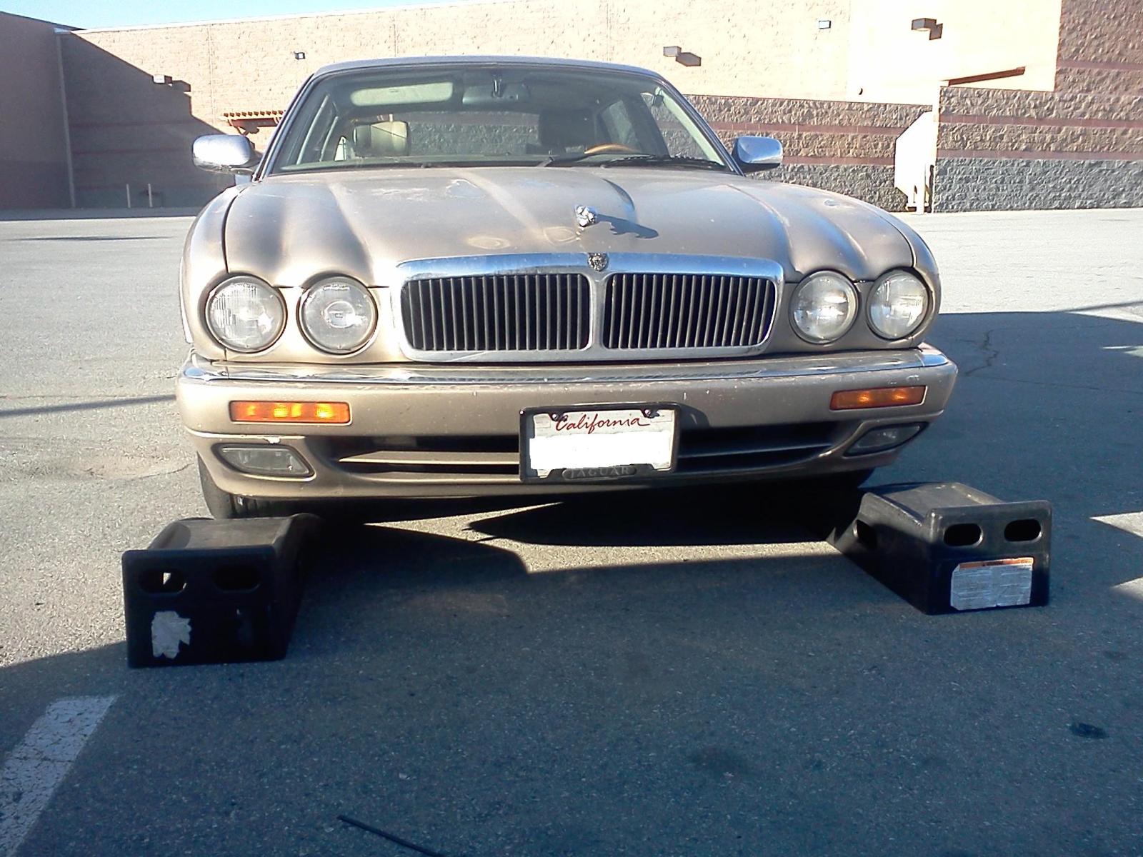

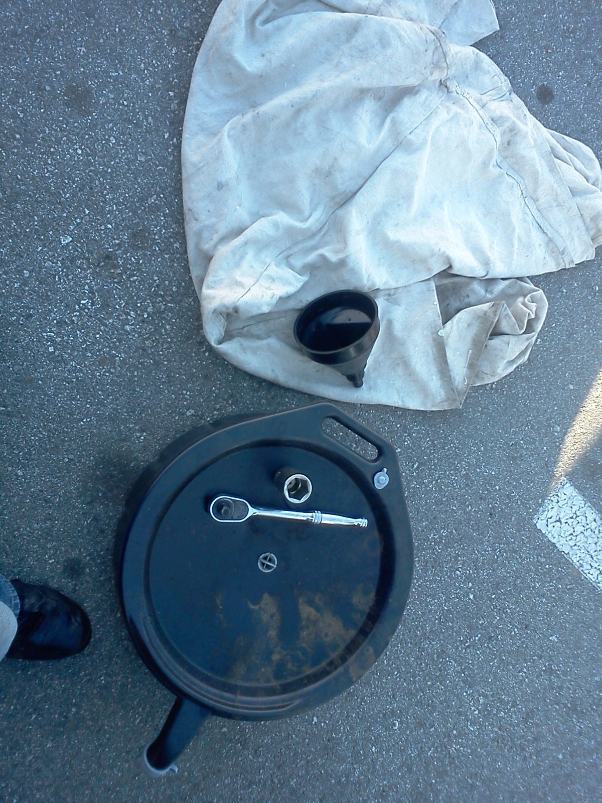

Gather The Tools And Parts You Will Need For The Job
1. Blanket To Lay On And Keep Oil From RUINING The Floor
2.Oil Pan To Catch The Old Oil
3. Socket Wrench And 30MM Socket
4. Funnel With Screen To Filter OIL

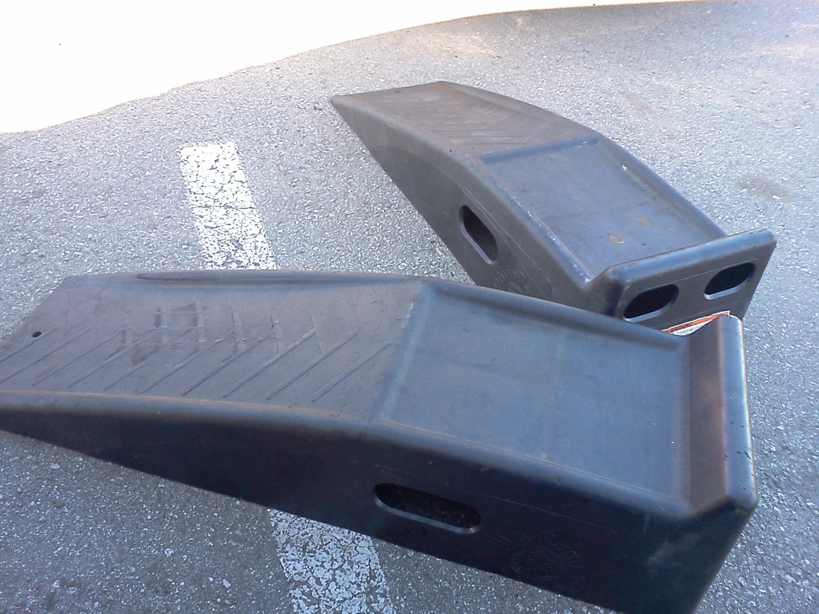

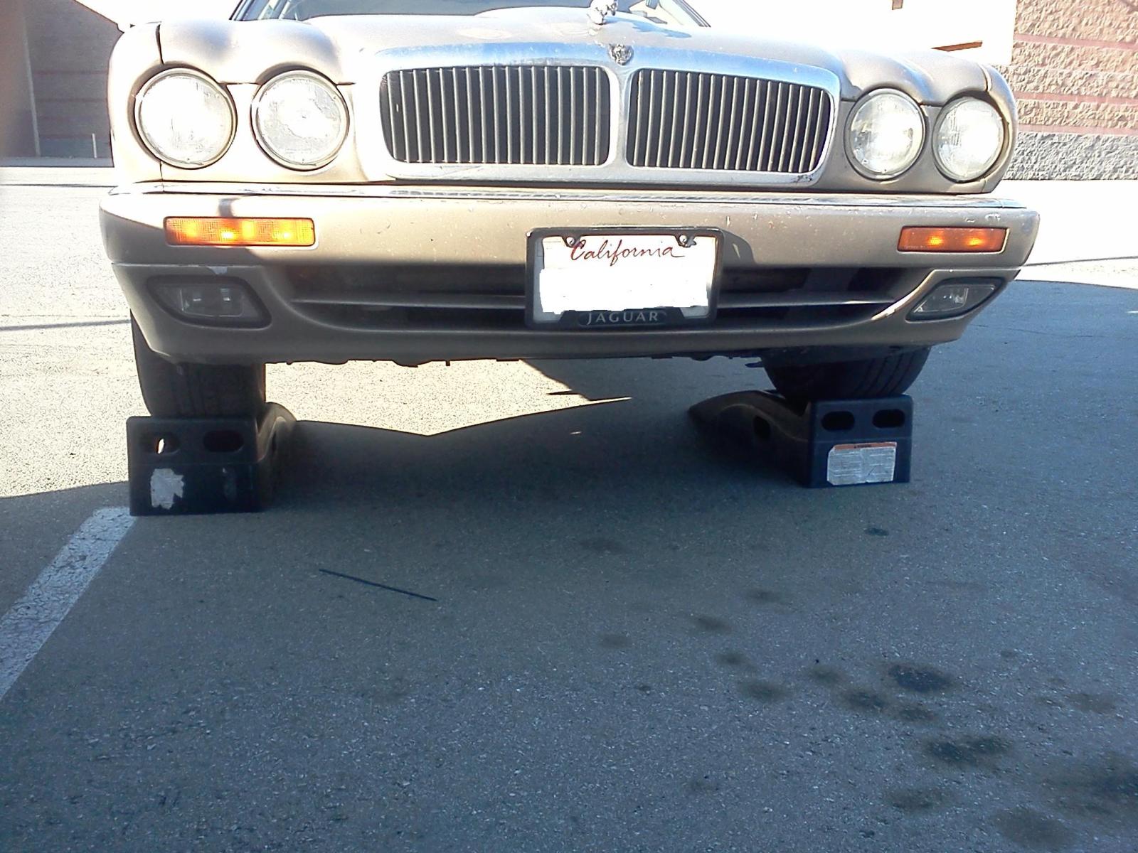

Set Ramps Under Wheels Evenly
1. If The Ramps Slide When Going Up Them, Just Reposition Them
Drive Up Ramp
1. Make Sure Wheels Are Not FALLING OFF The Sides Of Ramps!
2. Set Car In Park And Let Engine Cool OFF!
Attached Thumbnails How To Change your oil and filter vanden plas 96-2yy1381.jpg   How To Change your oil and filter vanden plas 96-15nvl85.jpg   How To Change your oil and filter vanden plas 96-122estl.jpg

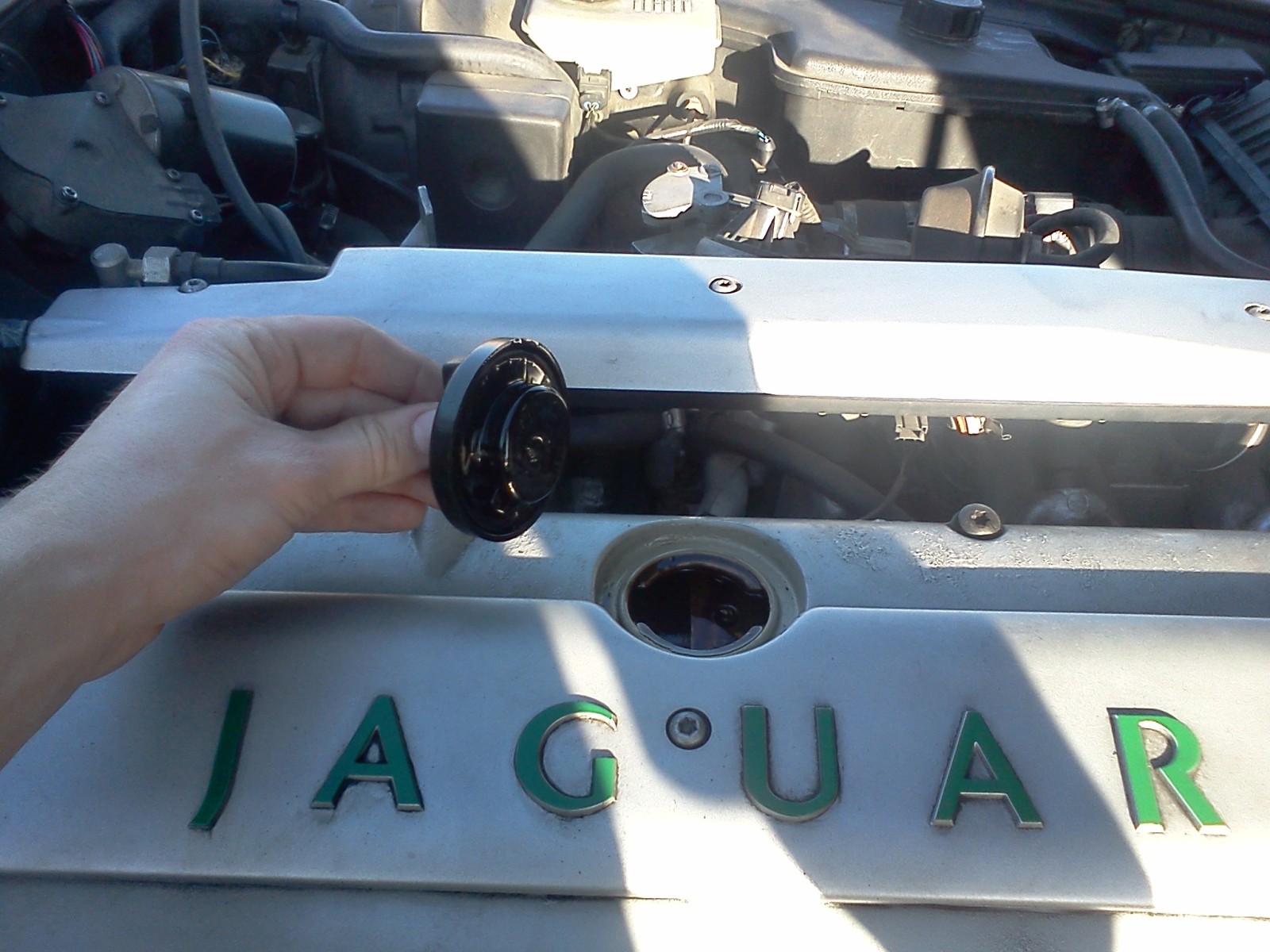

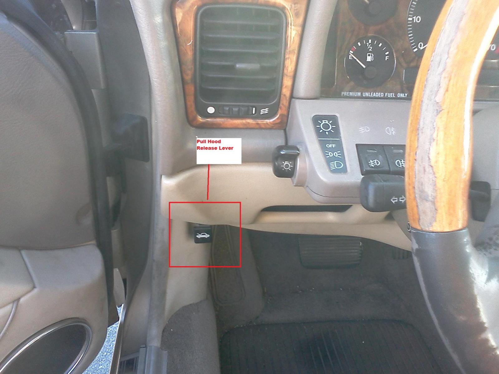

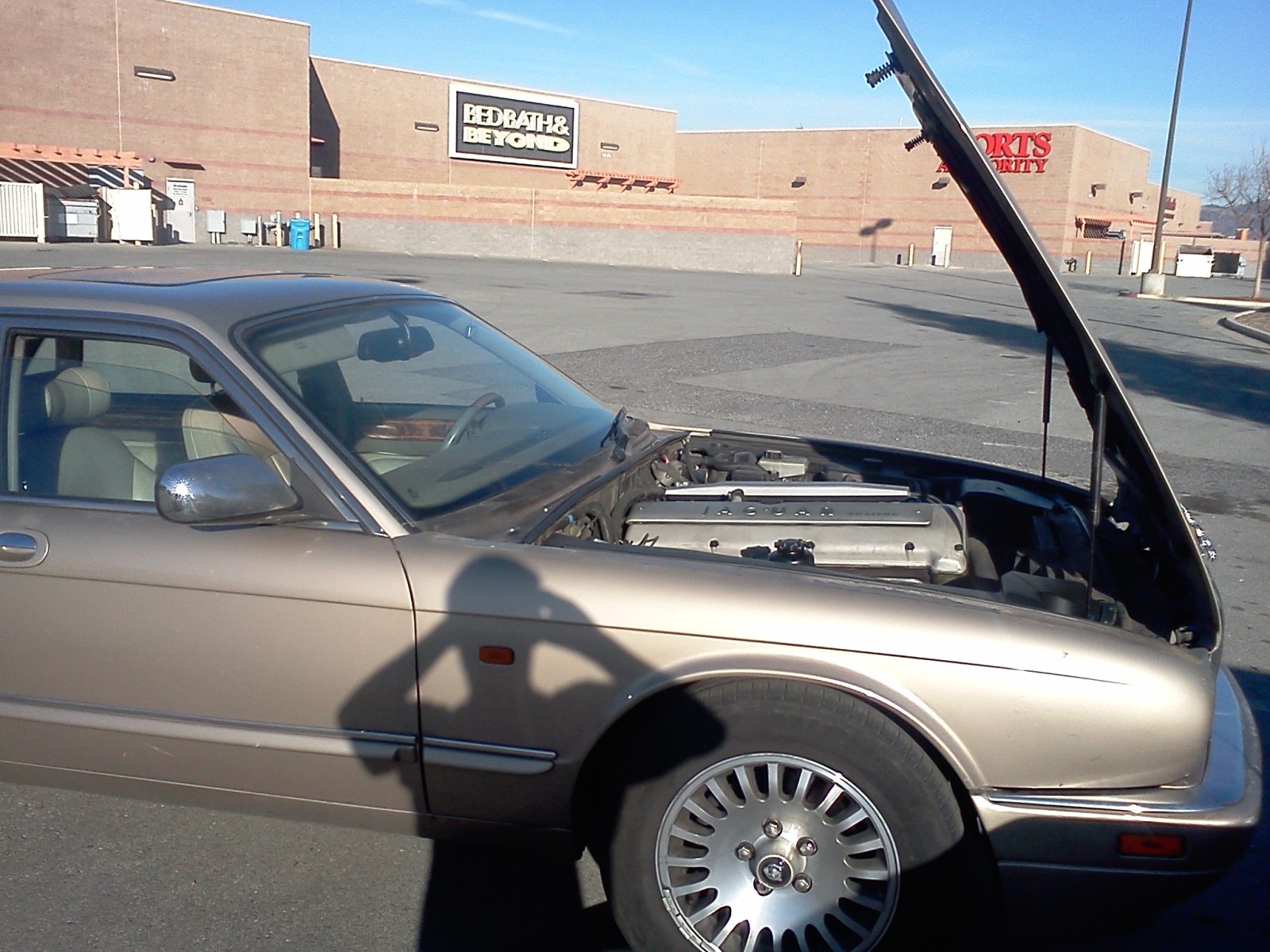

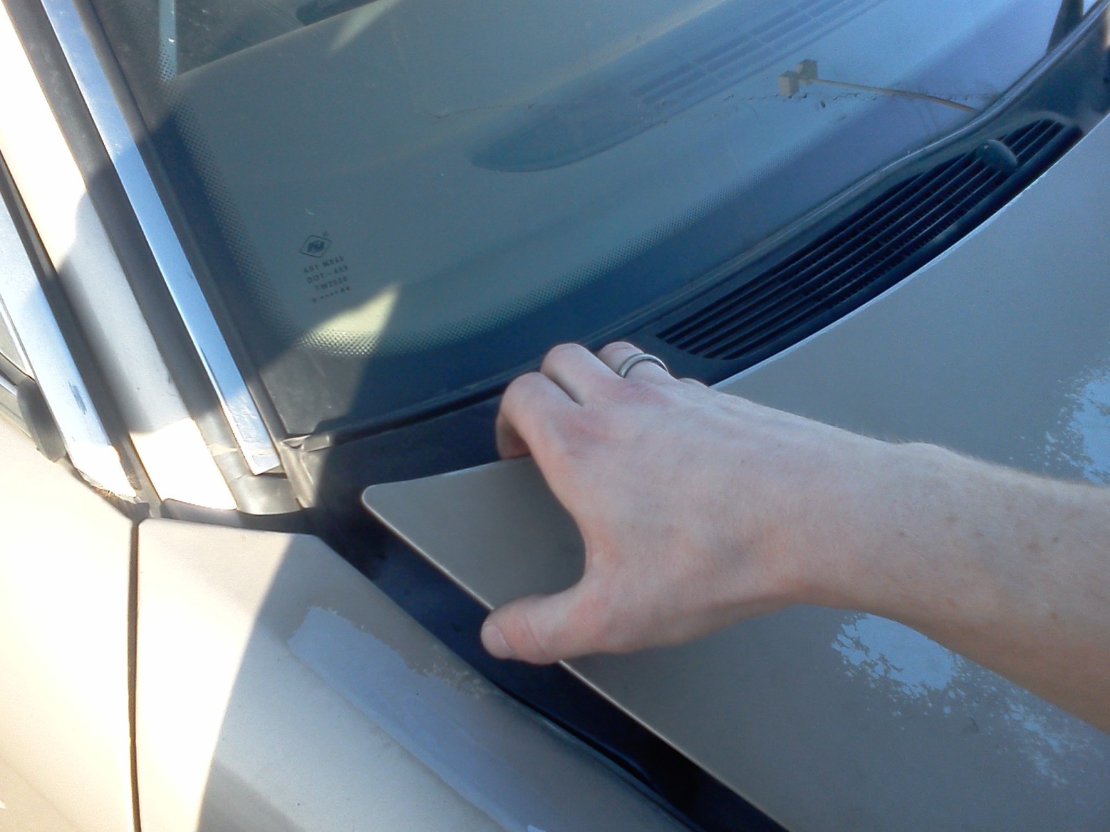

Once Engine Is COLD
1.Pull The Hood Release Lever
2.Open The Hood From By The Windshield
After Hood Is Open

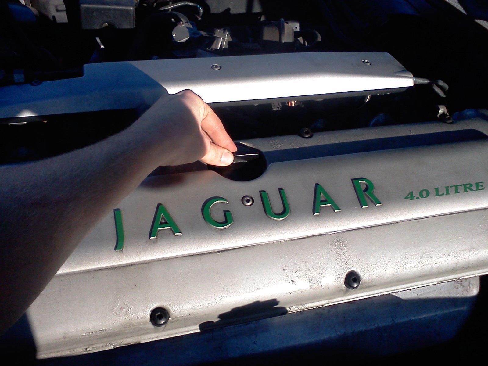

1.Find The Oil Cap On Top Of The Engine
2.Remove Engine Oil Cap
Attached Thumbnails How To Change your oil and filter vanden plas 96-s2tyzt.jpg   How To Change your oil and filter vanden plas 96-2j0lh86.jpg   How To Change your oil and filter vanden plas 96-241phlf.jpg   How To Change your oil and filter vanden plas 96-2mgw41l.jpg   How To Change your oil and filter vanden plas 96-23m7epe.jpg

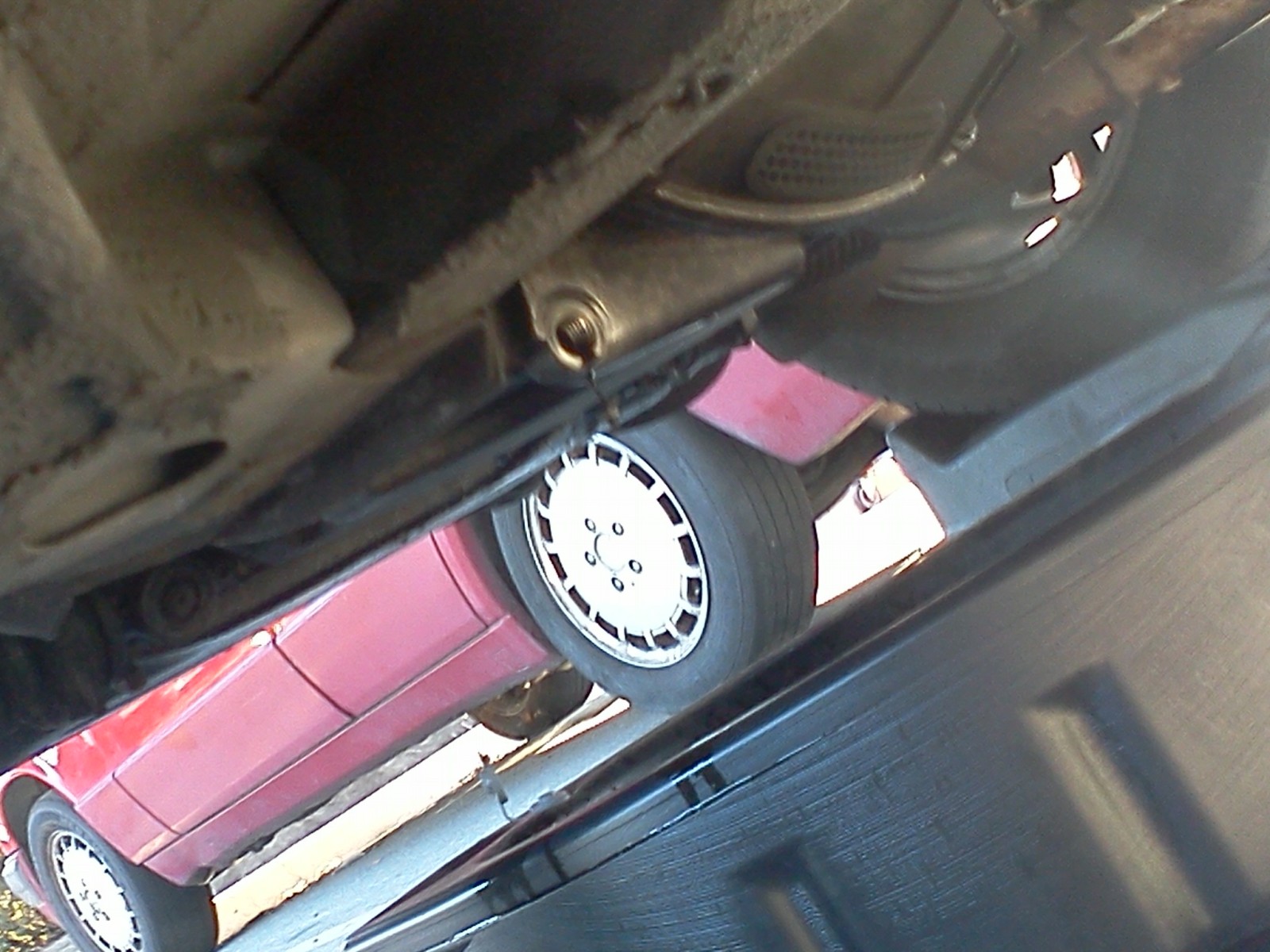

Prep Work Area Under Car
1.Place Blanket Under The Car In Work Area
2. Place Oil Pan Catch On Top Of Blanket Under Oil Pan Bolt

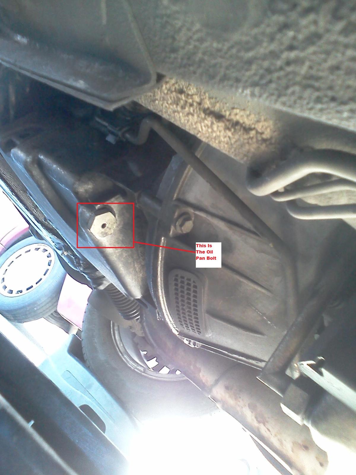

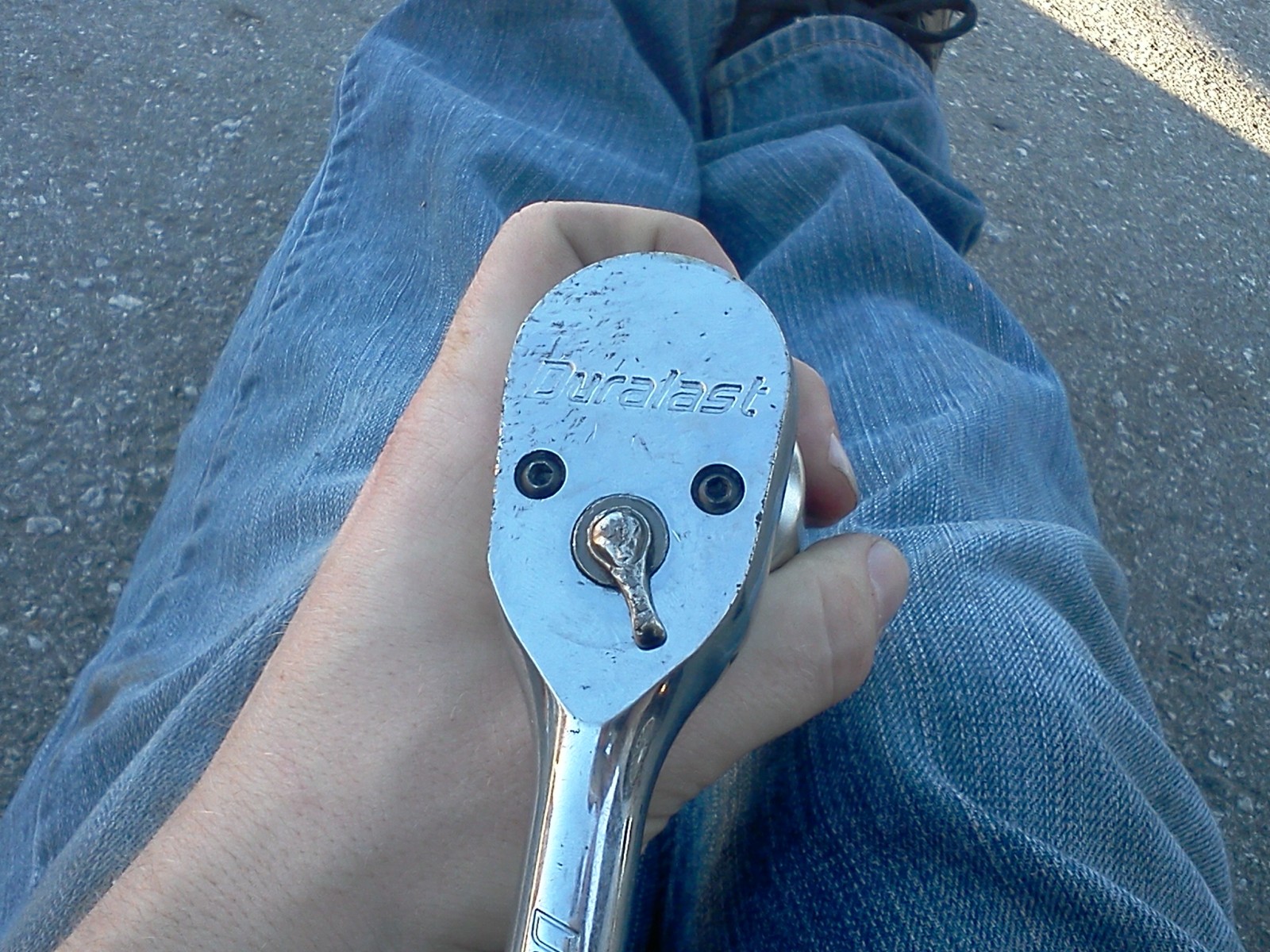

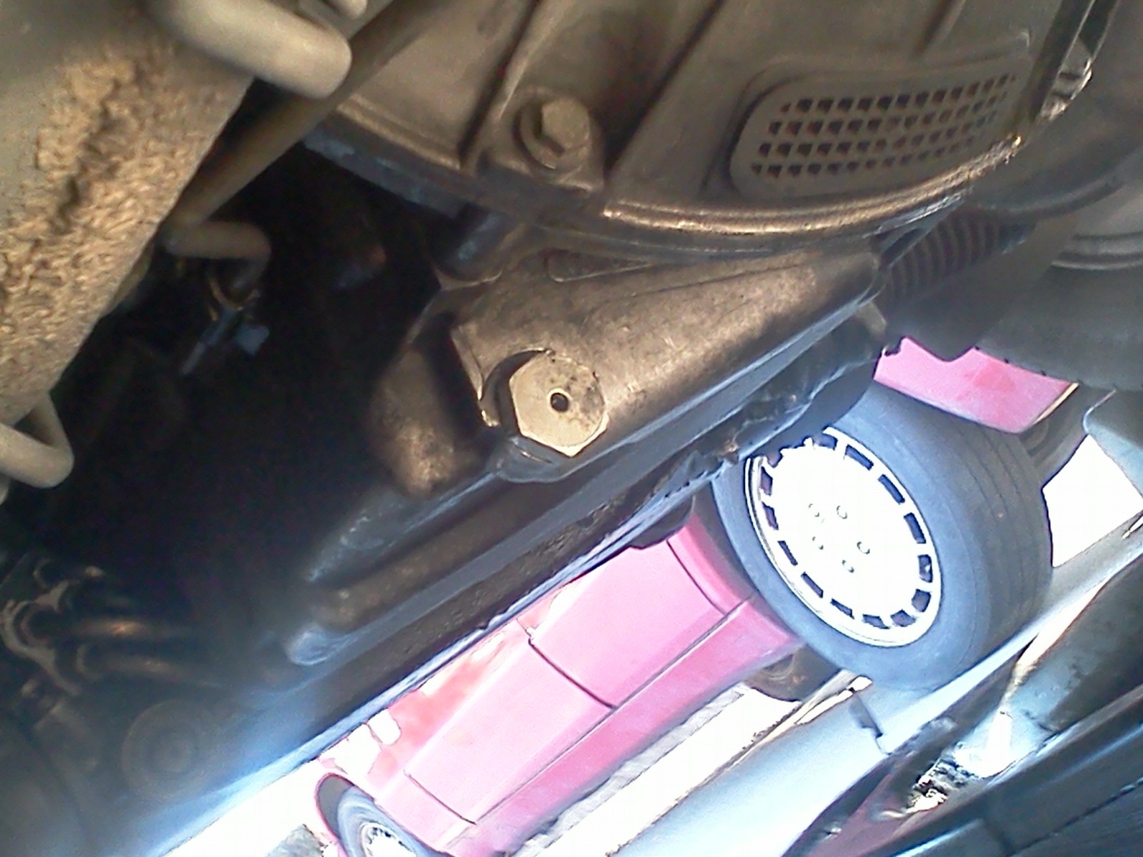

Drain Oil From Engine
1.Place Socket Wrench With 30MM On Oil Pan Bolt
2.Make Sure You Turn Left To LOOSEN And Right To TIGHTEN
Attached Thumbnails How To Change your oil and filter vanden plas 96-11v1ued.jpg   How To Change your oil and filter vanden plas 96-25gbb6u.jpg   How To Change your oil and filter vanden plas 96-15ee1lc.jpg   How To Change your oil and filter vanden plas 96-n21vme.jpg   How To Change your oil and filter vanden plas 96-30v24qh.jpg
The following 2 users liked this post by vandenplas408:
Cadillac (01-10-2014), shaune (01-10-2014)
Old 01-07-2014, 06:47 PM
vandenplas408's Avatar
Join Date: Jan 2014
Location: san jose
Posts: 313
Received 84 Likes on 40 Posts

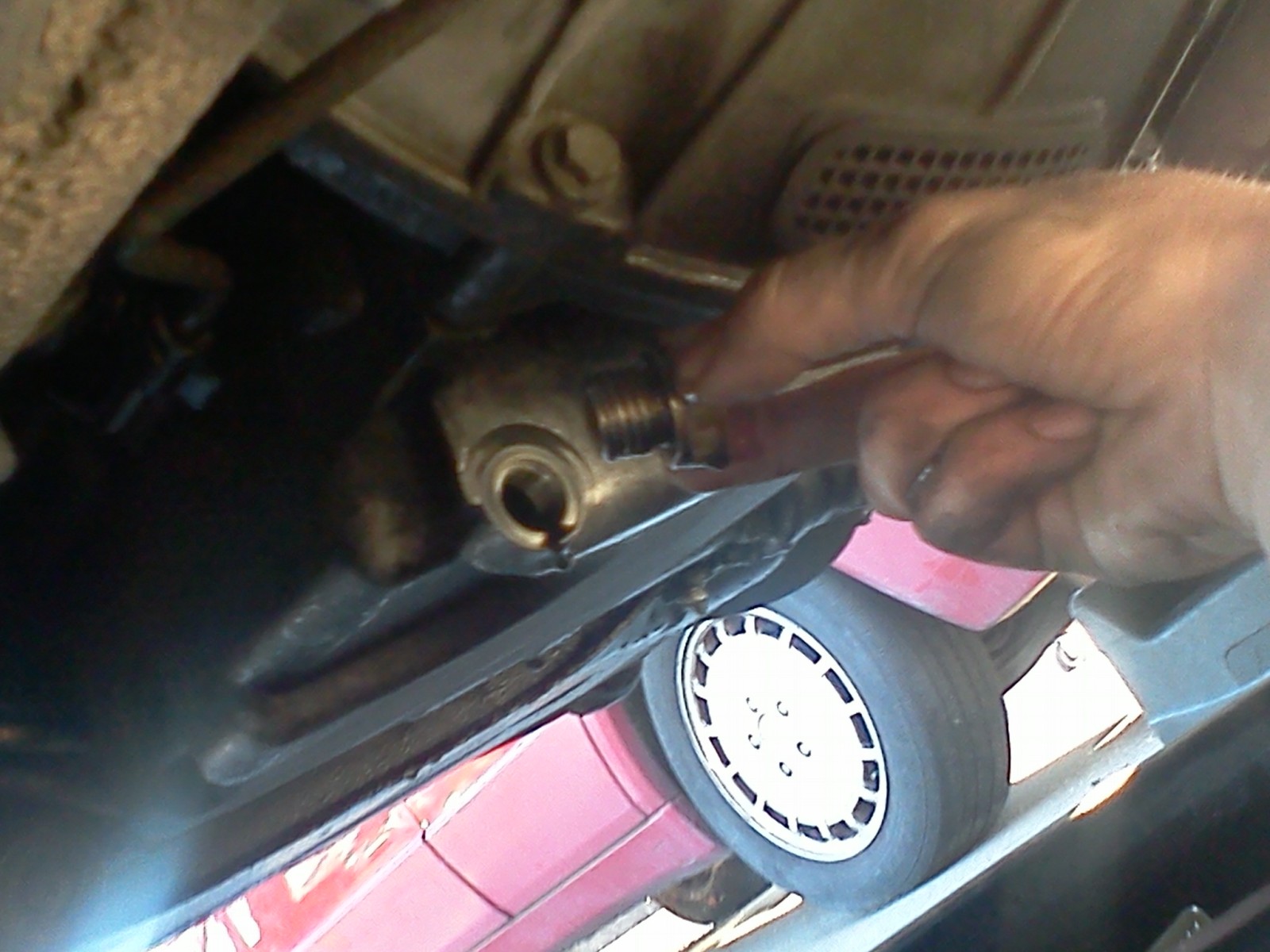

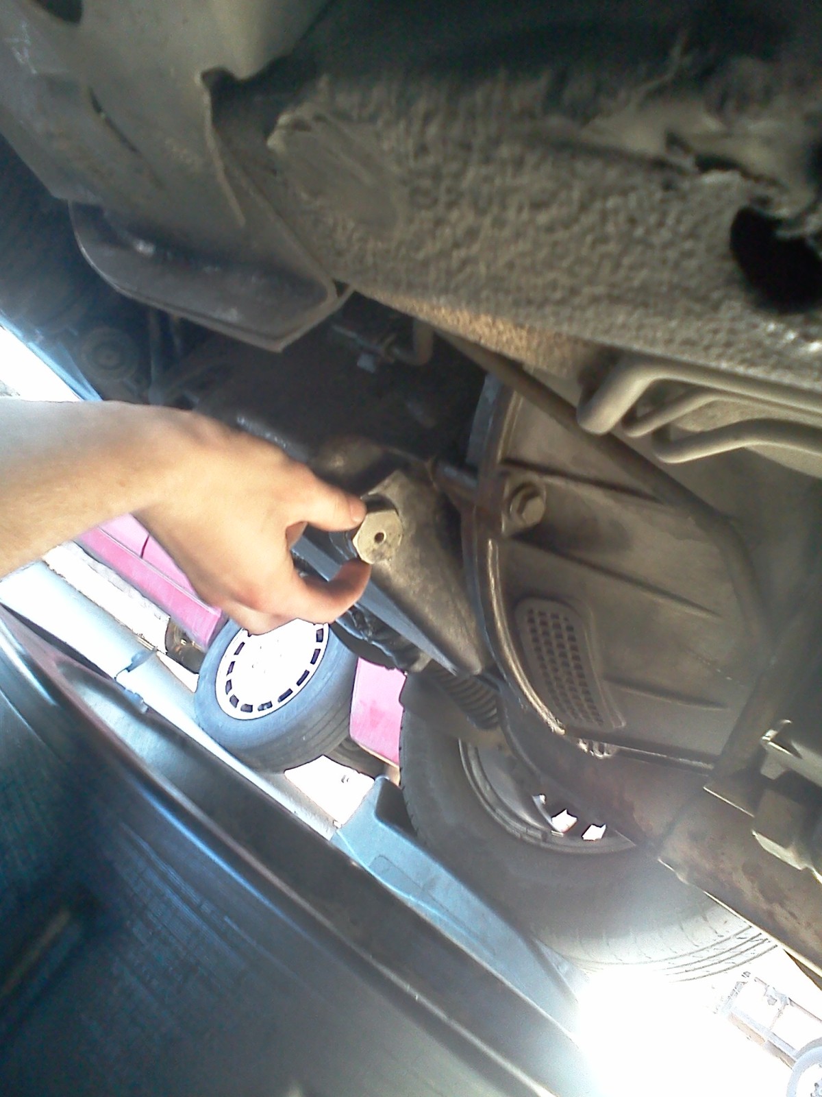

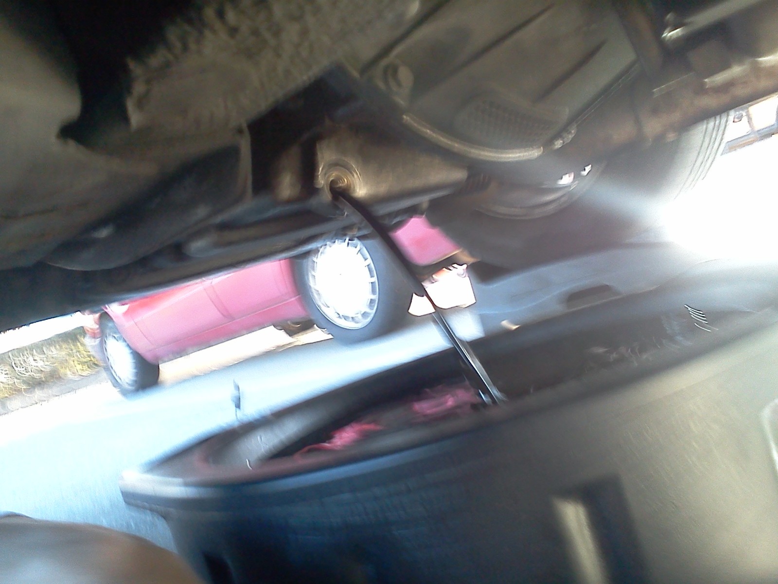

1. Once Bolt Is LOOSE, Thread The Bolt OUT With Your Hand.
2.Do Not Drop Bolt Into The OIL Pan Catcher
3. Let Oil Drain Until None To Little Is Coming Out.

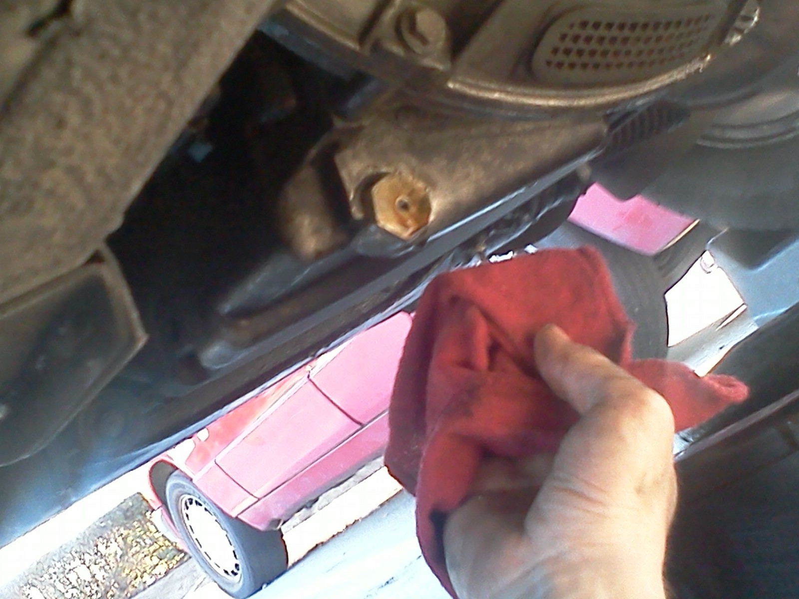

4.Place Bolt Back In By HAND
5. Grab Rag And Clean Bolt Before You Tighten The Bolt To 50-60 Nm ( NEVER OVER TIGHTEN THE BOLT DANGER)
6.Clean The Bolt And Area Around It!
Attached Thumbnails How To Change your oil and filter vanden plas 96-qy8l81.jpg   How To Change your oil and filter vanden plas 96-2ur15cz.jpg   How To Change your oil and filter vanden plas 96-acuaog.jpg   How To Change your oil and filter vanden plas 96-28iwxer.jpg   How To Change your oil and filter vanden plas 96-2qte1c0.jpg

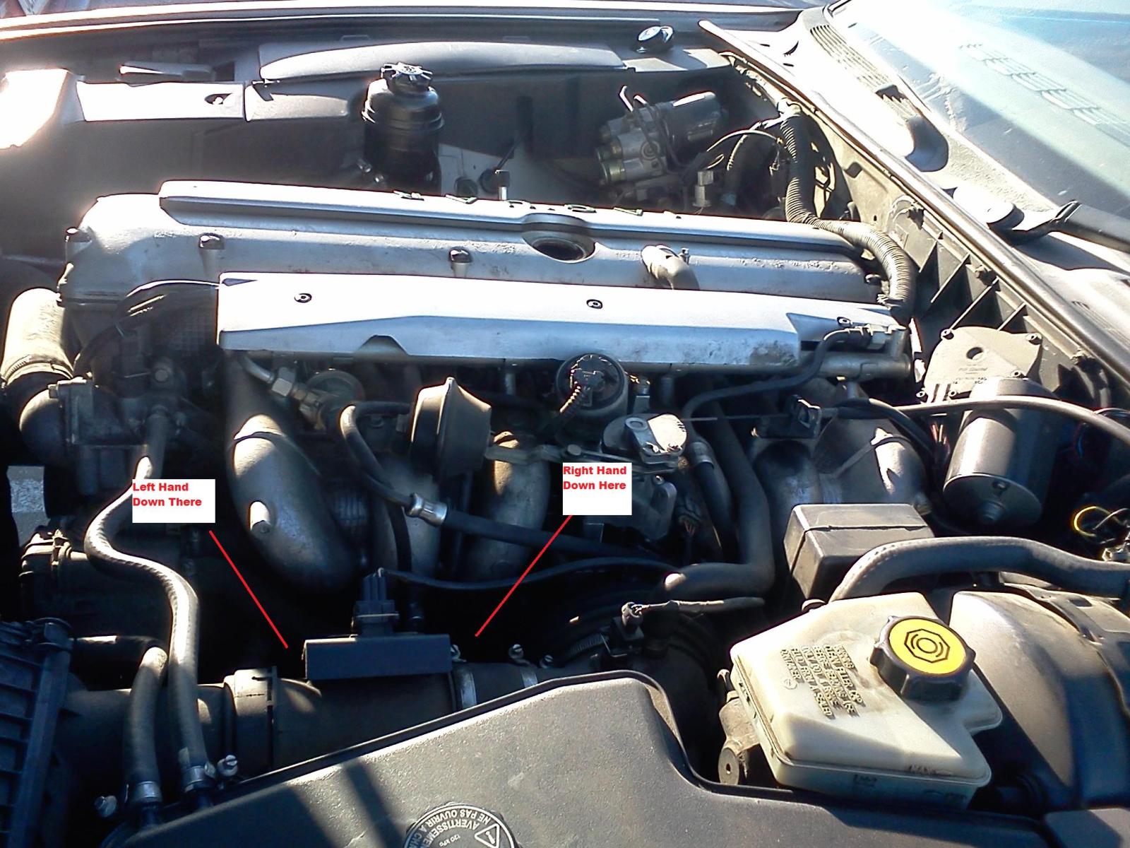

Locate Oil Filter
1.Place Hand Down Into The Spots Listed Above
2.Unscrew The Filter By Turning LEFT
3.Bring The Filter Up And Out To THE LEFT HAND SIDE

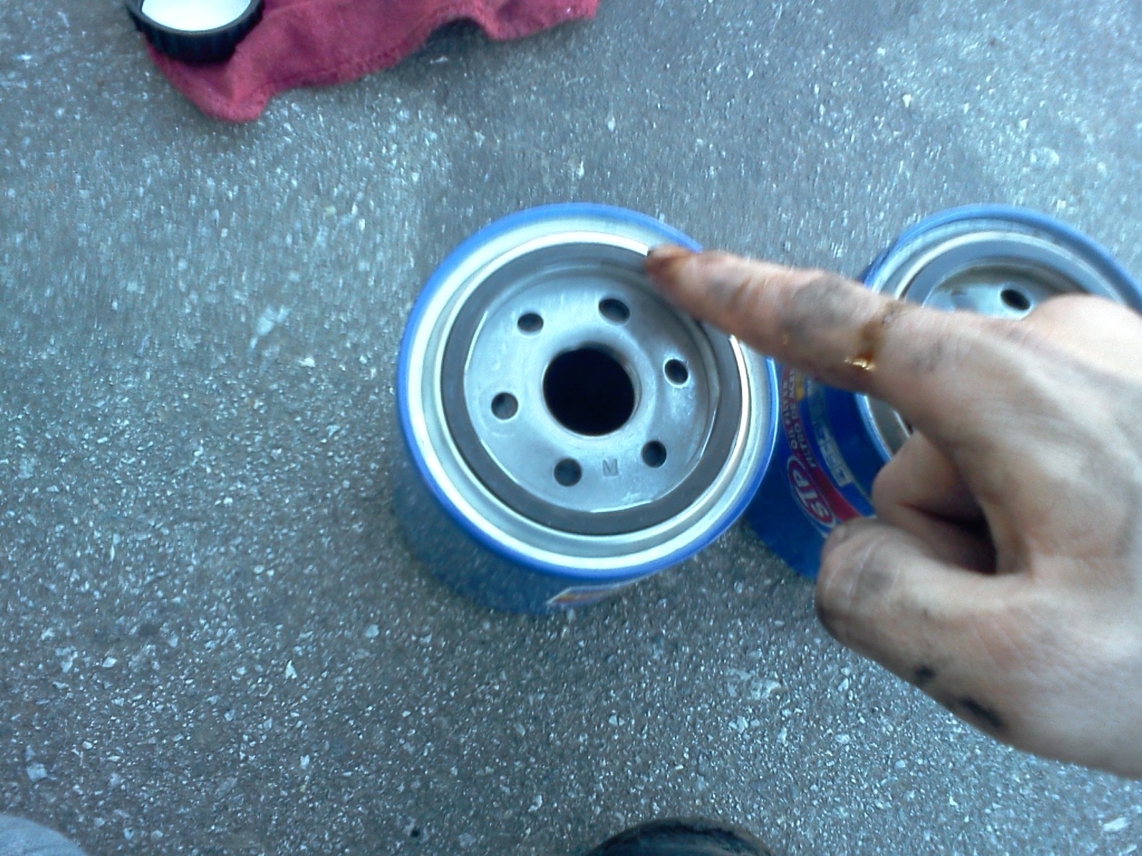

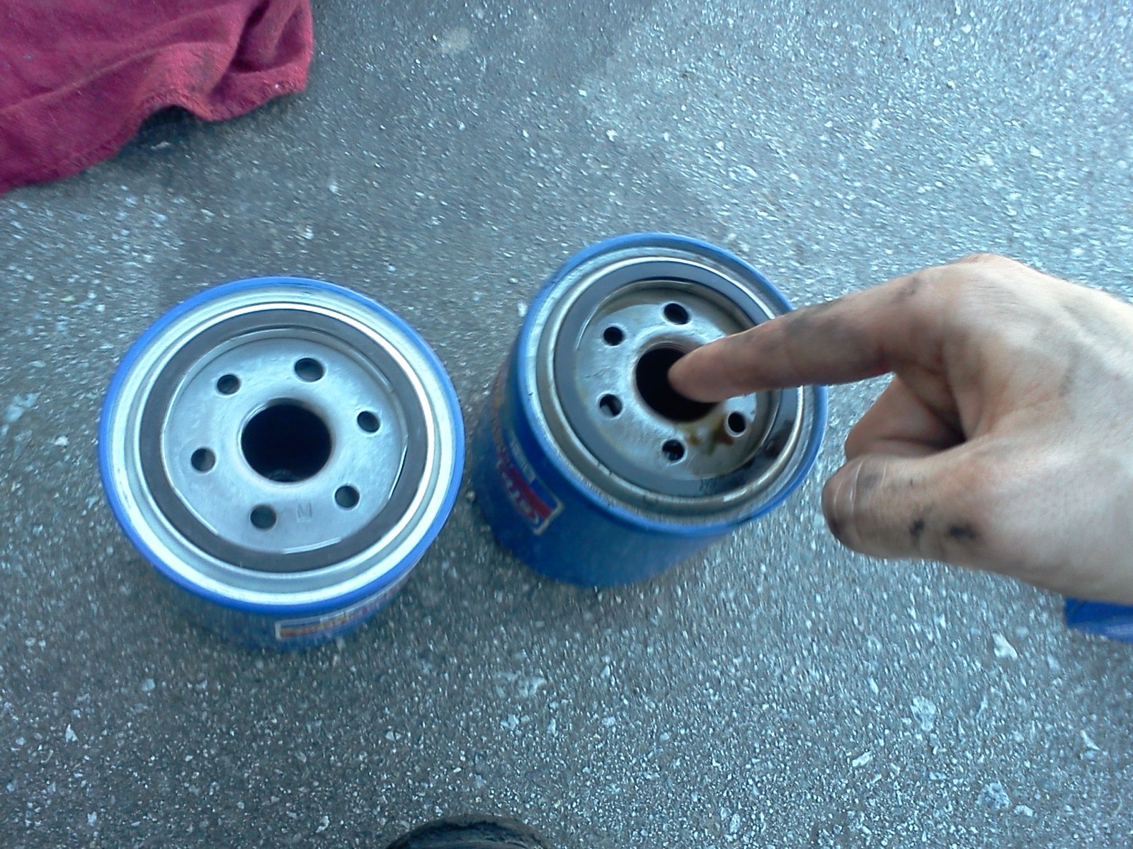

Prep New Oil Filter
1. Set Old Filter Next To New And Dip Finger Into Old Filter For Oil Or USE NEW OIL IF YOU DO NOT WANT TO RISK IT
2.Wipe The Oil Around The Black Seal Of New Filter
3. Install New Filter And Tighten To The RIGHT BUT NEVER OVER TIGHTEN OR IT WILL GET STUCK. Hand Tight Is Right

1. With the car up on stands, I find it much easier to replace the filter from under the car.
2. You say don't over tighten the drain plug but the spec is to tighten with 50-60 Nm of torque which is a fair bit.
3. On the other hand one thing I often see people do is over tighten the filter. Big no no andI think worth mentioning to people who have never done it.
4. A small point perhaps but I would only use clean oil to lube the new filter as the old stuff might have deposits that could harm the seal.
I did not find it easier to do from under neath but i am 6'2
I have almost dropped it and got oil in my FACE
so i try to get from top if i can and its not hard at all
When i was young i turned to tight on a drain plug
because some one told me to make sure it was super tight
or it would leak oil
i ended up TURNING way to tight needed a new pan and plug ><
and the gasket for the pan as well
yah turning the oil filter sucks but it wont cost u like the oil bolt did.
worst case stick a screw driver in it for torque lol
i guess i could use clean oil and i do some times but i have never had any problems/ nothing a new filter cant handle
