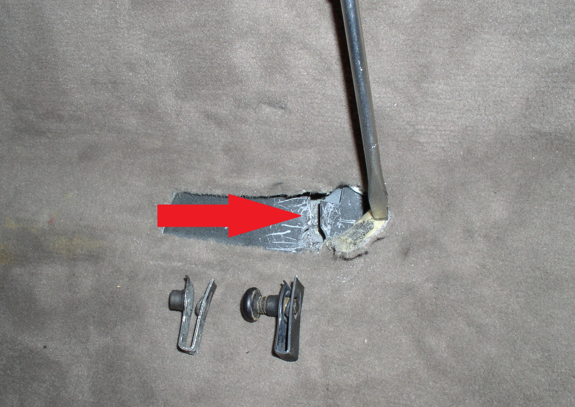

Another failure is the captive nut (for item 12 in the diagram) pulled out of the floor. See the split arrowed in red:
I had to hammer it flat, spot weld and fit a new captive nut.
