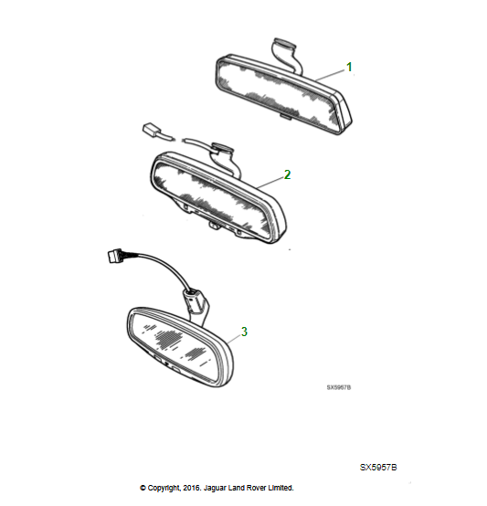

Three are three options of the interior rear view mirror. See Jaguar Classic Parts' diagram below:
Mine is #3, and does dim the glare from behind automatically. It comes with an electric cable and there were discussions about compatibility of one with three and four wires, and ways to fabricate either to fit.
However, the glass on my mirror is becoming cloudy so it is about time to replace it. Unfortunately, to get an exactly same mirror will set me back by about GBP200, and a used one is typically priced around GBP100. Didn't know the difference a year ago and bought one that appears is the basic one (#1 in the picture). The shape of the mirror casing is more angular, and it does not have the dimming function, just doing the basic thing as a rear view mirror. #3 one seems to work best and blend perfectly with the rear window.

Mine is #2 in the illustration with the slide control. The glass is not clouded it just will not darken with the slider control.
