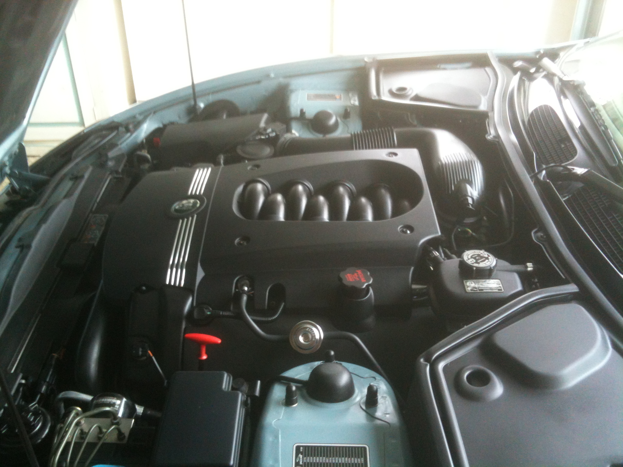

Ok, my engine bay is only 8 years old but there has never been any water used in the cleaning of it. Plenty of rags, cotton buds, engine cleaner and engine dressing, oh and lots of time and patience.
Attached Thumbnails Jaguar detailing help-002.jpg   Jaguar detailing help-003.jpg
