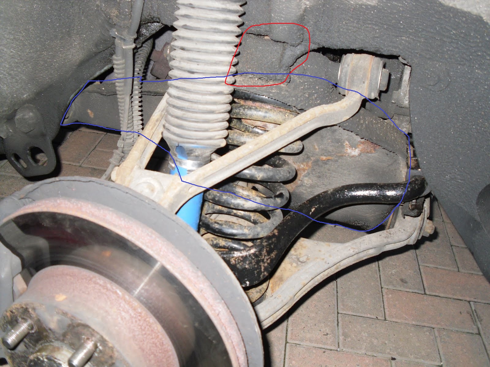

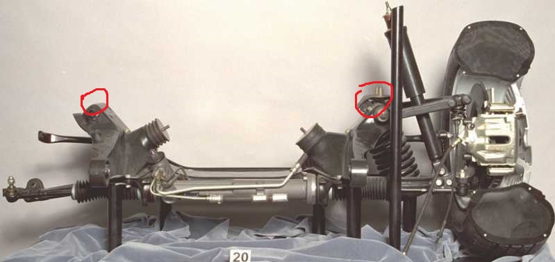

can you point them out in a pic? got this 2 pics from google.
circled in red is where i see it drops a bit when i raise the car.
circled in blue is that entire crossmember or cradle under the engine, thats the piece that moves when raised.
if its not normal for that to drop then what is the part i need to fix? and if its normal what is the purpose of that cradle moving. shoulnt that be bolted to the car solid?

the v mounts are in red. the subframe is NOT supposed to drop down when raised. those mounts are 2 piece steel brackets encased in rubber to isolate road noise in the car. You may also need to replace the 2 round subframe bushings also as theyre likely cracked/broken too. the good news is you suspension is covered in grease and grime. I dont think rusty bolts will be too much of a issue.

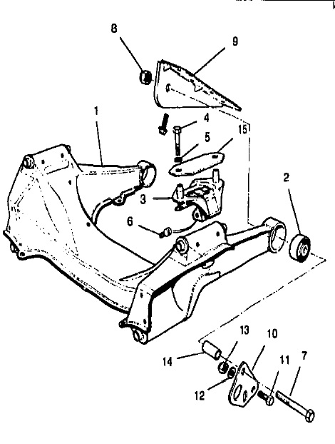

number 3 on this schematic? if thats supposed to be bolted wow how can it drop i need to go look again at the suspension i gotta be wrong. if not then those bolts have broken.
