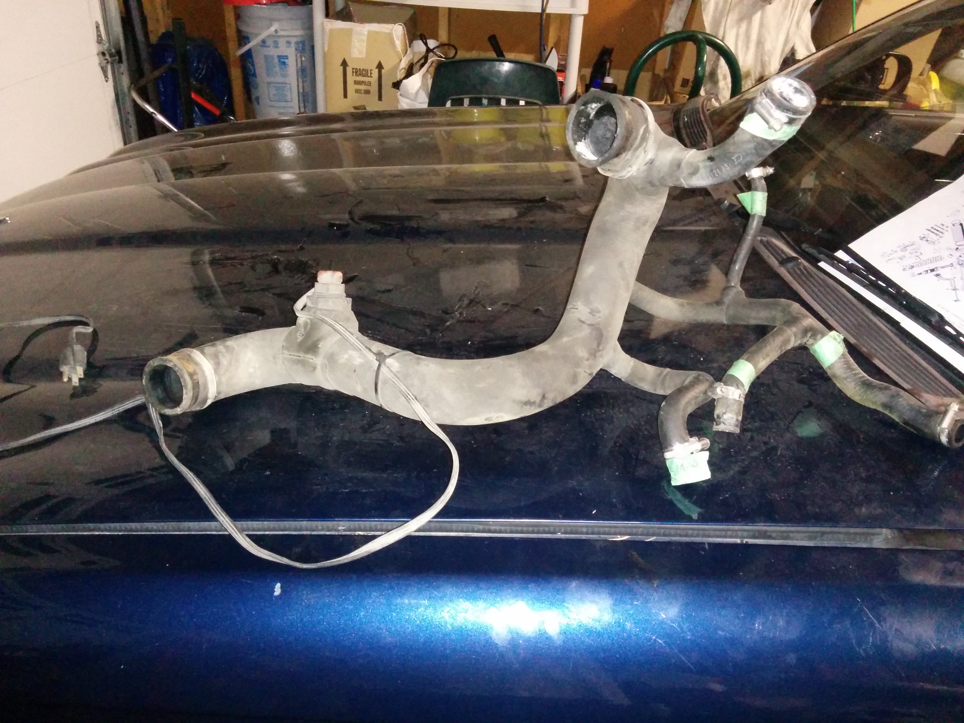

Hello everyone,
I am currently carrying out some preventative maintenance on my '96 XJR.
I ordered an after market replacement (please see attached photos) hose for the lower radiator hose before I removed the lower radiator hose--which was a royal PITA--but they are not same!
I did not know that radiator hoses could even have plugs in them.
Now:
-do I keep the after market hose and replace the original heated one? (I was not able to find a heated one) will that cause any other foreseeable problems?
-does anyone know where I can find the heated variant for the hose?
-can I find a refurbished heated hose? (is there even such a thing?) is there a way to refurbish it myself?
-do I REALLY have to replace this hose? It didn't have any leaks--I just did it because I heard, through various online forums, that it is advisable.
Any help/advise would be greatly appreciated.
Best
Attached Thumbnails Lower Radiator Hose-Heated-img_20150731_044742.jpg   Lower Radiator Hose-Heated-img_20150731_044802.jpg   Lower Radiator Hose-Heated-img_20150731_044900.jpg   Lower Radiator Hose-Heated-img_20150731_044940.jpg

Lots of Canadian market cars came with the heated lower hose to keep the coolant warm.....part of a 'cold weather package' or some such. Can be useful if the car is exposed to severe freezing conditions. Otherwise, no, you don't need it. Just use the hose without the heater fitting.
The original hose is part number MNA4512AC. You can call Jaguar and see if it can still be ordered.
It's always best to replace coolant hoses *before* they start leaking.... and certainly better to replace 'em before they let go entirely leaving you stranded by the roadside in a giant pool of coolant.
This is triple-true on the XJR6. As you know, replacing the hose is a very big job.....impossible to do along the roadside and you'd pay a repair shop a small fortune to do the job, if they'd even be willing to try.
Far better to replace it before it fails, and under non-adverse conditions.

The heater portion can be replaced with a aftermarket inline coolant heater.
The only difference is that it won't be molded in. The aluminum casting
will show. The installation process is to cut a piece out of the hose,
slip the remaining pieces on and clamp.
Those heaters, in my mind, are far better than block heaters because
they circulate the coolant by convection.
Whether you choose to find another hose, forget the heater, or add the heater,
replace the hose since you have it all apart anyways
If you are a forward thinking packrat you can always keep the old hose
as a spare.

Thanks for the tips guys.
I think I will just replace the heated hose with the non-heated version--not really a need for extreme measures here in Vancouver; knock on wood--and keep the old heated one as a back-up.
