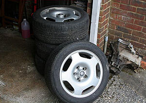

Originally Posted by asativa
anyone ever seen black wheels on a green jag? im going to have to paint the wheels i dont know if i want to just paint them silver or what.
Black wheels... Sounds like something a boy racer might do and I can't imagine that it looks very good!
Are they genuine XJR wheels like this:
If I was you I'd be restoring them as close to their original finish as possible (just my preference, of course). I don't know how they re-finish alloy mags (the jaguar finish was some kind of clear cote). Powder coating is an option.

Oubadah- yes those are the wheels. They currently look like ****, with 2 being black and 2 just like your pic. Thanks for ur help, when I click the link, it says I don't have the privileges to open
