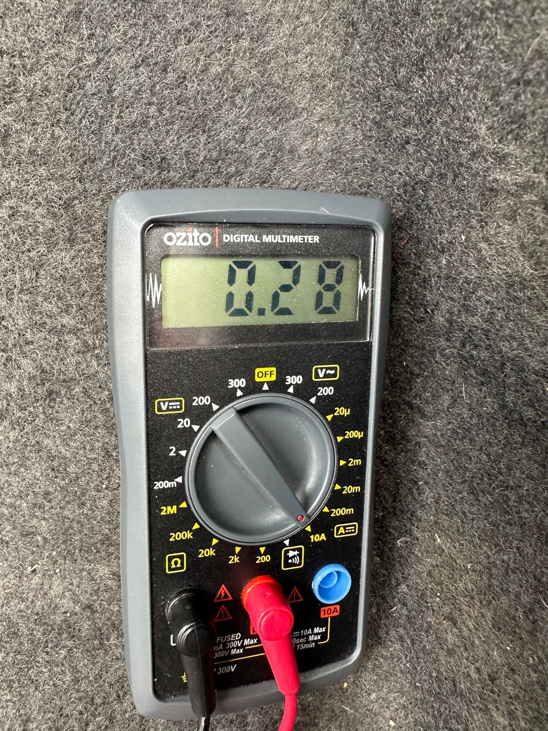

Actually there is no power draw…..
i realised i had the multimeter connected incorrectly..
connected the way i had it on the vma was giving me milli amp reading.
The .28 i was seeing was not .28 amp. It was way smaller. It us the draw from the multimeter itself.
it reads .28 like this when just connected to a battery alone.
so when i connect the plug to the 10A on the multimeter i get no reading.
so now i have sorted my stupidity,
it leaves me with why the hell has my brand new batter drained over the course of a week?

So, i have double checked, triple checked, the reading i am getting is 28 mili amp drain.
which is perfectly normal. Compared with other cars i have here and get same kinda reading also,
so now i really have no idea why the hell my battery is draining.

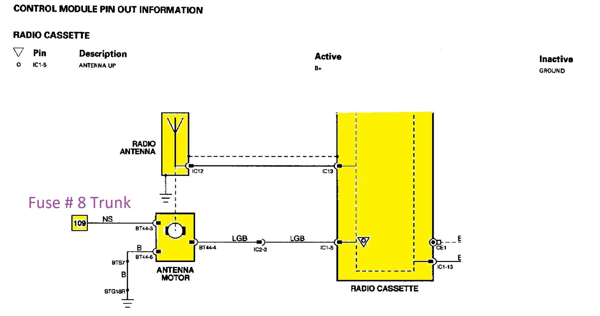

On the line of the antenna there are 2 or 3 fuses X , Y , and Z for the stereo system
The stereo head controls the antenna.

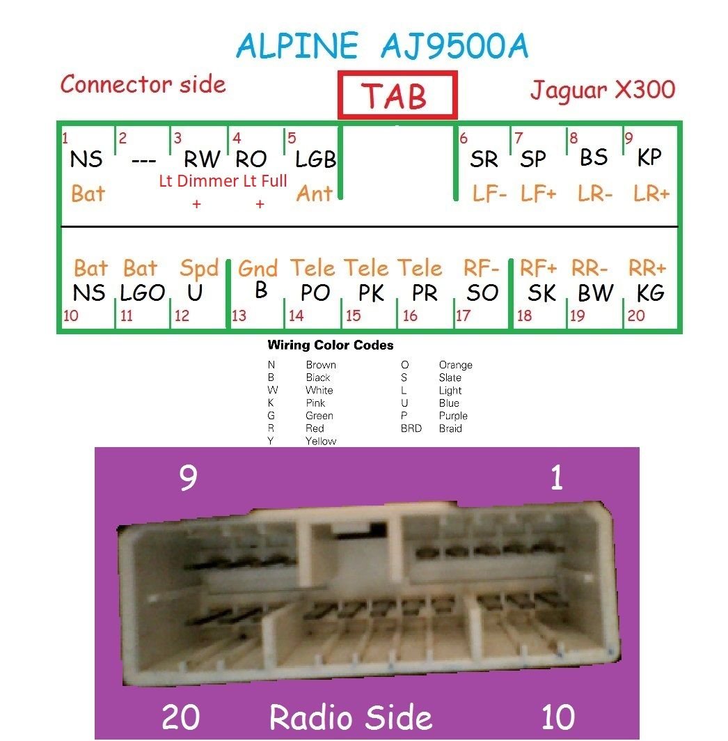

The antenna motor.specific fuse is # 8 trunk fuse box which is hot at all times bypassing the trunk fuse box king relay in the corner of the box
To raise the antenna B + is applied to the pin 5 ( Light Green / Black wire ) on the stereo head connector on the car side ( this is only a controlling input to a relay inside the antenna motor assembly )
To lower the antenna the pin 5 is grounded , your case it may have found a ground somewhere as a fault

So i suspect it is the antenna itself for a few reasons.
this was not happening until recently and i installed the stereo quite some time ago.
i just recently “repaired” the antenna
and it does go down after about a minute once it rises.
so it appears to be grounding out when battery is connected, and then dropping when it gets no radio signal.

You can remove the fuse when extended.
if the drain still accures you have an issue with the Light Green / Black wire
