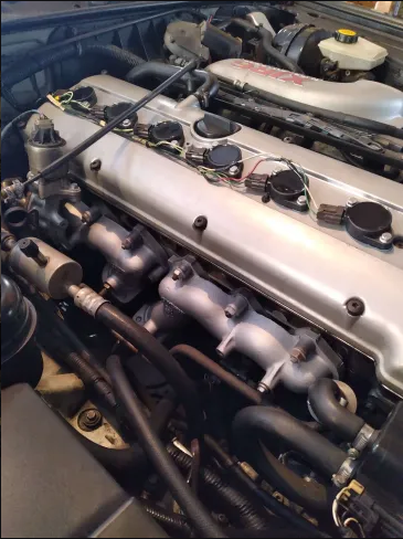

Well its not a great update but here it goes. I got the exhaust all put back together and sealed up*. Soaked a lot of the cast parts in evaporust and then painted them with high temp silver grill paint. Good to 1200F, unsure about chemical resistance, but time will tell. There was a large obvious leak at the rear manifold to the head. I put new gaskets on both manifolds, the downpipe, and all EGR ports. ...And it leaks like a sieve. Still ran terribly in that state. I also tried switching over to a different set of coil packs which did nothing. I really don't want to do the exhaust a second time. At this point I'm fresh out of ideas and patience, I had it towed to a repair shop. I'm now nervously awaiting the diagnosis and bill(!). I had to call about 8-10 shops to find a specialist that would actually take it. Quite a lot of "specialists" around here that... aren't.

So the shop called back with some good(I think) news. My exhaust leak at the donuts was just because I hadn't tightened them in all the way. I felt like I was going to strip something, but whatever. Easy fix there! They did a compression check, all good, no bore wash for me. I also have proper fuel pressure so I've dodge that bullet. A couple of big ticket items that I don't have to worry about now.
What they did find was my coils were swapped, but that didn't help very much. That's why I was unable to tell by myself. One of my EGR flexy pipes is leaking, and they're also on backwards. What's odd to me is that I did take pictures to reference when putting it all back together... I think they've been backwards the whole time? Hopefully that's pretty minor though.
The crank position sensor is clean, I've had it in and out a bunch now. I put a new Rochester valve in the back already to fix a tank pressure issue. Secondary air pump seems to be working fine, it makes the right sort of noise.

I have the car back from the shop now, runs like a top. So smooth its like its turned off. As soon as I got it home I put it back up on jacks to look at the brakes some more... I will be moving back to my other thread on the brakes since this is resolved.
TL;DR for anybody reading in the future: EGR flexible pipe was leaking badly, exhaust manifolds were warped and leaking, 2 coils were swapped but I couldn't tell because the EGR leak was so bad.
