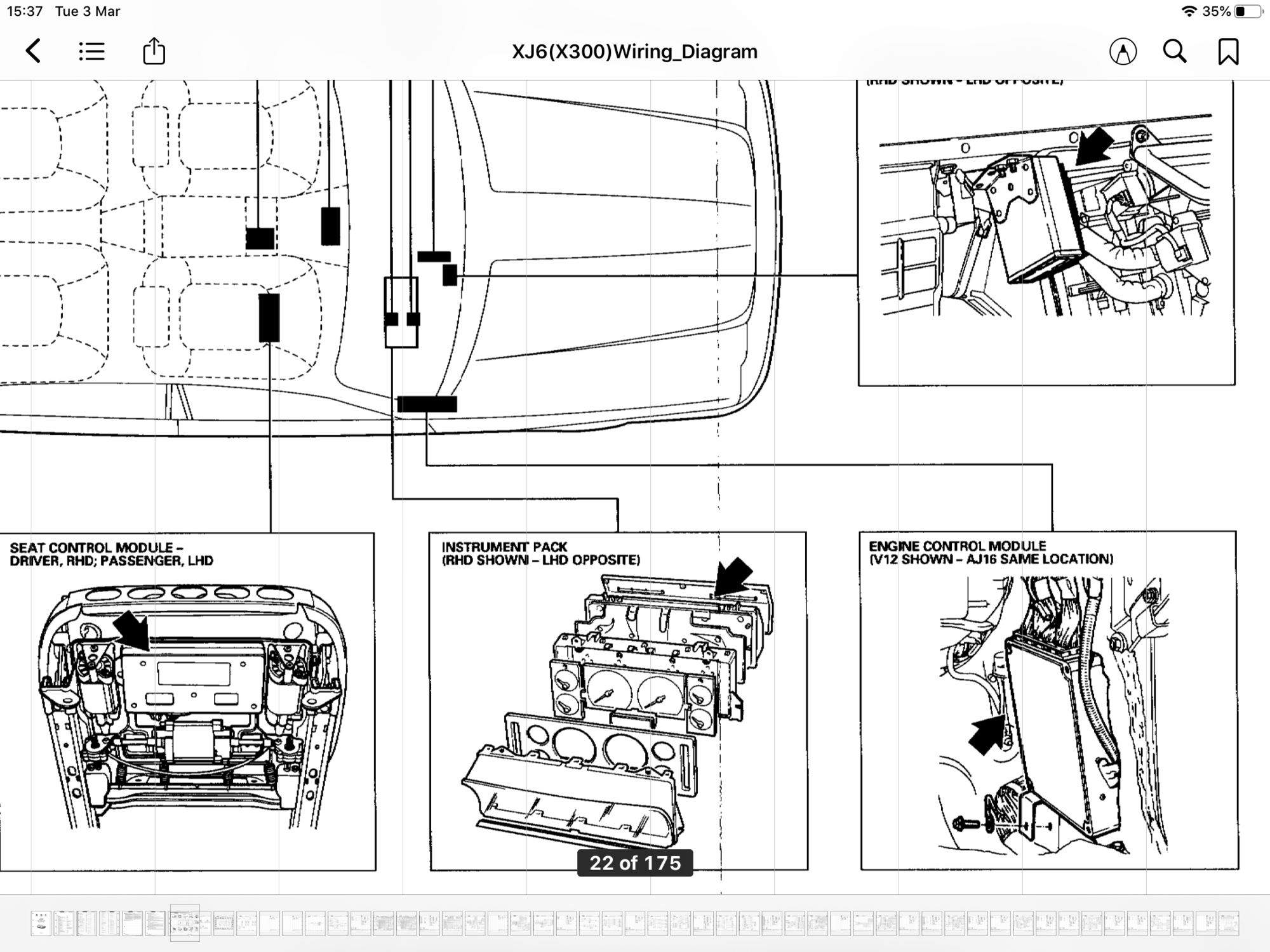

No. On the right hand side of the front passenger footwell behind the trim panel.
Old Mar 3, 2020 | 08:20 AM
  #42
Cafcpete's Avatar
Joined: Nov 2018
Posts: 526
Likes: 335
From: London, England
What country jag said.
That is looking up at the steering column, and shows the odb2 port.

I think I see were we crossed wires. By saying passenger side you thought we meant the transmission tunnel, when we meant inside the footwell by the passenger door.

This thread shows the location of the engine ECU, but of a RHD. That of a LHD is beside the driver’s footwell.
https://www.jaguarforums.com/forum/x...u-x300-118790/

Originally Posted by ARshj
Thanks do you mean to reprogram the new key it might then engine start.
No, the engine ECU doesn’t change sides, it is always on the right hand side. Others do swap, just not that one!

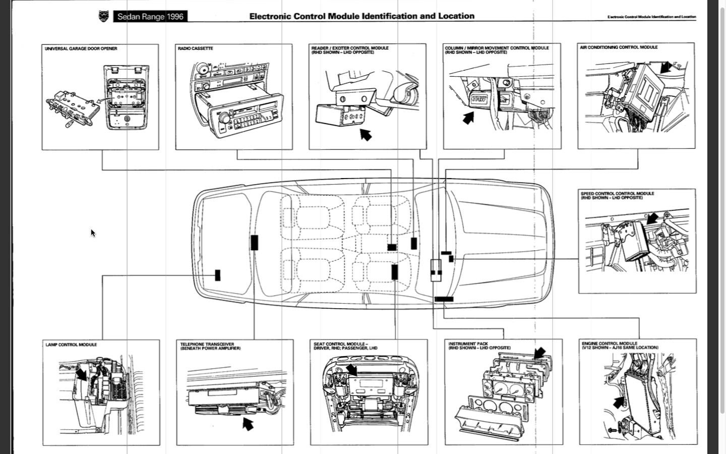

Mmmm does these two relate to that diagram?
Old Mar 3, 2020 | 10:06 AM
  #50
Cafcpete's Avatar
Joined: Nov 2018
Posts: 526
Likes: 335
Thats the lamp control module, in the boot.

The whole electrical manual can be found here
http://www.jagrepair.com/images/Auto.../jagxj1996.pdf
That is page 21

According to the 1996 tech guild for the LWB you security module alt to be in the boot.
http://www.jagrepair.com/images/Auto...1996%20LWB.pdf
Pg 21

Old Mar 3, 2020 | 10:32 AM
  #54
Cafcpete's Avatar
Joined: Nov 2018
Posts: 526
Likes: 335
Yep that is engine ECU, right hand side of car no matter which side has the steering wheel.

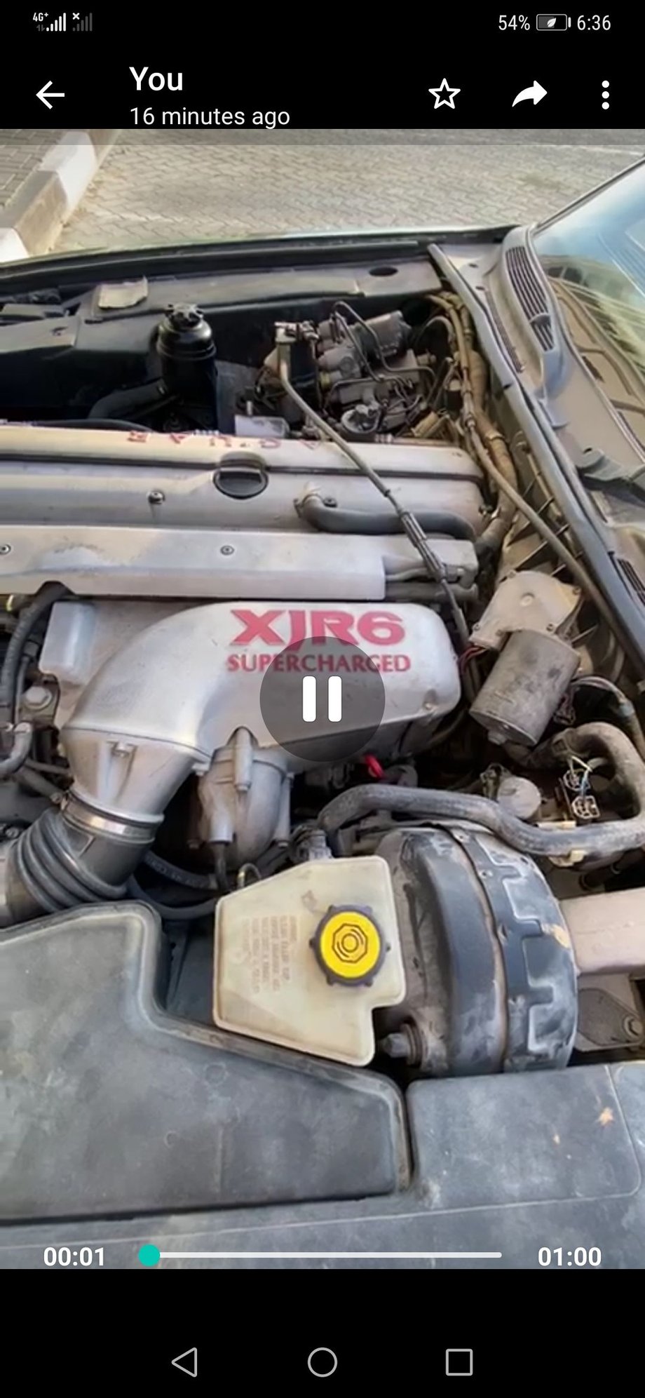

Here is a quick reference showing how many models are there in the X300 series and their differences.
https://jec.org.uk/models/x300-saloons
Simply put, the VDP usually refers to the X300 Long Wheel Base version with luxurious features. The VDP would be running on 4.0 engine or 6.0 V12, but not the 4.0 Supercharged.
The supercharged engine has an additional organ (the supercharger as you can see from your picture) which boosts something like 90 horsepower than the NA sibling. The supercharged X300 is not for someone who want a quiet and comfortable ride. It can roar and run very fast like supercars if you dare. The XJR has a 3.27 differential so can claim a higher top speed.
My impression is that the VDP you have is very expensive to restore, lack of parts and Jaguar expertise can be quite stressful and frustrating to a very motivated owner even if money is of no object.
The supercharged one if it still runs can be improved, but if you are after a limousine kind of car the XJR being short wheel base can be very cramp for the passengers at the rear. Given that Jaguar may be very rare in your country, if you come across an XJR, try running one and see if you like it if not it can easily her a new home.
An additional word of caution is the VDP and XJR are different in body length, suspension (hence ride height), engine, transmission (and gear ratios), traction control, etc. so there is a limit you can use one or the other as a parts car, or you end up losing two cars.
